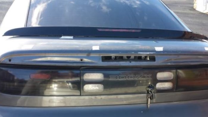

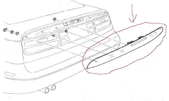

  3. It's not part of the spoiler. Just part of the boot structure. These 2 pics should help explain
  4. You mean the perspex strip? https://www.zcentre.co.uk/index.php/shop/300zx-z32-lighting/300zx-nissan-rear-perspex-strip-with-without-brakelight

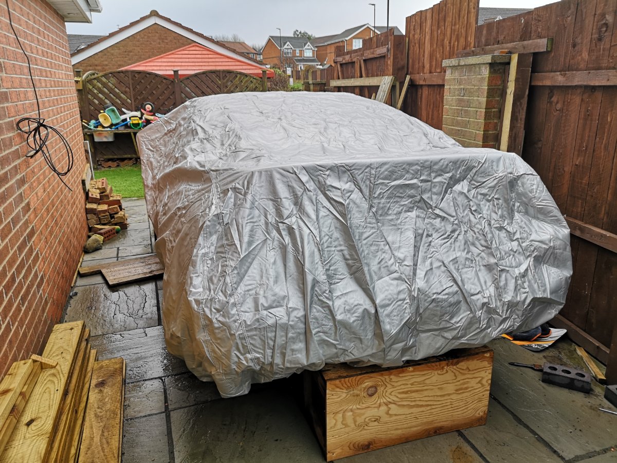

  9. Today I discovered that one of the targas doesn't seal properly and found a nice layer of ice on all the interior glass. Sorted that out, stuck in some dehumidifier boxes and a reusable dehumidifying pillow. Then placed the new cover over the top. Away to work tomorrow so this will keep any extra moisture out until I get back from sea in 3 weeks and can investigate more.

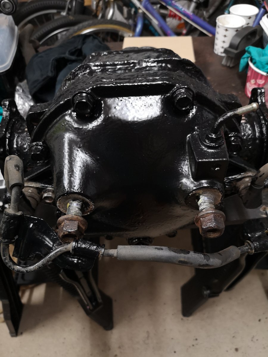

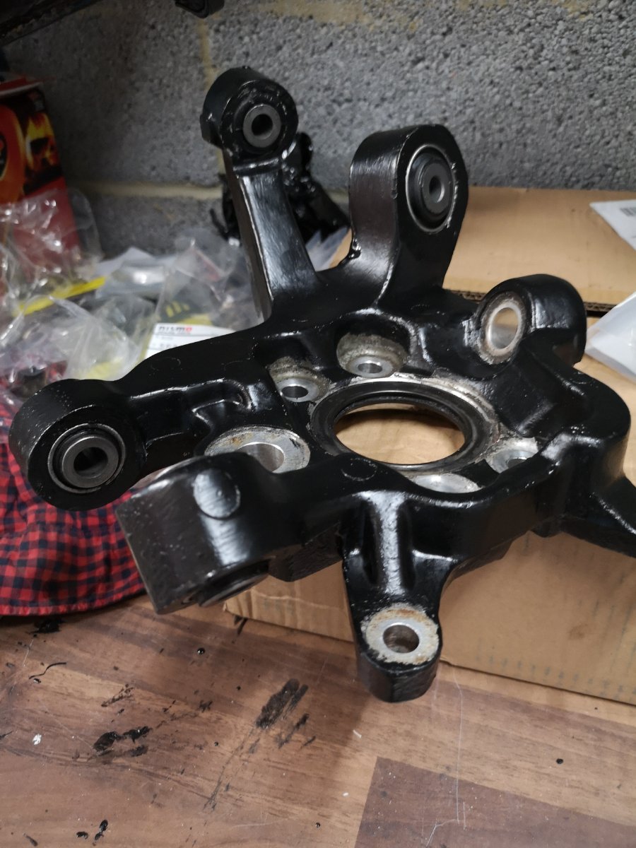

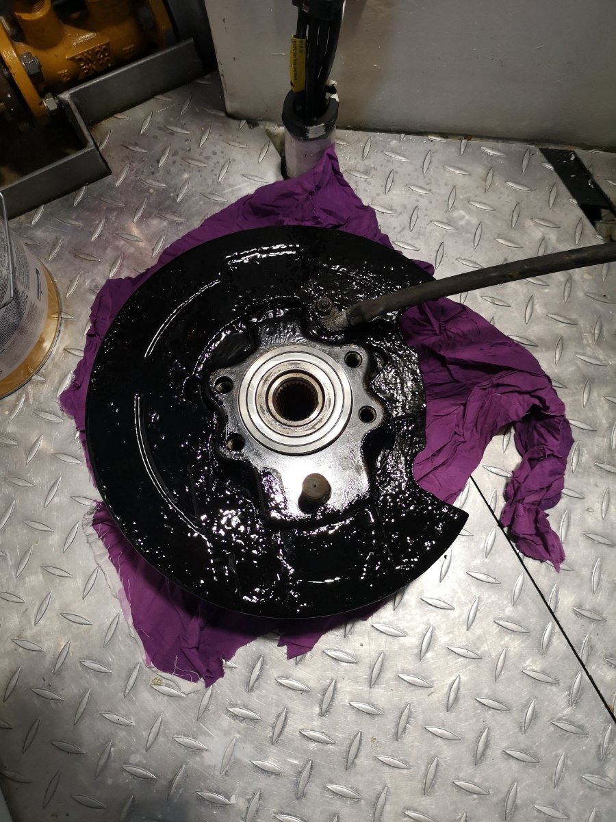

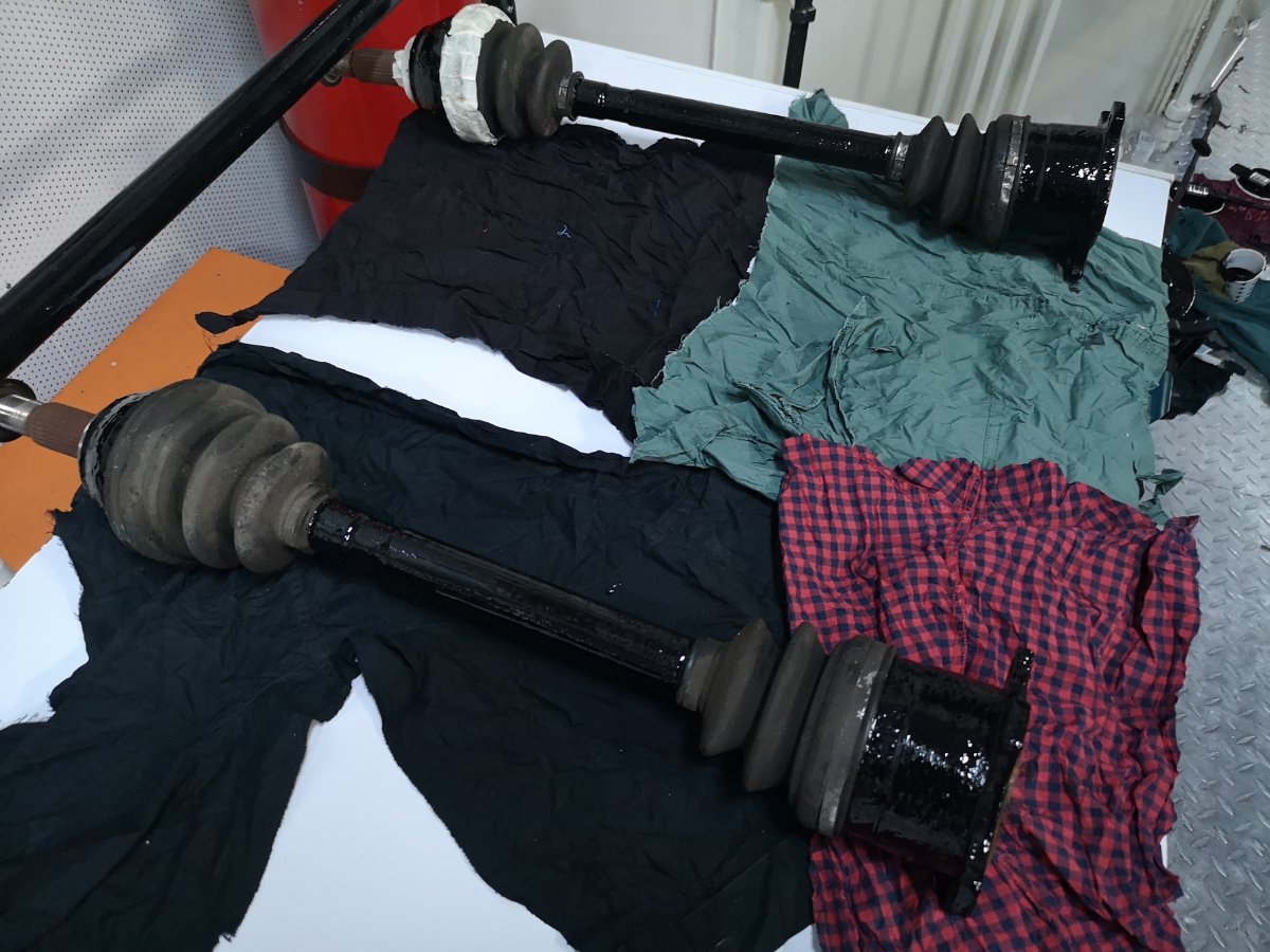

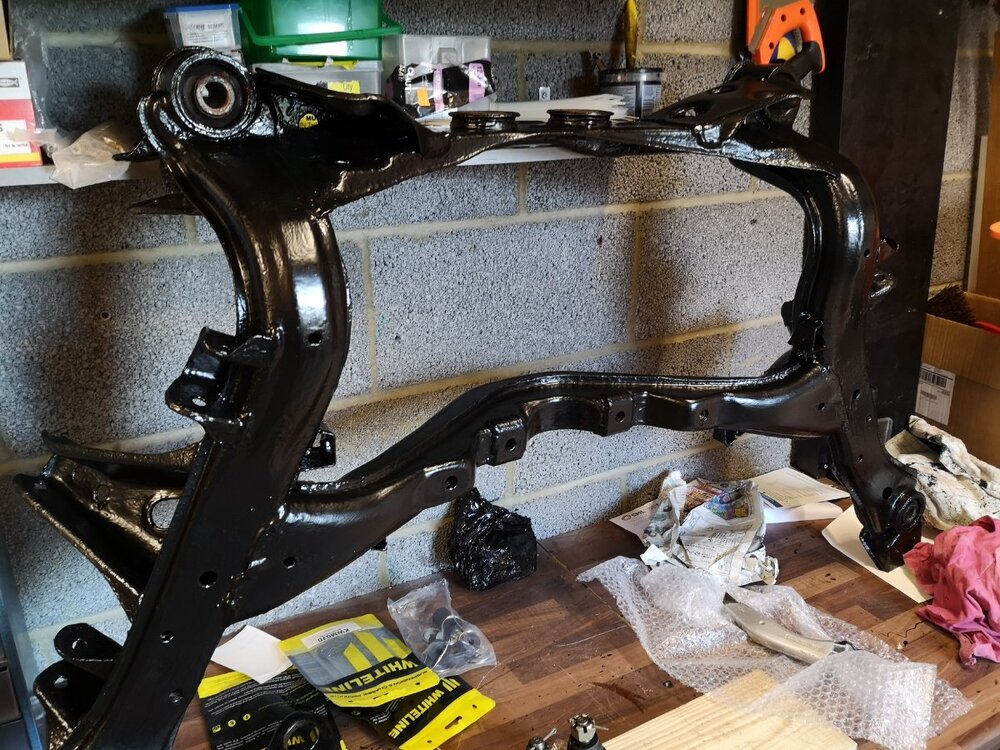

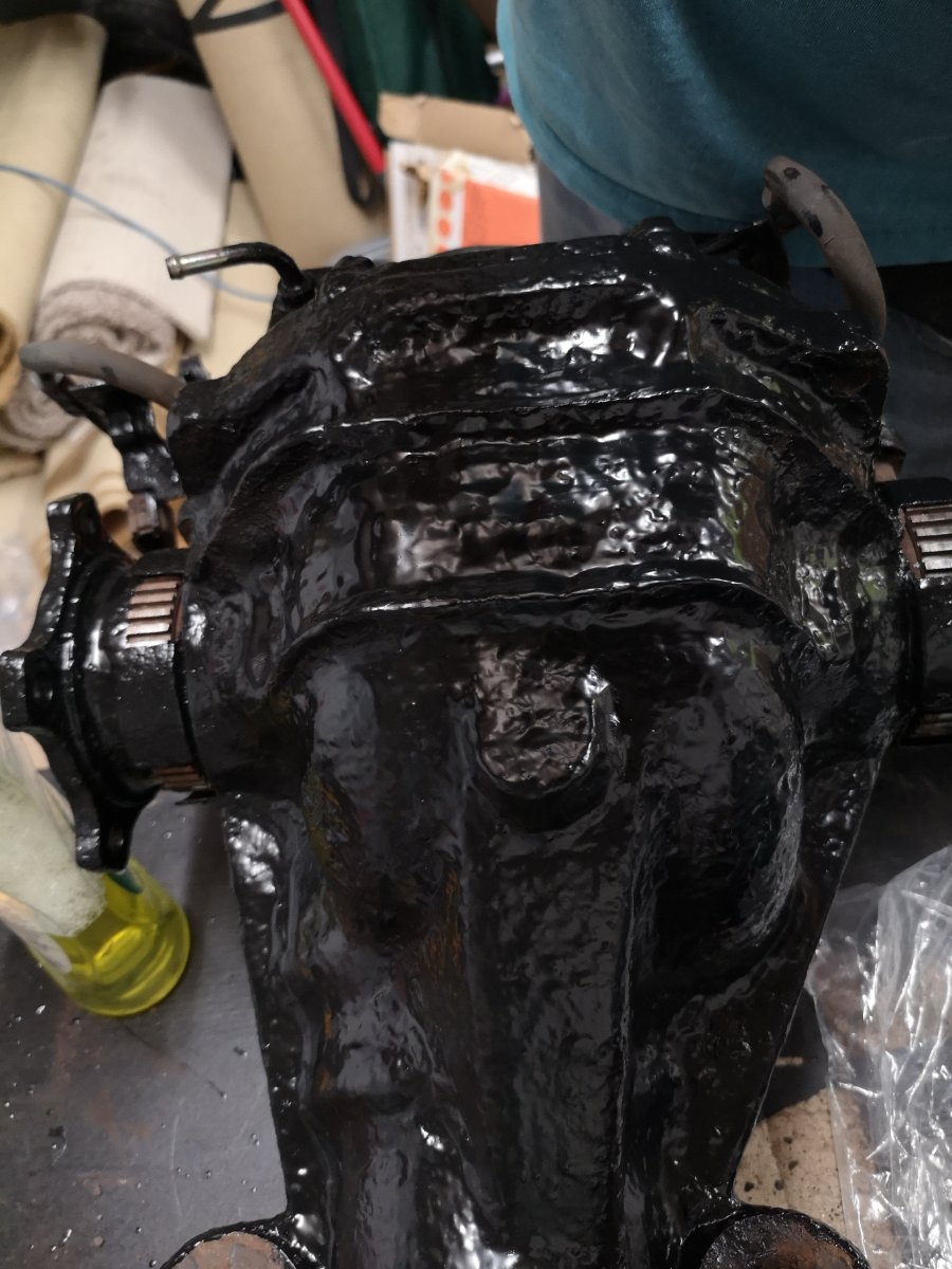

  19. Arms painted and dry, Nismo bushes in, hubs painted and Nismo bushes in. Differential painted. I need to replace brake lines on the chassis, and do some paint work above the subframe before putting everything back together.

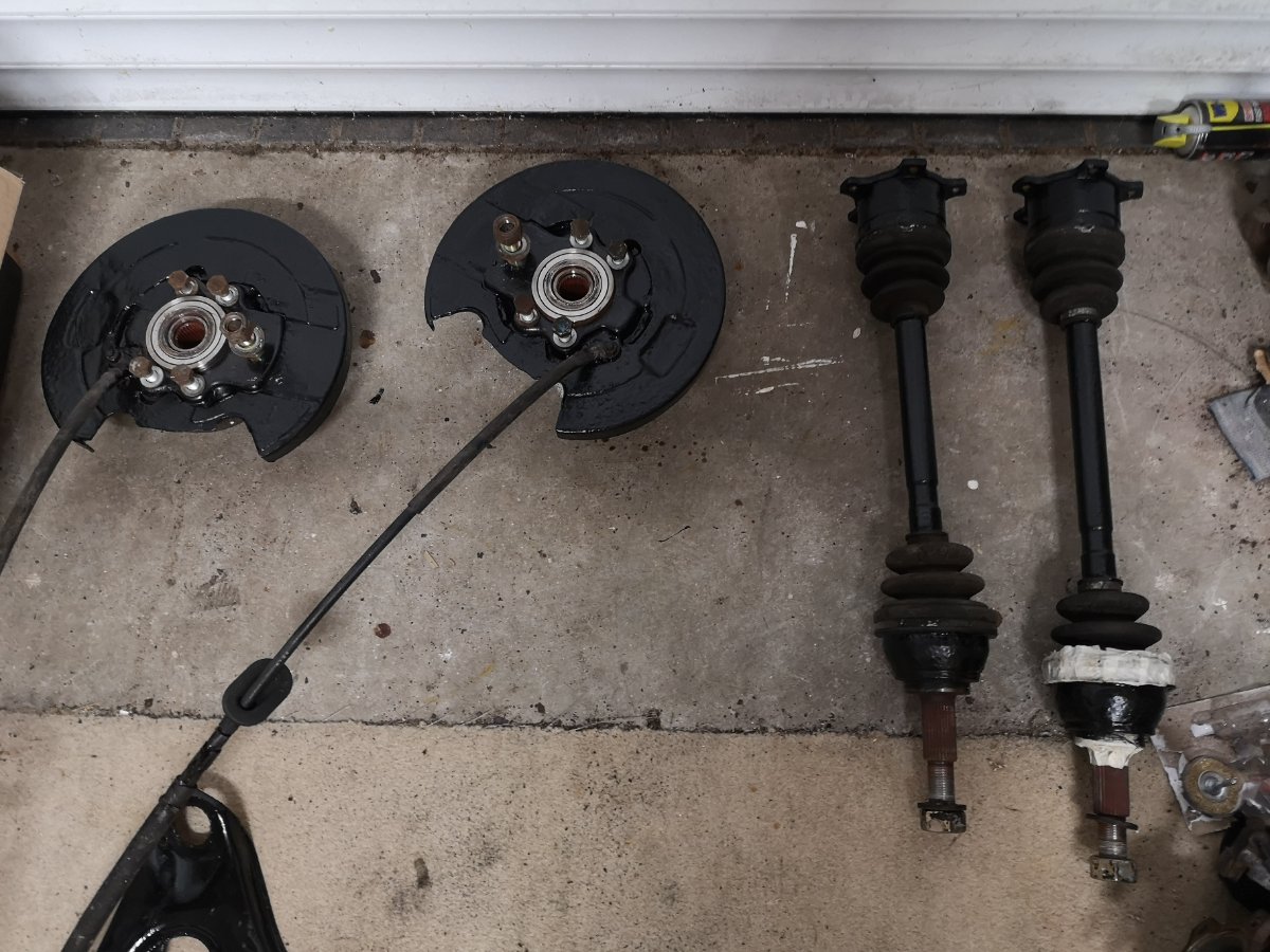

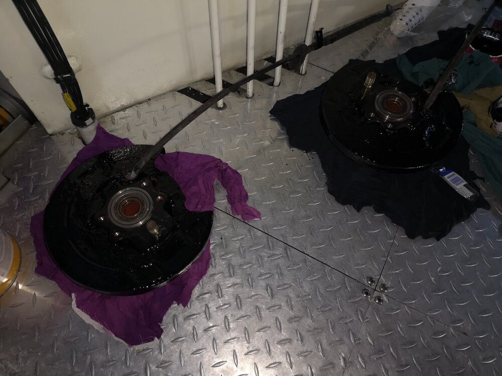

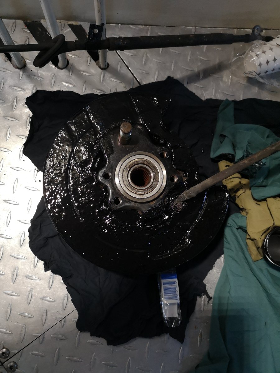

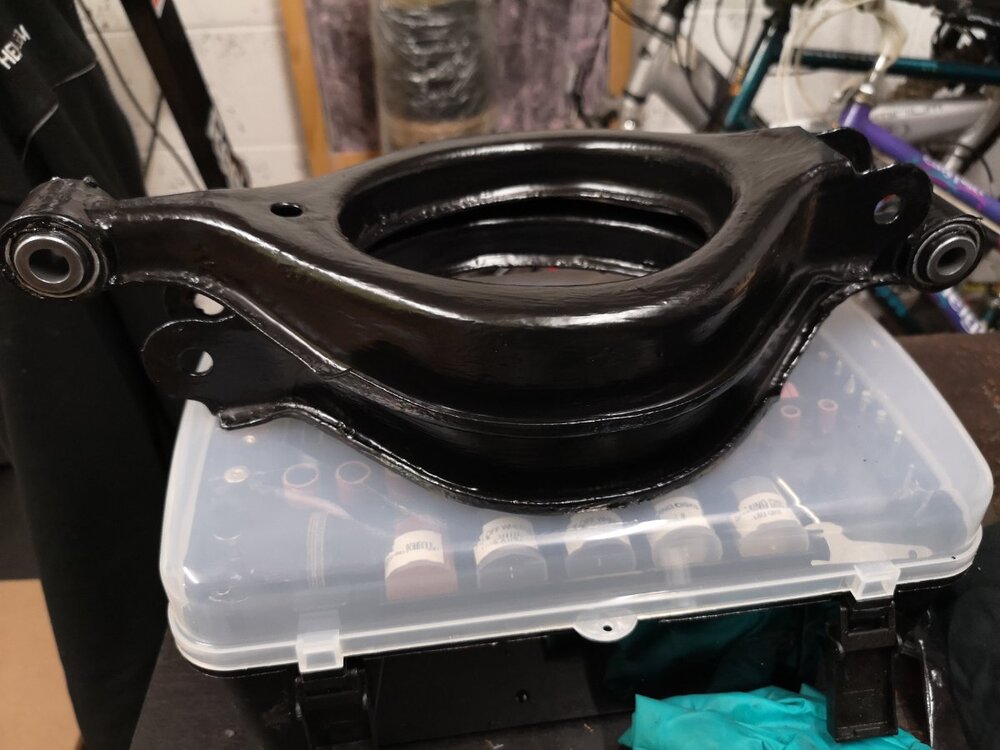

  20. My sea survival refresher didn't take as long as expected today, so I managed to get some paint onto the hubs tonight (note it's still wet in that pic. Will dry to a satin finish). I'm pleased I finally got these done as they took absolutely ages to clean off the heap of crappy underseal that someone had got all over them when they did the rear end and didn't mask anything.

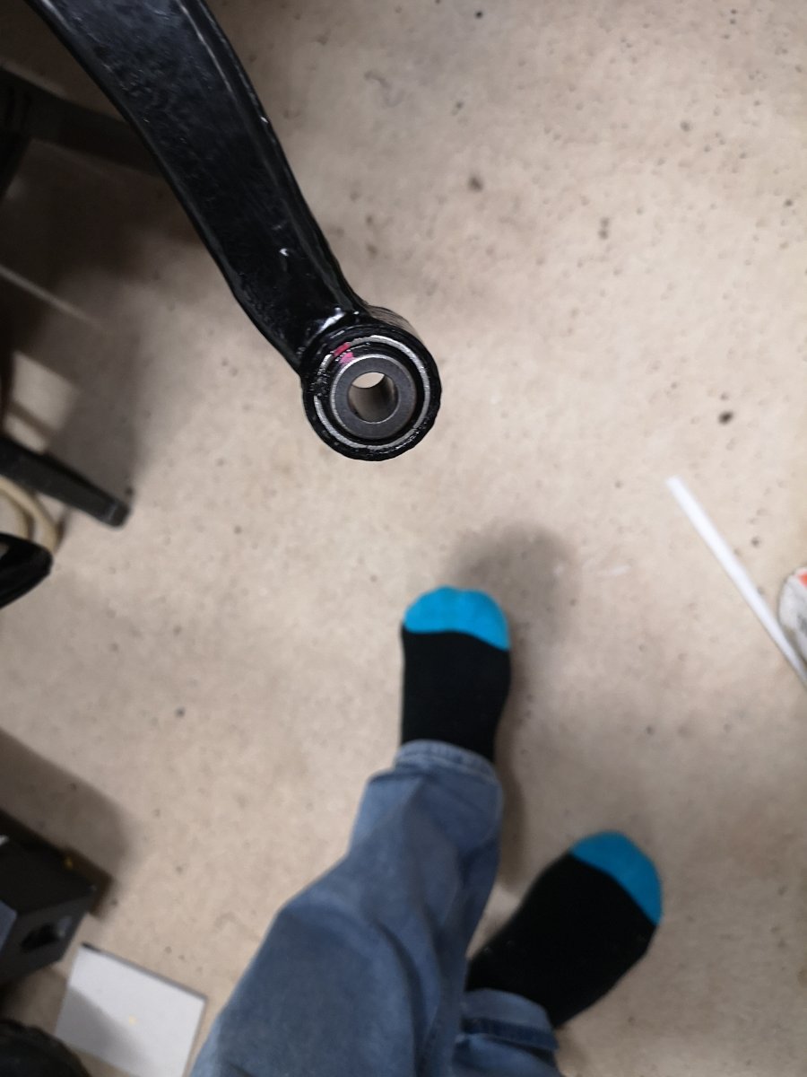

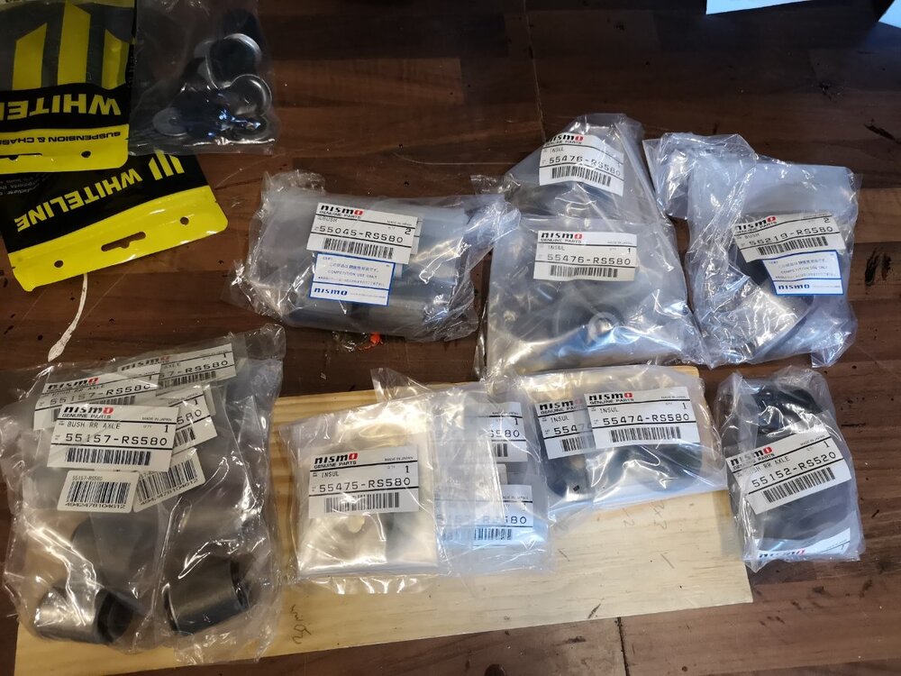

  21. Looks smart mate. Glad you got it all sorted. Also I'm pleased to see the pics as I was having a head scratch on which way up to install the lower shock Bush. That pic shows it perfectly! Give me a few more months and I'll catch up to you! ?

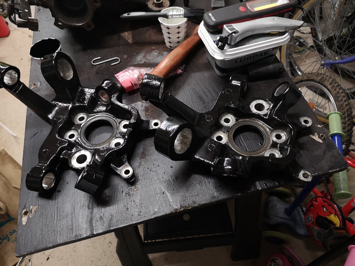

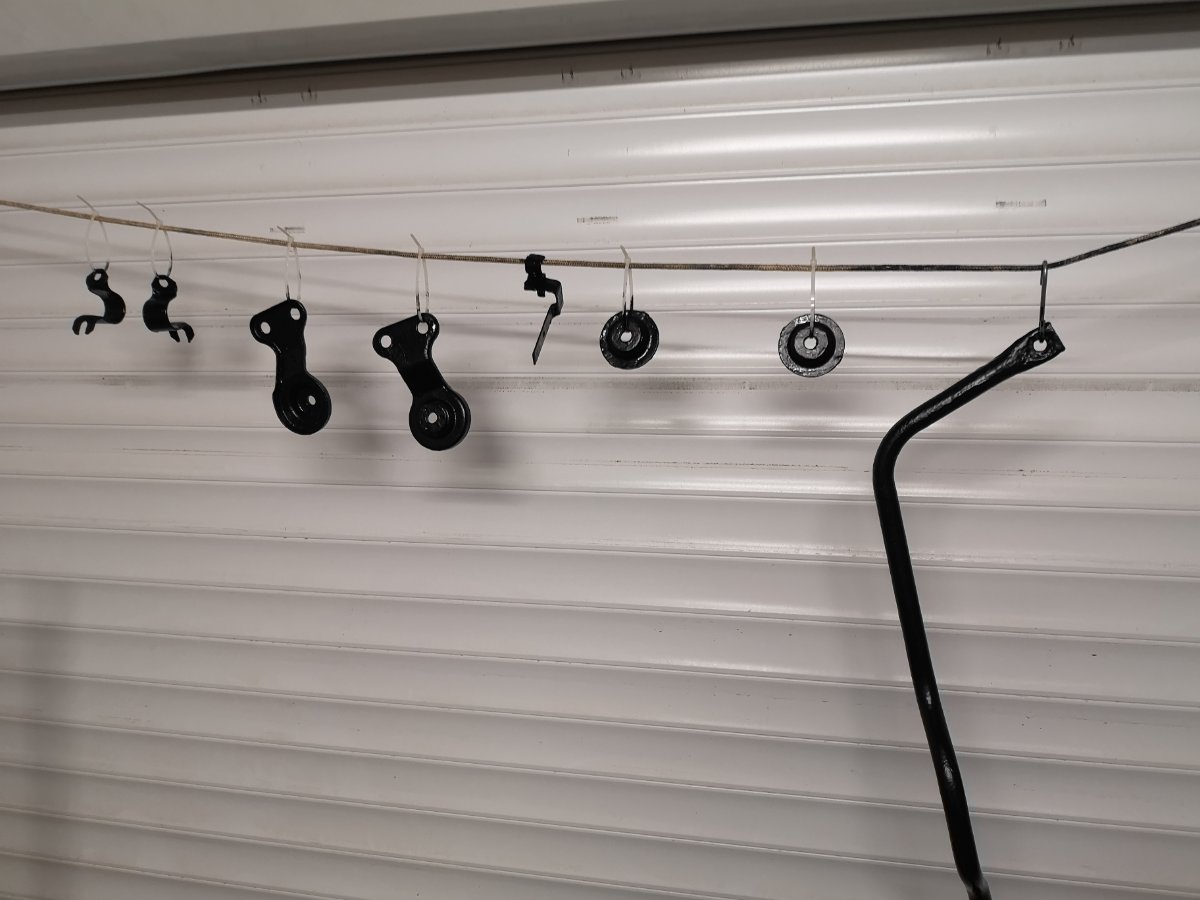

  22. Wife would kill me! They're brush painted bud. One of the reasons I chose Jotamastic 87 for the primer and Jotun Hardtop top coat. Can all be brushed on and as long as being careful shows the minimum of brush strokes anywhere. I don't have access or space for a spray set up unfortunately. I spend a significant amount of time at work painting large bits of boat with rollers and brushes so whilst it's a damn sight slower than spraying I'm pretty good at getting a decent finish.
  23. Couple of hours on it last night now that I'm home from work. I ended up going for a satin finish paint as it suited me more than anything that was full gloss. The Jotun topcoat I've used is also really easy to touch up should any of it get chipped in the future. Some new shiny bits arrived too Just got the 6 arms to topcoat, then press the new bushes in. Also the diff to finish painting. Then it's re assembly time.

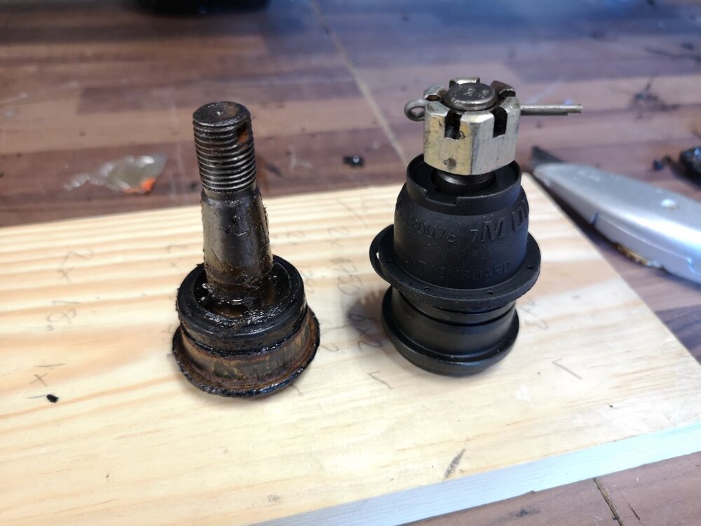

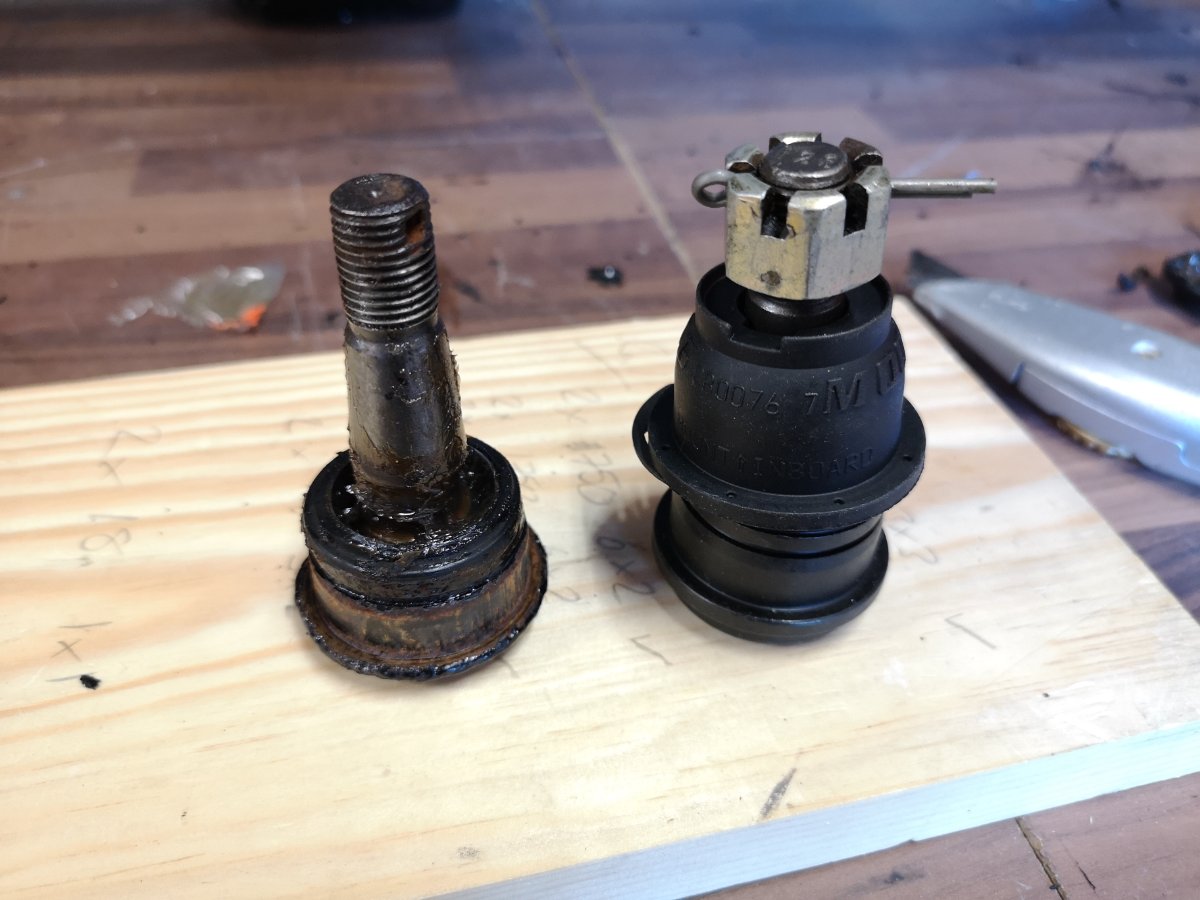

  24. Little bit more progress made past couple of days. Progress much slower than hoped as we've been busy at work the past few weeks. All these bits have now had the 2 coats of Jotamastic 87. They'll get 2 coats of Jotun Hardtop at the weekend. Still got a few stubborn bushes to remove from the suspension arms, but that should be sorted today and hopefully get at least 1 coat of primer on to all the arms over the weekend. Apologies for the shockingly poor photos. Mix of Nismo and whiteline bushes are all waiting for me at home. Along with new Moog ball joints for the rear end.

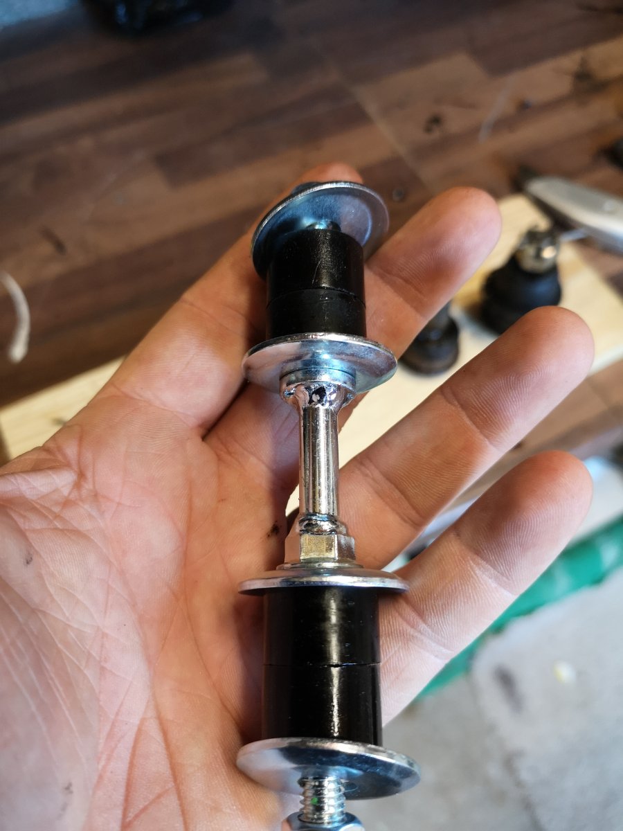

  25. https://www.onlinecarparts.co.uk/febi-bilstein-7107640.html I've just got these for rear drop links. I'm binning the bushes and washers and just using the rod itself with whiteline bushes and washers. Might be an option for you if you don't want to wait for another order from the US. These took 4 days delivery from Germany.
