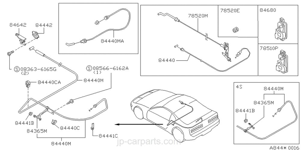

This may or may not help but is a point to ponder, I had a 1991 MX5 Eunos once and that had a similar opener switch to pop the fuel filler lid, in the same location, share or have similar parts ?
Part# 78822-46P00 (78520M) CABLE ASSEMBLY,GAS FILLER OPENER (showing as NLA in Japan)
https://jp-carparts.com/nissan/partlist.php?maker=nissan&type=132&cartype=31&fig=844  (CV is Convertible model in Note column)
Edited by AndrewG
Yes that is the details, all i could ever find was for the 2+0 or 2+2, the part i am after is 78520m  THANK YOU FOR THAT DIAGRAM ?
