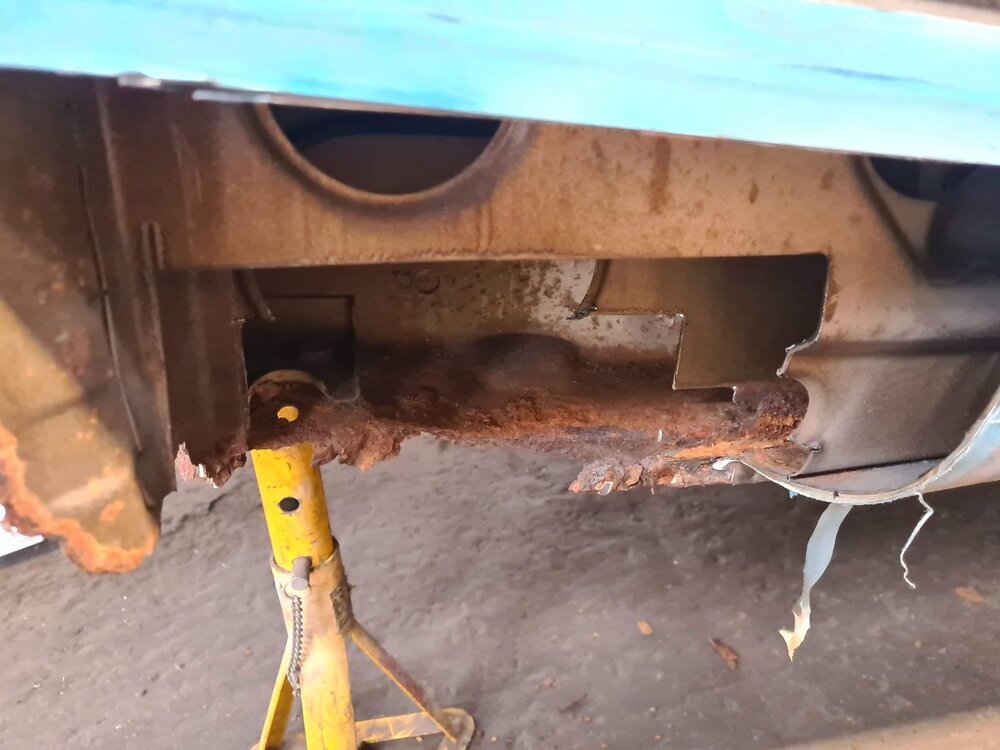

  5. You're in a good position then. For the lower rear quarters just get a good fabricator/welder to make then for you. The panels aren't available new, and any cuts you get from a donor are probably rubbish anyway. I've just had mine done and the fab guy just made new. I'll put pics below. For parts going forward there's UK suppliers like Luke at Zcentre, Torqen, AllCarPartsFast and similar. US you have CZP, Z1, Rock Auto, SpecialityZ, Zspec, BlasterZ. Japan has Greenline, Amayama, JPCarParts.

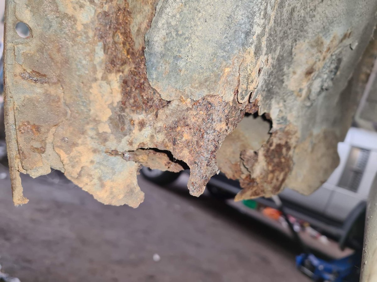

  22. More pictures of rust and then not rust. Ali is making steady progress with the welding. Going to get both wings sprayed after this as there's a few micro blisters I've decided to get sorted now rather than wait.

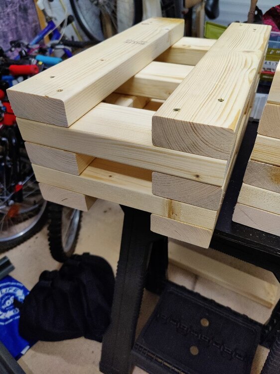

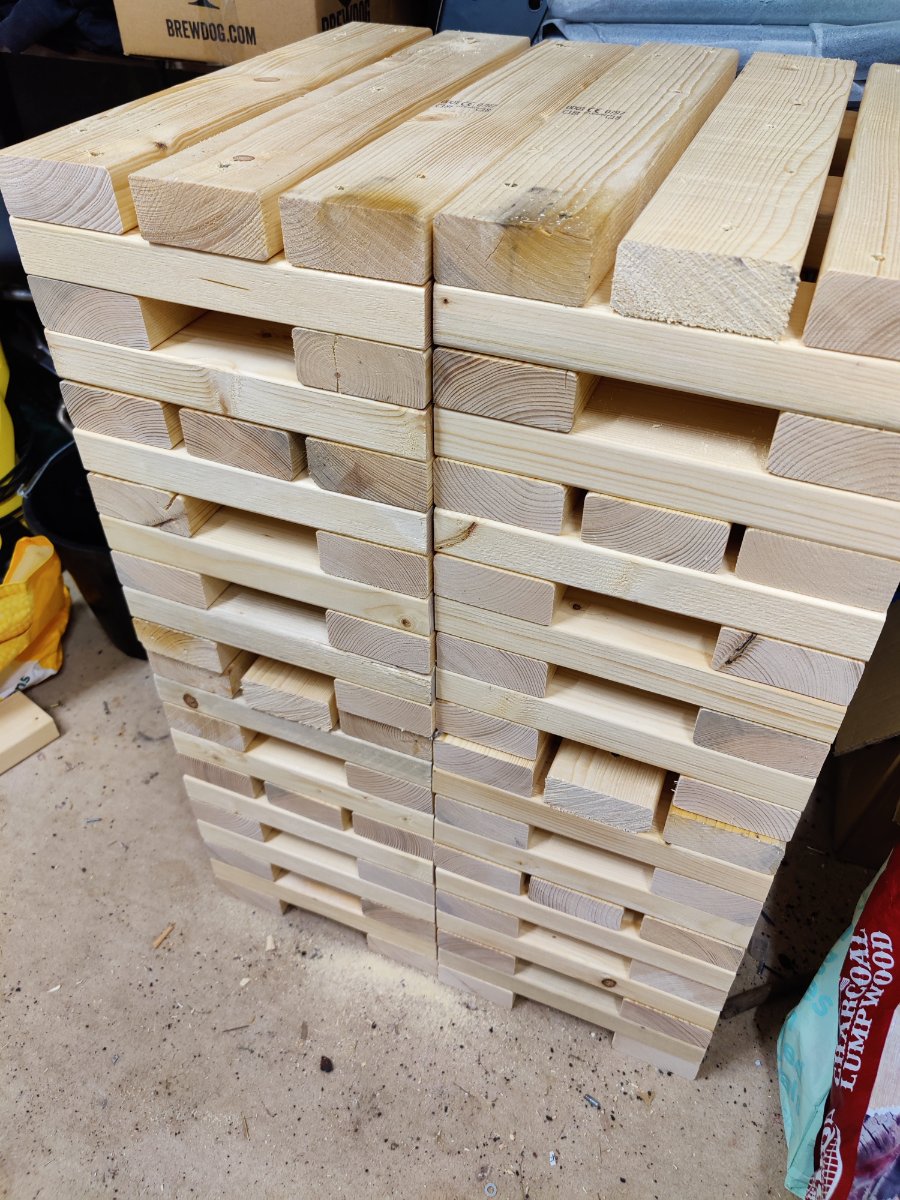

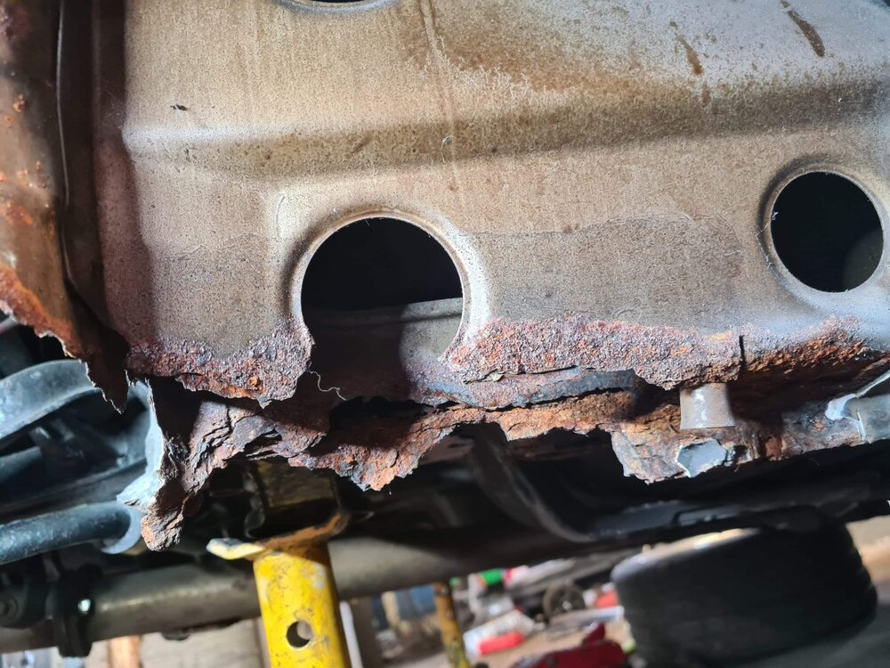

  24. Update time. Both sills are done and now in primer. Drivers side was worse, and had had a very crude repair done to it in the past on the outer sill without tackling the inner sill issues. Quarters have just been started on. I'll be hopefully getting the car back in about 5 weeks. So my attention is focused on what's next on the DIY list. New centre prop bearing rcvd and will be fitted. I've got used OEM tension rods and brackets which I'm currently cleaning and painting and will be fitting Nismo bushes into. I née to drop the exhaust again and get the car as high in the air as I can safely to start cleaning the underbody and then epoxy coating it. To this end I've spent a few hours or so knocking up a set of stackable wheel cribs. They're made from C26 timber and I've made them to be stackable. ie each crib can be 2 different heights means jacking up is possible in stages to get to the full height. Stacks fully interlock with no movement.
