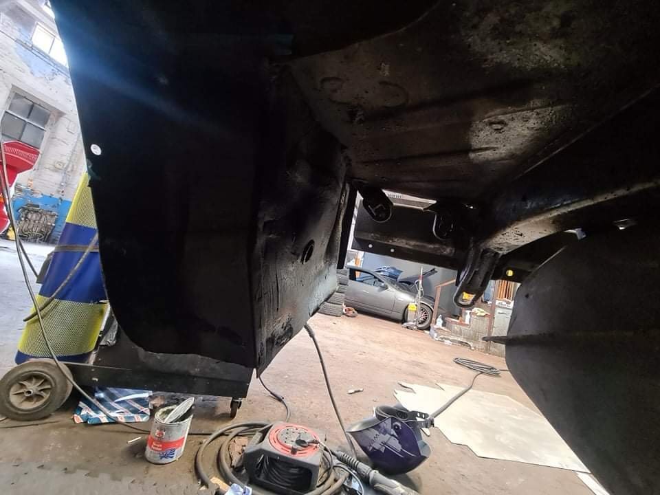

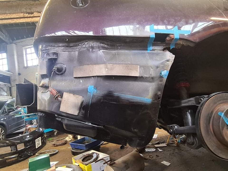

For the lower rear quarters just get a good fabricator/welder to make then for you. The panels aren't available new, and any cuts you get from a donor are probably rubbish anyway. I've just had mine done and the fab guy just made new. I'll put pics below.
