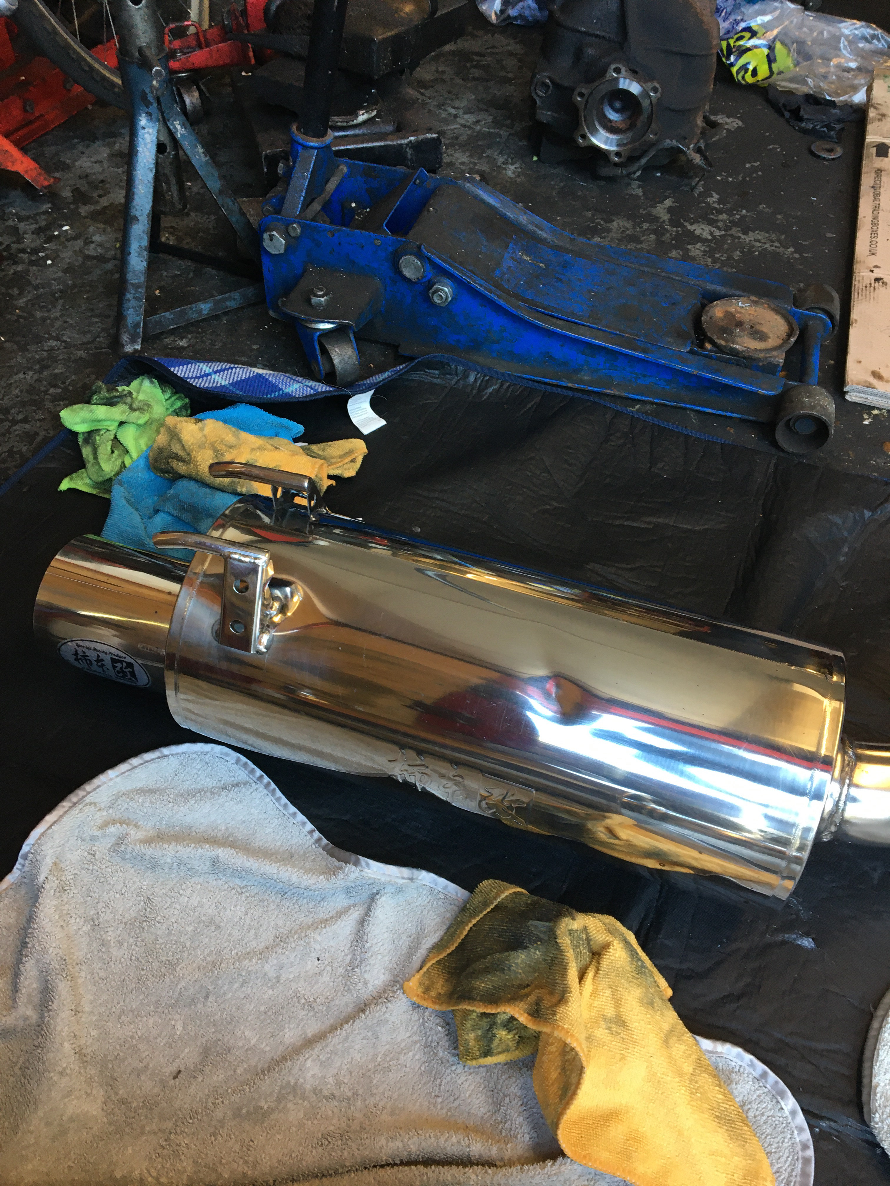

Today I removed the old targa wind deflectors which had sellotape and duct tape wrapped around them. Cleaned/waxed area under the deflectors as couldn’t reach this area when cleaning the targa channels a few weeks ago and fitted the replacement ones [emoji2]
I then went to town on polishing my kakimoto exhaust back boxs and all the welds. I’m going to do the rest of the complete exhaust system when the cars on the lift at the garage next week for the diff replacement. Looks a million times better. I cleaned with autoglym engine and machine cleaner then applied autosol metal polish. This took some graft but so worth it.

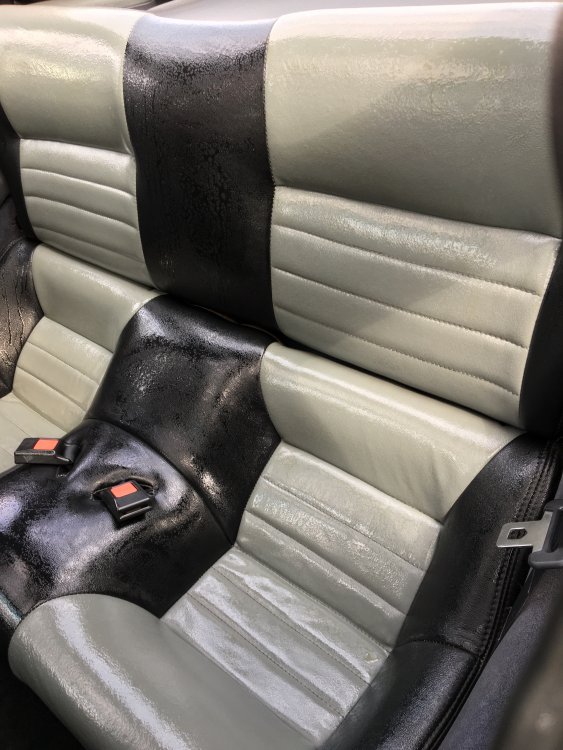

So over the last 3-4 days, I applied the best leather care product on the market - Leatherique rejuvenator oil.
Here’s the video link from where I learned how to use this stuff - very good and clear video;
You apply it to leather and massage in by cloth or hand - I prefer by hand as our z32 seats are very curvy so easier to apply by hand. The car should be left in the sun to allow the leather pores to expand, so the oil can get right in. I left it on the seats for 2.5 days and removed the targa sun shades to get max amount of sun in. What happens is the oil lifts the dirt to the surface, and you can tell this as the leather gets incredibly sticky. I reapplied more oil after a day as some areas became dry looking - the leather should look like it’s drenched in oil - see some photos below.
When it comes time to removal, you apply the Leatherique cleaner which can be sprayed on and left for a few minutes. Agitate the dirt which is in the creases and stitches.
After this, you need to have a half bucket of warm water per seat (change water after you’ve done one seat) Submerge the towel in the bucket and leave towel slightly wet but not dripping. Scrub the leather and you will instantly see the leather lighten up and all dirt removed. Finish off by buffing the leather lightly with a separate dry and soft microfibre.
This stuff is used and recommended by the Rolls Royce and Bentley owners clubs... the usual leather care products just add a shiny layer to leather, but healthy and good condition leather should be a Matt finish as you find in brand new cars. I find standard products do not prevent wear and gives you false sense of security, as they create a shine, fooling many people. The short term benefits of this product is it will stop any existing leather damage from getting any worse. The long term benefit is the leather gets softer and softer. Application is only needed twice a year. I’ve used this on 3 other cars with some cars having the entry level fake leather (bmw) and others (Lexus’s) having high quality real perforated leather, with the same results across all cars - a brand new leather Matt finish [emoji2].
I always buy from Motorgeek UK as they sell genuine stuff, and also supply with soft microfibres, brushes and application pads - I.e the full kit you need. This product is made in the USA and due to the high price, there are fake versions about, hence why I buy from motorgeek as I know they sell genuine only.
Any queries if you’re interested in using this stuff, just let me know. By the way I’m not endorsed by this company haha, I just love using and raving about excellent products.

Today I had the rear diff swapped out for the replacement one I bought from Banzai Breakers. Turned out to be a very good diff thankfully. It was caused by my buckled passenger rear wheel. Pictures of the diff which I painted at home last week is below.
Whilst the exhausts were removed, I cleaned the exhausts from mid section and back boxs, and applied autosol metal polish. It took me about 4.5 hours on my knees on a concrete floor. Safe to say I’m lying in bed in pain but the exhausts look heavenly so it’s all good! [emoji16] I mainly did it as whenever I’ve seen S/S exhausts need replacement/welding repairs, it’s generally because the welds have had dirt caked on for so long, then rust starts forming which in turn causes blows. Thankfully my exhausts weren’t heavily dirty but had a layer of dirt throughout. I polished it to an inch of its life. Only found light surface rust on a few of the flanges which I sanded and painted.
Not bad for 10-12 year old exhausts.

Should probably have added a before picture of the exhaust. Completely forgot to take any more!

Hi Gonzo,
It’s a Kakimoto racing exhaust. It’s been on the car for 10-12 years and still going strong. I’m sure I’ve seen them on CZP and Z1 websites. Sounds absolutely fantastic when flooring it. The welds on them and general quality is fantastic so highly recommended.

How does that leather cleaner work, those seats are painted leather with lacquer over them, which should basically be liquid proof other than at the stitching?
1 hour ago, Dazsw said:
Looking good mate.
A shame that buckled wheel has ruined a diff, but at least it's sorted.......I had those diff bushes fitted a while back, will be in the huge file somewhere lol.
Cheers mate. Oh I see - cheers for fitting decent bushes! They were in really good shape thankfully so all good to go back in.
Yeah the re-trimmed leather on this car is a lot like the cheap painted leather on my old Bmw E90 3 series m-sport I sold a couple years ago. It managed to do a good job on that car so assumed same of this car. The lacquer appears to have worn off on the rear middle grey sections as it was all super dry looking, so I massaged it right in. I massaged it in on the lines of the stitches too for all the seats. I thought I'd have difficulty on the rear outer black sections as they're really hard leather and probably still got a strong layer of lacquer on it as you say, but they still came out super clean and softer than before. The driver seat has a lot of cracks to the seat and back pads so the oil easily got in there too luckily.
