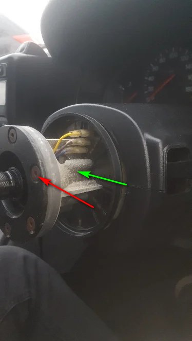

Please see pics for reference of my current setup with the dust cover removed, and the back of the wheel Ive just bought.
Any help on this would be much appreciated [emoji106]948d661c2c8396bc960a46daf3901530.jpgeb8450d3a652dc63d790200b98d13a73.jpg7dd3b15914be5a498ec1197c3c3d77b0.jpg91f974906d30cc67bc04b0db69aa66e1.jpg

No steering angle sensor on a non HICAS (ie not a TT) model.
The clock spring (slip ring) I would guess only serves the cruise control module as that's the only electrics on the steering wheel that need to pass through. I assume you car has cruise from factory? If not, then you don't need a clock spring.
In your images it looks like that huge metal chunk at the front is all aftermarket and can be removed revealing the threaded end of the steering shaft that you bolt your oem wheel too.
Unbolt the 6 allen key fixings around the boss (I've arrowed one of them in red) and remove boss. Looking down inside the cast aluminium adapter
you should then be able to see the original steering wheel nut at the bottom of the adapter (location arrowed in green). Unscrew the nut and remove
the adapter. You should then be able to see if the original slip ring is still there.
Thanks Andrew. If theres time tomorrow evening Im going to get it in the workshop and strip it down, Ill follow up with what I find.
Although when prizing the (already loose) column casing it appears as though its missing. Curious to inspect in there though. 8d0f0c493fc5814f5661a741fcd21642.jpg5b036a8c8f2760448a858ce43685c095.jpg
