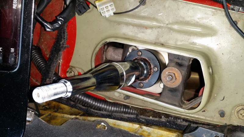

  12. Me and Emma went out in it. Saw a lot of beautiful Scotland, and it's awesome empty well maintained roads. May have seen full boost in 5th at one point too... :whistling: Comfortable, beautiful, monster :-)

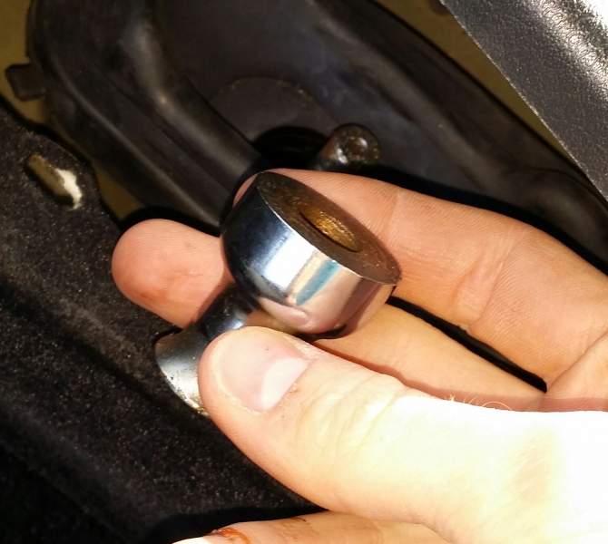

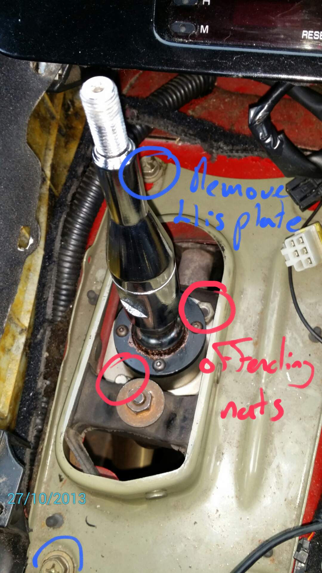

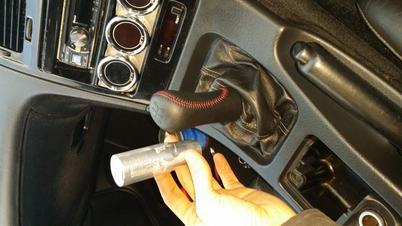

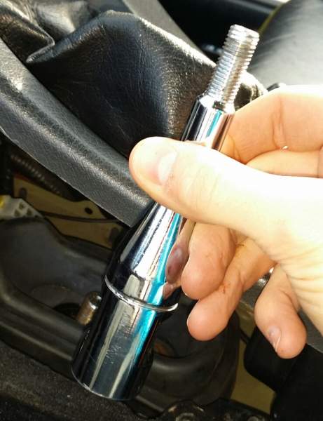

  13. I got them off deemontweeks. They were fairly pricey but I was furious at the 100 quid of rubbish I had warped. And I think they were 300 which was a lot less than the k sports or whatever I was considering.
  14. I got mtec discs and 30 quid brembo pads. These worked great for about 300 miles then were like poppadoms and wine gums. I now have black diamond and yellow stuff pads and they are great. Don't notice any warm up problems and they are just a bit more dusty than other pads.

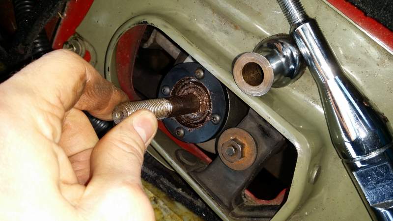

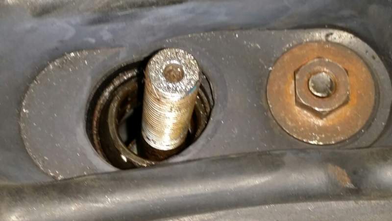

  15. Was chasing my tail and going nuts trying to work it out. No obvious fowling beneath. So took it all to bits, copper greased everything smoothed all the linkage movements a lot. Found the black ring that holds the ball bearing race and pivot down to be warped. A bit of slack freed up the shift as did a bit of slack on the shaft. But tighten both and 5th was a no go. I then saw ITEM TWO WAS UPSIDE DOWN. :headvswall: Inverting this with everything tight and newly greased and it's better than it ever was. Phew :-)

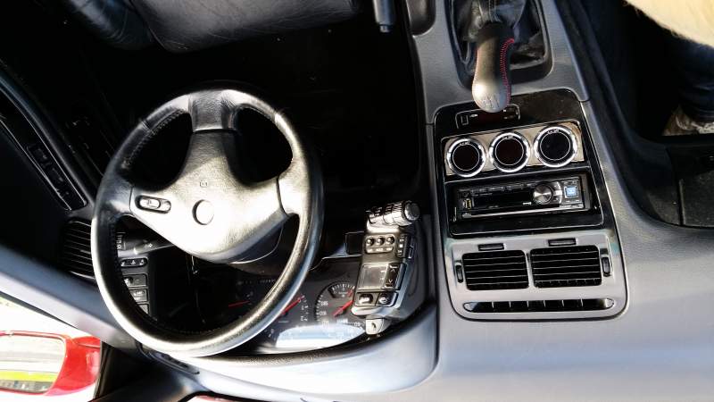

  16. Yeah thanks Mark, I'll have a go tomorrow and report back. Just to help people in the future ill add a bit more information... New knob The chewed up old one sat a good inch taller once on. This means that the leather knob has less leverage and the shift feels short and heavy. Also 5th and reverse don't really go in anymore. This must have always been a problem but the extra leverage masked it. Kev helped here by advising I try the old knob with it all exposed and the old successful shifting returned. Mark and I discussed this and he explained that the problem probably does not exist inside the short shifter unit itself as I thought. But rather is a clearance issue at the other end of those red circled bolts. On one side the 5th reverse side. I will remove the olive plate (blue circles) and have a look and an adjust tomorrow.
  17. Thanks Kev, kind of fixed it. It was a question of leverage with the new shorter knob. Can someone sell me a non short shifter kit please as it is rubbish!
  18. Rubber boot that should be under the rearmost nut and washer removed
  19. Someone please give me a ring 07585118109 I'm stuck in the middle of a car park at work.
  20. It can't have seated correctly then ill re attack it. Will copper grease do?
  21. Took the old impul one off to fit a z1 provided oem style jobber. The short shifter came with it so I took the centre console up and dismantled it all. After putting it all back together it only goes into first and not all the way. Item one Item two Item three So what have I done. Should the ball socket thing be greased in item one. Item one also was pulled up into the socket by item two and seemed to seat itself correctly. I think this is where the problem lies. Item three just the short shifter right? Everything was done up "pretty bloody tight" rather than "red in the face tight" as they were when I took it to bits. Thanks guys.
