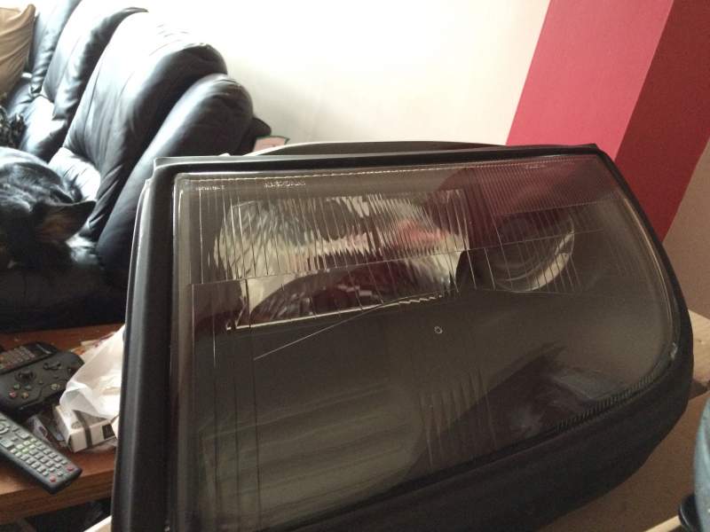

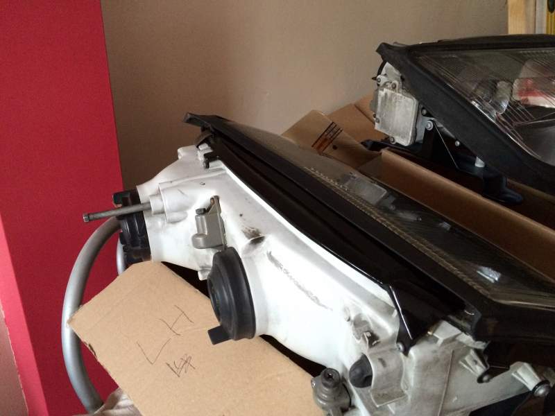

  2. I've had them back off this afternoon and checked them it seems the bottom edge and corner is slightly misshaped on one where the headlights had been dismantled before I bought them so after I had clipped/clamped them back together because I used butyl rubber sealer rather than the grey original it says slightly flexible so the gap reopened. just had the first one apart and applied some extra sealant across the bottom edge & corner and reheated it, it's now clamped up correctly and i'm going to run some silicone around the edge of the glass to make extra sure it's sealed. i'll look at the 2nd one tomorrow
  3. I've just refurbed my headlights, and i'm now beginning to notice moisture forming on the inside of the headlight glass while the lights are on. this disappears within a few hours after turning headlights off, I put extra silica gel bags inside the headlights along with the original silica tablets when I reassembled the lights. i'm thinking the worse and it could be the seal around the glass maybe? although I did make sure this was heated and a good amount of seal oozed to the glass edge. i'm running HID's but the problem is also there with standard h3c lamps in.

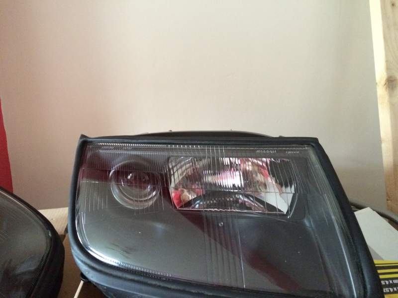

  15. and here is my little project for today finished, stripped the headlights back to bare casings several weeks ago, had the reflectors resilvered, cleaned all the internals, fitted the tamiya gears to the adjusters, and reassembled today, didn't use the original grey sealant though as it's gone manky & dirty looking so bought butyl rubber sealant which is used on modern headlight units. so all I'm all a very satisfying job to do, plus once fitted i should be able to see at night lol
  16. today i am rebuilding headlights, just had the reflectors back for my spare set resilvered, so today i replace the gears on the adjusters and build the units back up to go on the car, pics later!
