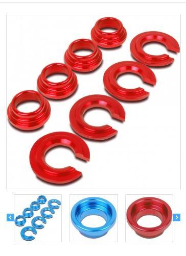

Locking collars are a good alternative to changing the subframe bushes and can be fitted literally in 30 minutes, they tighten up worn bushes and keep them located correctly when cornering etc. inexpensive and quick.......... ebay.
Jeff
A second for locking collars, I picked up a set for less than £20 on eBay and they made a great difference

I have locking collars too, whilst I will do a full subframe rebuilt at some point, the locking collars worked a treat.
