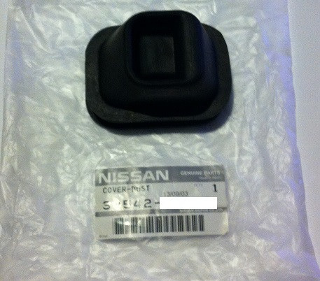

Take a quick look at this thread of mine from some years back: http://www.300zx.co.uk/forums/showthread.php?145251-Nice-clutch-tech-thread&highlight=clutch+fork the fork can rattle at the revs you mention if worm, even replacing the rubber shroud can stop it as the old one gets perished.

Ah very interesting, thanks for that! Is it possible to change the boot with the gearbox still in place? Can't exactly remember how it fits in right now
Yes just undo the two bolts holding the slave cylinder to the gearbox and you can pull the old one over the fork lever and refit a new one.

Sweet, cheers, will give it a go
Part Number: 30542-69F00
