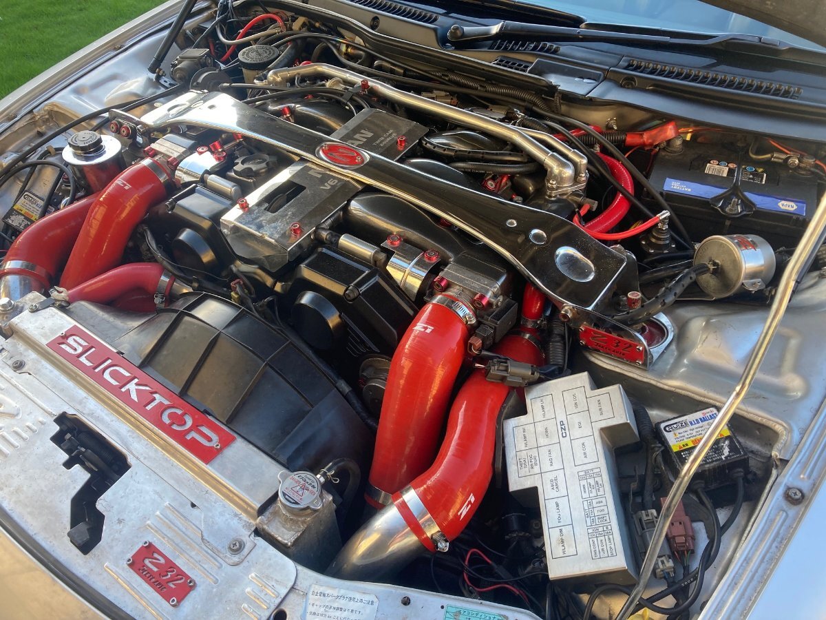

  13. An up to date engine bay pic, I've polished nothing and never will, a bit of red going on and some bits not to everybody's taste but this is how it's staying. There are some extra cables/vacuum hose put in, which await a Link G4 system, only thing left to do pretty much.
