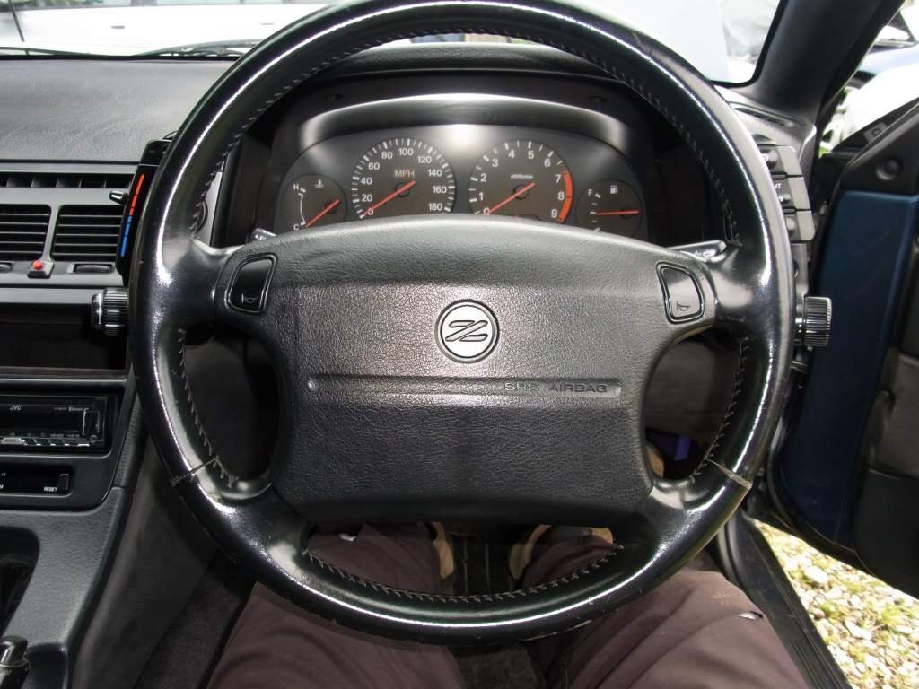

I wonder how many testers are aware of what year of Z32’s came out of the factory with an airbag equipped steering wheel?
Not many I would say so lets hope they can get the right info on the day. Mine has an after market wheel but its a 1993 model with no airbags.
I reinstated mine, took me several years because there are variations, but I got there in the end.
Bet many zed owners don’t know what year either ?.

Luckily mines an 89 and has the better non airbag early wheel anyway.
