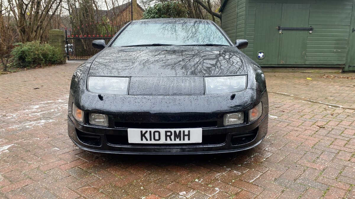

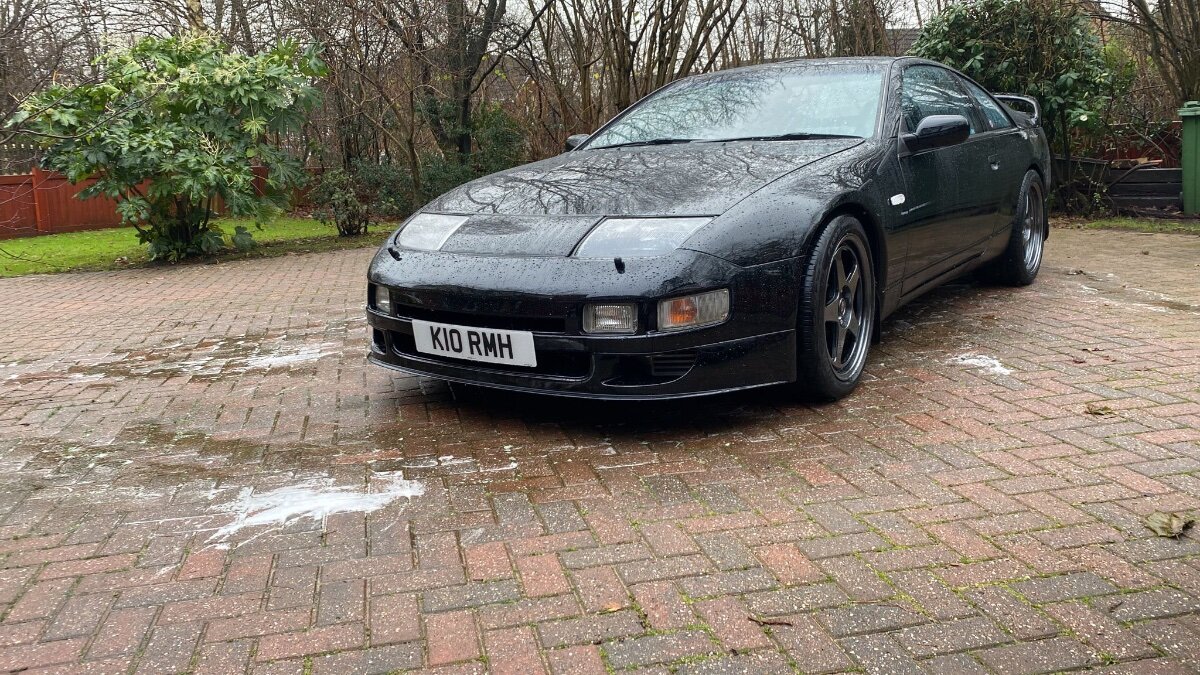

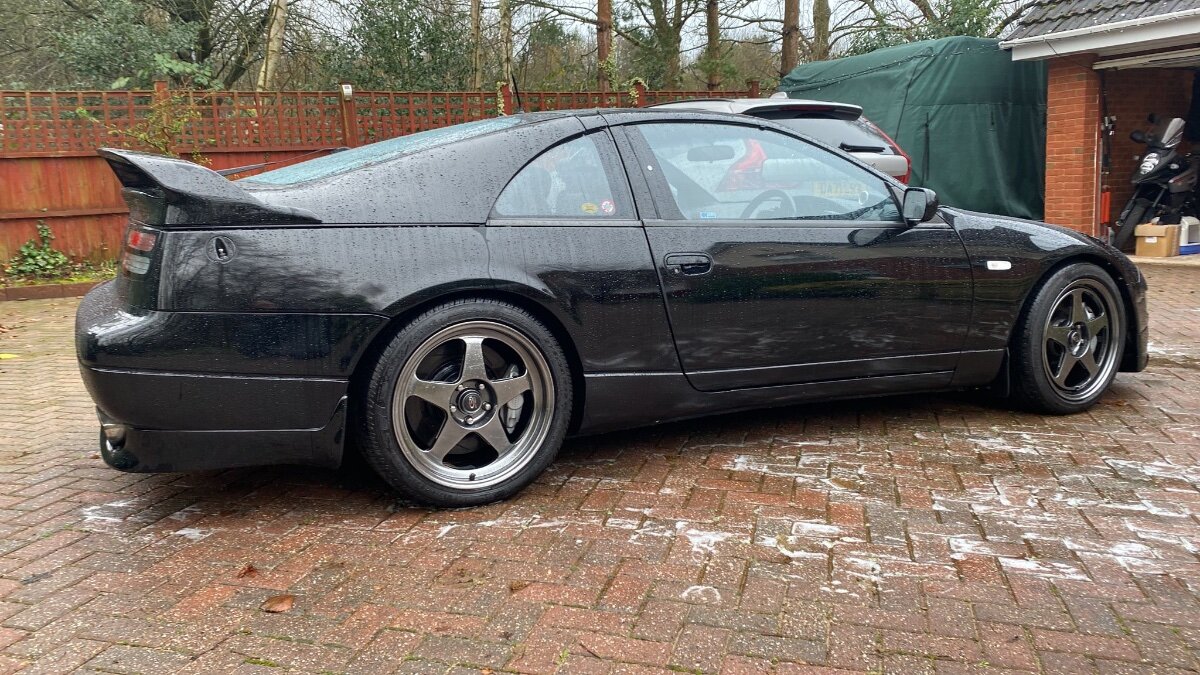

Well here she is finally finished after all these years and all down to one man jimmer aka powezed.
It’s been a long and expensive road but she’s finally finished.
After collecting the zed from Jim last month after stage two of engine mods..ie new JWT cams,springs,hydraulic lifters,Kevlar belt and BDE sprockets…on top of a full forged engine build already developing 530bhp
We then took it too Greg AKA Protuner for G4 LINK with traction control two maps low boost and high boost.. she made just over 600bhp at the hubs (around 660-670)bhp at the fly
Zed now runs sweet and she is truly a missile so massive thanks to the zed lord for all the work he has put into this car and Protuner for tuning one of the highest powered zed he has ever done
Ps keeping it in a straight line on full boost is definitely an art ?
