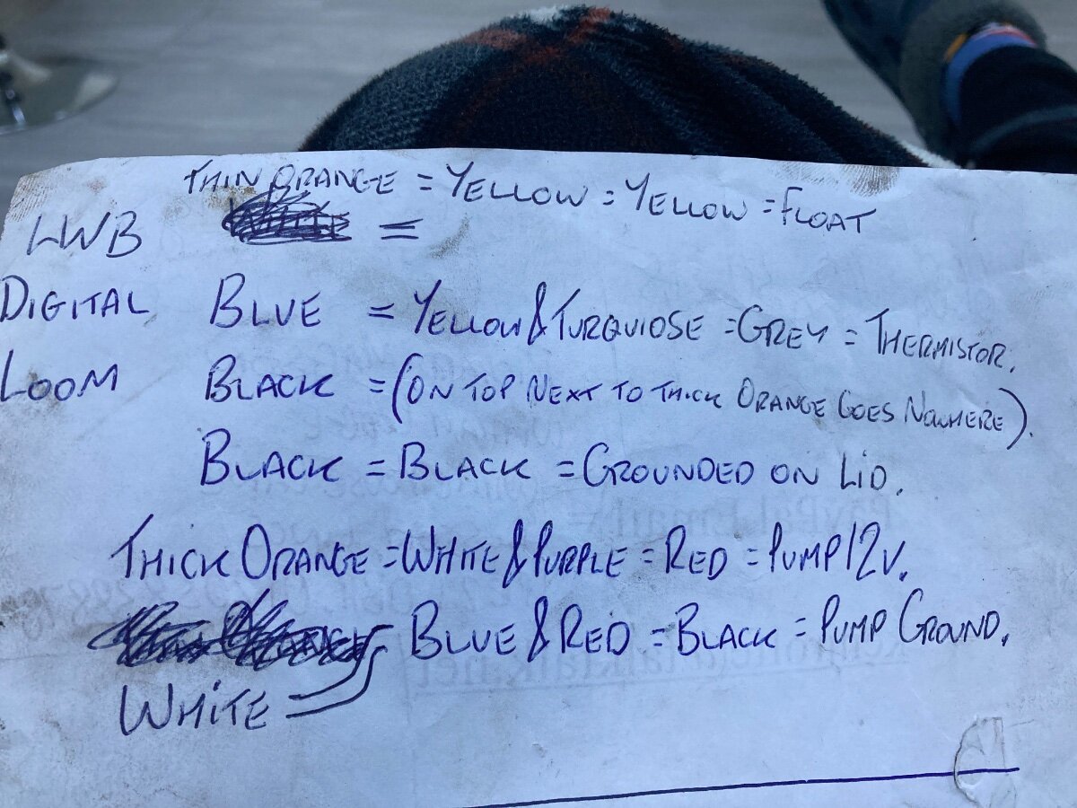

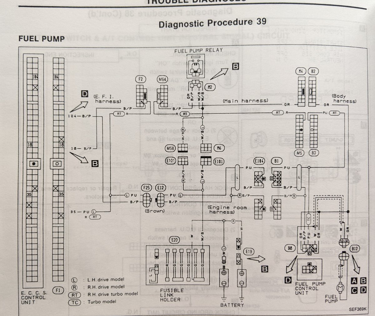

White and purple is pump positive.
Black is the pumps negative.
Well it is on my SWB pump assy here and I believe in the summer when I had a LWB pump in front of me, the wire colours were the same.
Some notes I made from a LWB loom fyi, it notes how the wire colours change along their journey !!
