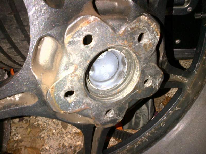

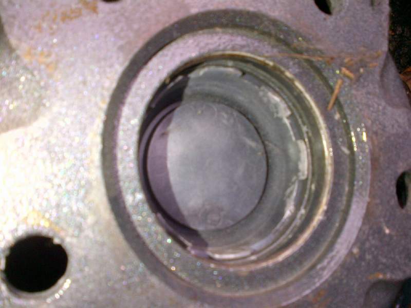

  7. Hi guys, So my new wheels are on and everything is pretty much perfect, apart from one thing I just noticed... When driving slowly (10mph) and turning left sharply there is a grinding noise coming form the rear left wheel... I can't put my finger on what it could be, the new wheels have plenty of clearance of the callipers and it doesn't happen turning right... Any thoughts? Hoping it isn't going to be something like the diff on it way out or something like that.... I imagine it is due to something that happens when the weight shifts rather than the angle of the front wheels as it definitely sounds like it is coming from the rear passenger side. Best. William.
  8. Wohoo all sorted! Thanks for teh advice - Got some heat on the rings and after a lot of work they finally moved. Smashed a couple of screw drivers in the process but worth it. Also Z32Bolt gave me some 5mm spacers for the fronts so she is sitting nicely! No funny vibration or pulling to the left. Happy days! :)
  9. Yeah if you are worried about it sitting still it is best to leave it be for 6 months which a battery trickle charge and then just replace the oil before taking it back on the road as starting it up every now and then only builds more condensation apparently.
  10. This is why I love you guys!... I have tried whacking it pretty damn hard but will get some heat on it!! :)
  11. I guess my quesiton being, do they make Alloy spigot rings which could have just been left in for years and now just don't want to budge?!
  12. Do you reckon they are just aftermarket spigots??? They seem as if they are part of the wheel, I have been at them with a hammer etc, and can't tell if they were just how the wheel was originally forged? - They are made of some kind of alloy as I took a screw driver and hammer to one and managed to cut through from one side to the other, but still didn't notice any signs of it being an aftermarket spigot?... That would make life easier though!! - I have a blow torch somewhere!
  13. Fixed?... Bottom pic has no spigot ring, top one does...
  14. argg Okay done some more investigating and it seems that 3 of the wheels has spigot rings forged as part of the wheel, and 1 of them doesnt (perhaps had it lathed off)... Sound like I will be heading down the metal fabricators shop Monday mornign and asking them to do some grinding for me. Putting a couple of photos up in case anyone can suggest anything else.. Shows the difference between the wheel which has a ring in place and one which doesnt. I just don't get why the wheels would come like that as standard... Best, W
