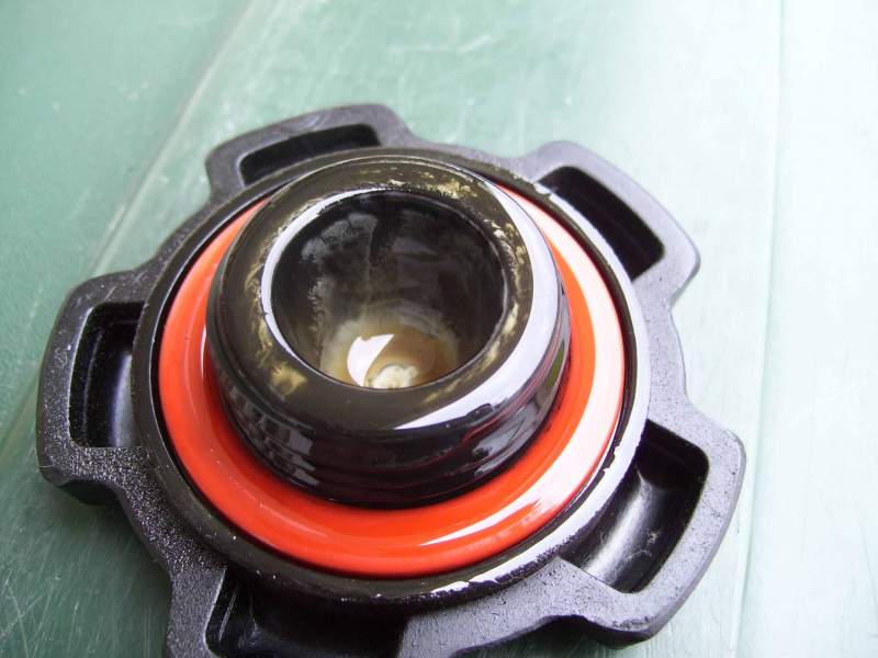

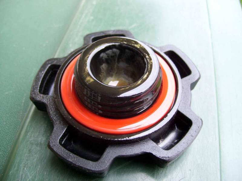

Thought I would run the car up for a little while as it has not been run for a few weeks.
After about 20 minutes or so I did the obligatory fluid checks etc'
On removal of the oil filler cap I noticed what can only be described as a milky white deposit on the underside of the cap.
Is this normal due to the fact that she has been standing?

condensation bud...normal iff its been running not up to temp a couple of times
just to be safe keep an eye on that ... all so just check your Rad water is not Oil stained as well
My mrs car does this as she never drives it more than a mile. I wouldn't worry too much, will likely clear after a run.
My thoughts too; as Znut says, it's most likely condensation.....
....But if you want peace of mind, like Mark suggests, check your coolant for oil traces as well. If the car is not overheating or losing fluids, there's nothing to worry about!! Just clean the oil-cap and drive your ZX over a few longer journeys!!
Richard:cool:

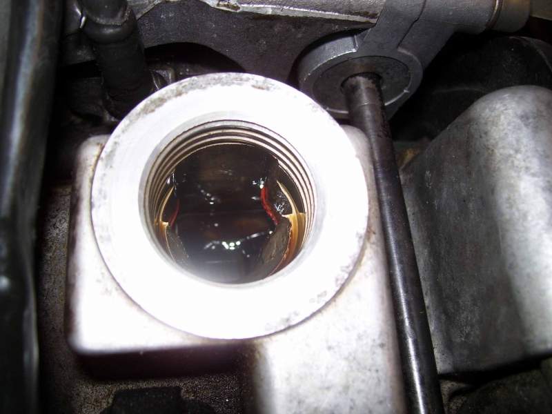

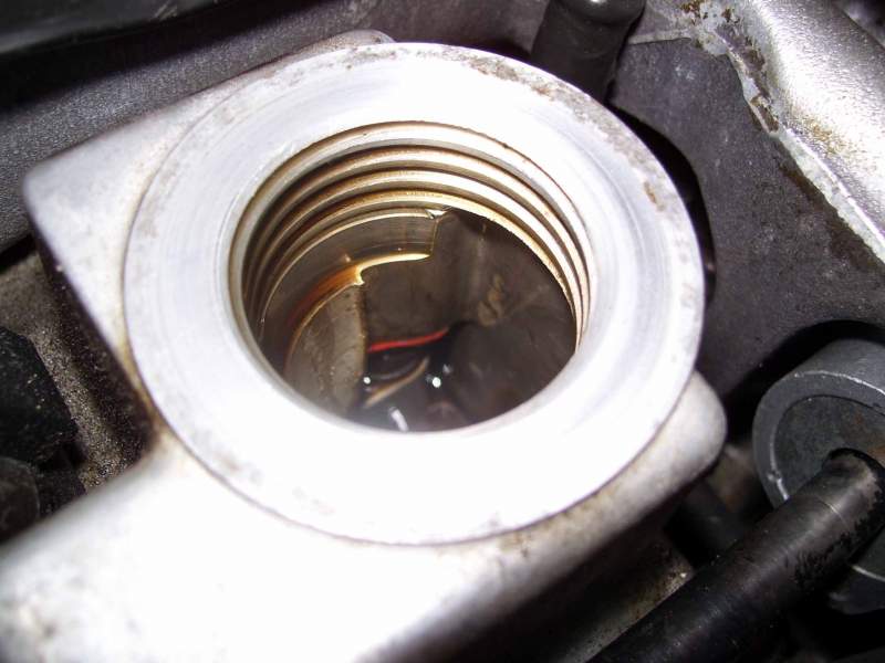

Also, thought I would take a couple of photos inside the filler neck as well. looks like the milky stuff is just confined to the cap.

Best get a new cap then,you`d be suprised at where water/condenstation can get to
leaving it running longer will not clear the water contamination as a result of condesatation...it wants a good 20 mile plus run to clear the sump. The filler cap should not be pushing oil through a crack on idle as the sump and covers should be in vacume..check your PCV valves arnt "gummed" up
Agreed you have to drive it, get it properly warm and under load, you shouldn't let your engine warm up sat still anyways it isn't the best for it. Is it road legal ATM?
leaving it running longer will not clear the water contamination as a result of condensation...it wants a good 20 mile plus run to clear the sump. The filler cap should not be pushing oil through a crack on idle as the sump and covers should be in vacuum..check your PCV valves arnt "gummed" up
