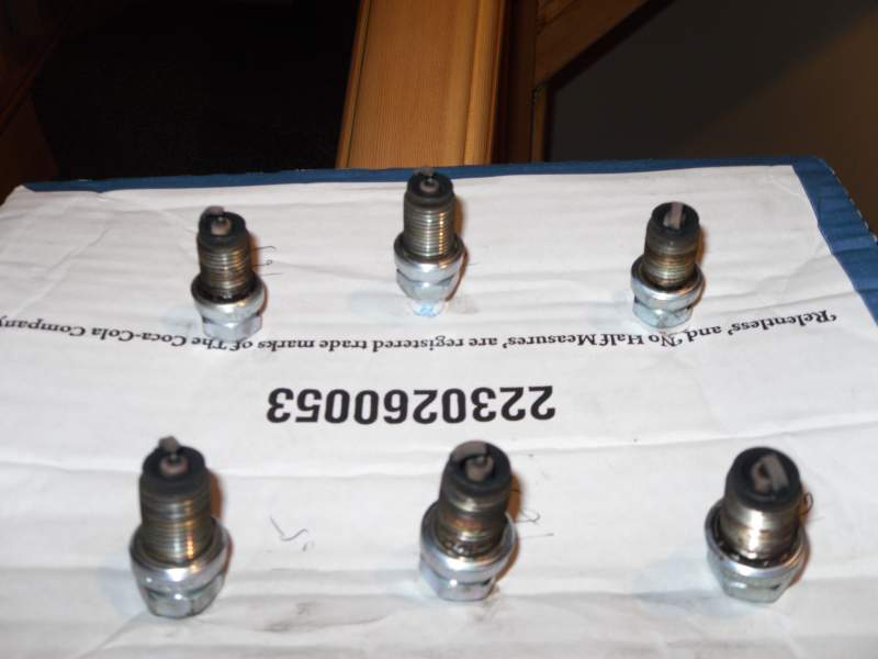

  19. Attached a photo of the plugs I removed from my car today. How do they look to a trained eye? Cheers.

  21. So, Decided to change the spark plugs and also do a compression test at the same time. Plugs have been in there for 6 years or so, wanted to freshen them up. Compression test I wanted to do as I plan future power upgrades, and wanted to check the condition of the engine. Initially all went ok except for the coil pack wiring connectors being very brittle, going to change them as they were already missing bits before I touched them. Balance bar off no problems, plugs all out easy. Compression test, all cylinders hovering around the 165 mark so pretty good for a 20 year old block. New plugs are BKR7E-IX, I didn't regap them (they came pre-gapped at 0.8mm, standard plugs were 1.1mm) and I think this is where I may have come unstuck though not 100% on that. Put new plugs in, coil packs all on, balance bar back on, started car, seemed fine, gave it a rev then let it tick over, nothing seemed amiss. Then realised I hadn't put on of the bolts for the coil pack which was under the balance bar on the passenger side. So took the balance bar back off, then went to put the bolt in, dropped it, and it's now nestling somewhere in the engine bay. So thought ok will just fire it back together again minus the bolt, coil pack seemed solid enough. Next time I start the car it is noticeably running different, getting dark so thought I better just st5ick car back in the garage then have another look tomorrow. Trying to get the car to the garage was awkward, sounded like a Scooby, and wasn't running well at all. So, I'm not sure if I have made an error when I removed the last coil pack and balance bar to put the bolt in, or whether the spark plug gap has started causing a problem. Can any you guys offer me some advice on what to check for tomorrow? Feeling slightly nervous, don't want wreck my engine!
