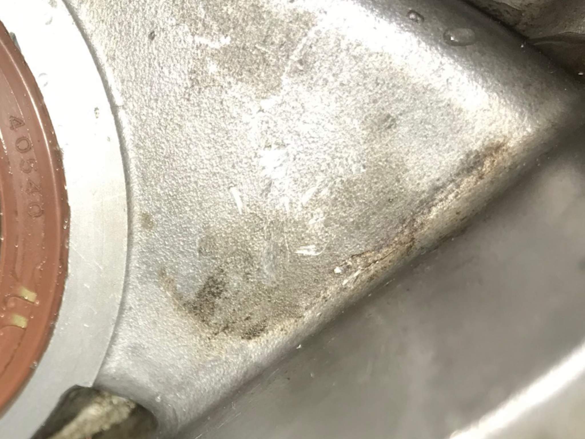

What’s happened here?
Could be from the oil cooler.
