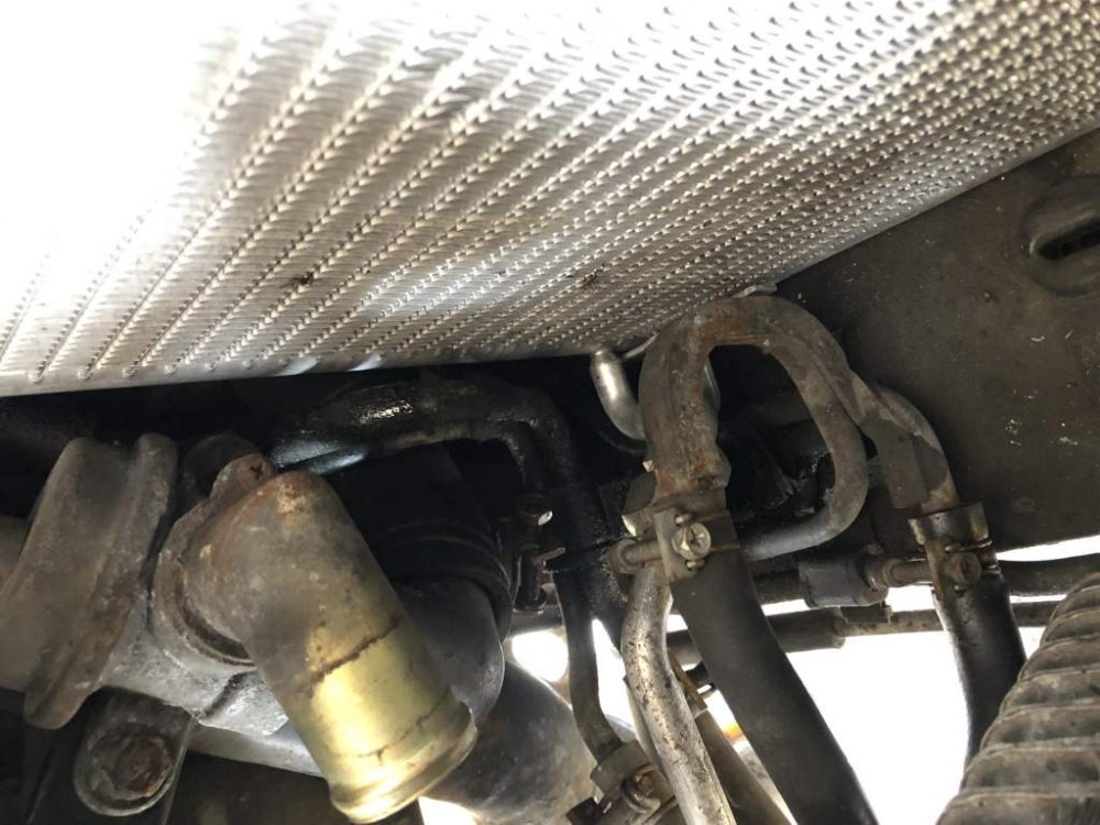

I’ve taken off my fan to remove the recirculating valves and any pipe work for cleaning and found heavy deposits of oil around the power steering cooler pipes behind the valve. I did have low PS oil when I brought the car but topped it up and haven’t noticed a drop in fluid levels.
Could be from the oil cooler.

Clean off all the oil, get the car running and see what leaks.
I cleaned up all that oil today so will hopefully be able to spot if it’s an ongoing issue.

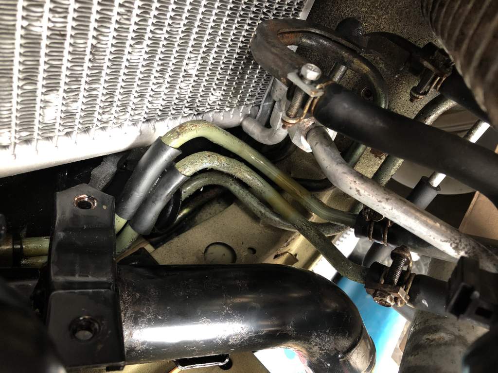

Chris delete the cooler it will probablycorrode and leak eventually anyway.
Thanks for the tip Jim, not heard of this delete before. Just to be sure do you mean the oil cooler or power steering cooler?
Power steering Chris,It was only Euro models that had it and they usually corrode out and lose all fluid.
Thanks Jim!
I did take the PS cooler off today. Mine isn’t too bad but it’s not good enough to go back in the state that it is. So what I might do is try a refurb and if it doesn’t go well I’ll run a line from the HICAS pressure pump to the PS pot.
