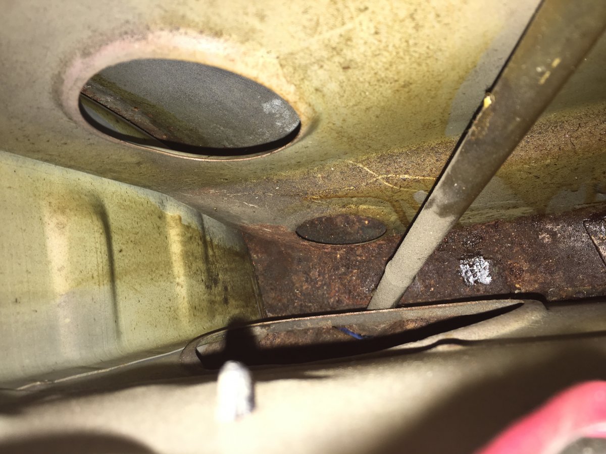

  5. Hi today with the help of my brother we managed to take the fuel vapour vent line check valve out, it was hidden above the rear Hicas lines, black round Unit, bit rusty up there but that will be done another time. We tested it and air passed through it both ways very easily, so we cut the end off and expanded the spring inside, glued it back together Tested it again and it worked would only pass air one way, fitted it back and started the car, revs went to 500 then back to 850 but a bit rough also stalled when I stopped reversing, tomorrow will take it for a drive then plug the Conzult in. Being a NLA part I will have to find a different one from another car.
