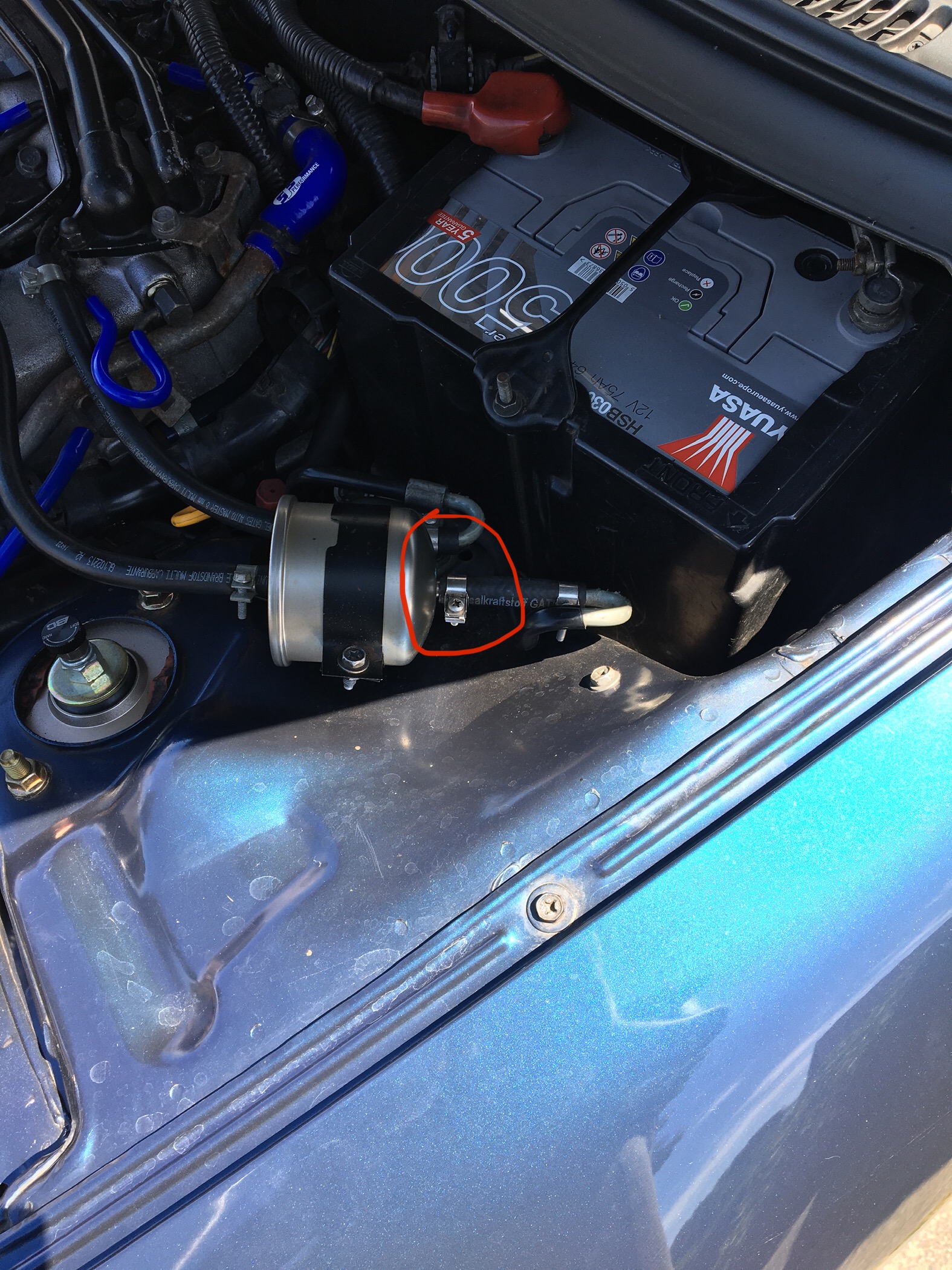

I’ve just had this issue for the last week and kept thinking I need to check it out. Good thing I came across this thread as it prompted me to check. After the car had been left to sit overnight, upon cold start this morning I opened the bonnet to check for leaks, and noticed fuel was very slightly leaking out the hose connecting to the fuel filter input side (pic below). Might replace the hose anyway as it has a couple chips at the end.
I went for a short drive and when I got home I opened the bonnet and all the fuel leakage had evaporated, because of the engine heat obviously. If I had looked at the engine after it was hot only and not before when it was cold, then I wouldn’t have known where it was coming from, as the leakage stains are so faint, I had my face right up close to be able to see the streaks.
So what I’m getting at is, turn engine on when it’s cold and leave for a couple minutes whilst monitoring engine. You might see the fuel seeping out of the offending area.
I read up on a random zed thread about fuel system leaks and that the screw clamps can get loose when going through the winter summer temp changes so they need tightening every now and then. Just tightened it up, started car and revved it for a while and now bone dry.
Had to tighten the clips once a year ?

Had to tighten the clips once a year [emoji846]
Yeah makes sense now after reading that thread. Will go around all of them and tighten.

Yeah these cars are always ongoing to do lists hey. Good thing you told me they need checking every year cos about half the screws weren’t tight. Instantly noticed when we went for a long drive last night that the fuel smell had gone so happy days [emoji1417]

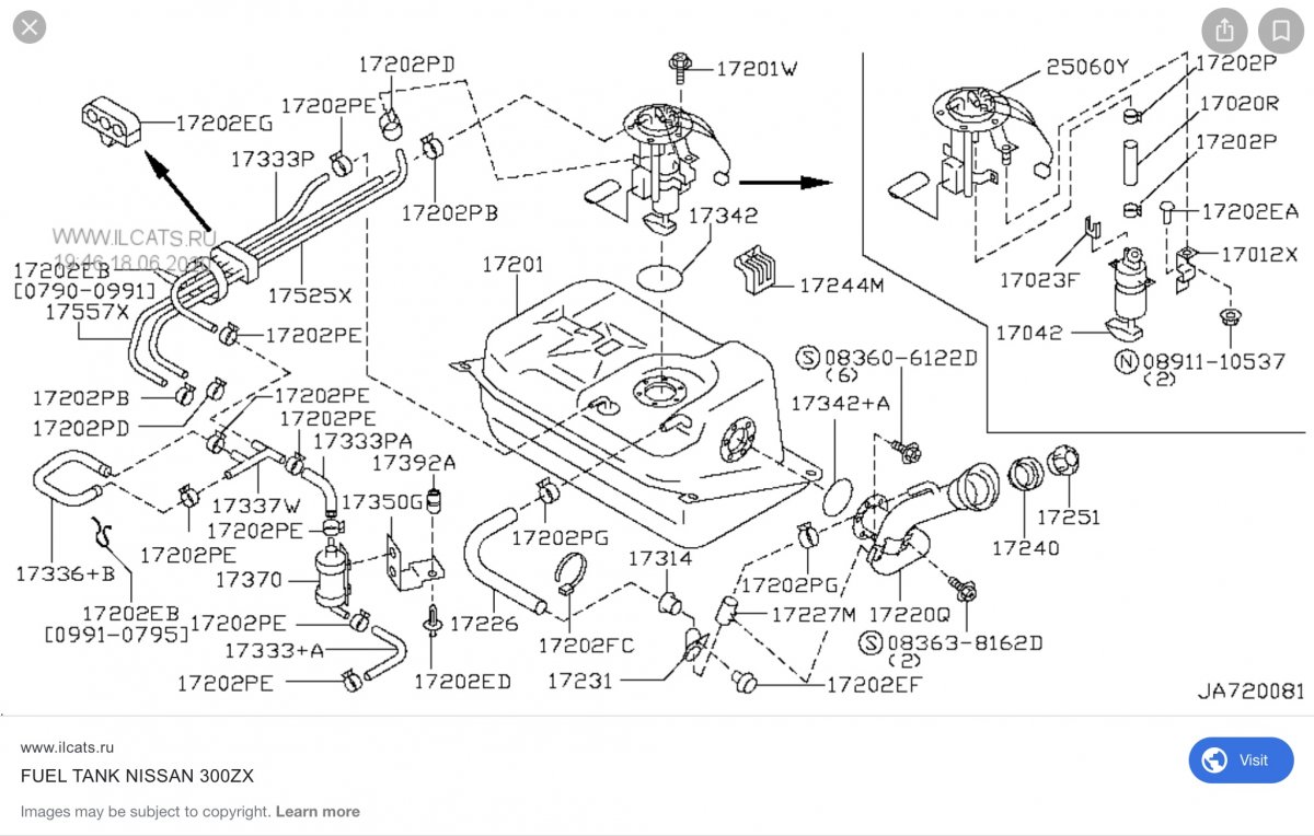

Does anyone know how much rubber pipe is used between the fuel tank and the hard lines under the car and why it is not mentioned with fuel line replacement.
Thanks ?
Can't answer the first part but I would suggest that they are not subjected to the hot heat cycles of the engine bay which harden rubber pipes
over time. Along with plastic connectors and engine harnesses.
Edited by AndrewG
Very true how long do you think rubber can last, supposed it depends on how a car was stored, used and what part of the world for imports.
