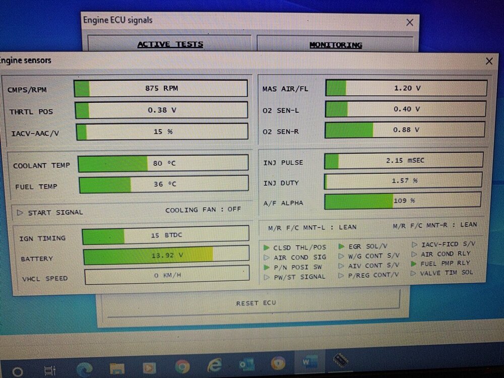

Hmm.. ok. Well if you’ve got a new MAF on the way you can eliminate that.
My next move would be the O2 sensors if you haven’t already.
The maf has came already and it’s the one in currently, is there any way to test the O2 sensors ?
thanks
there’s no errors codes
The diag software should give them.

Just an update, not sure if the maf is playing up still because when I check the voltage it’s 1.7V at my idle speed it 1350-1400
i have 2 Oem mafs here one reads 1.71V one reads 1.8V
also have a Chinese maf that reads 1.89-1.9V
the car is fully warmed up and idle is 1350-1400
im under the impression the voltage should be a lot lower ?
any input welcome thanks
