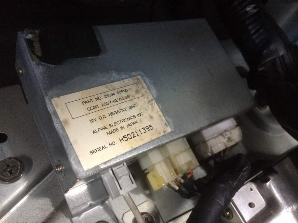

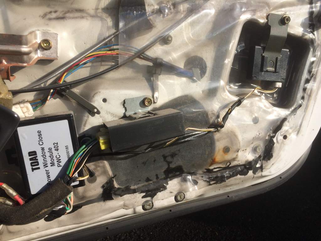

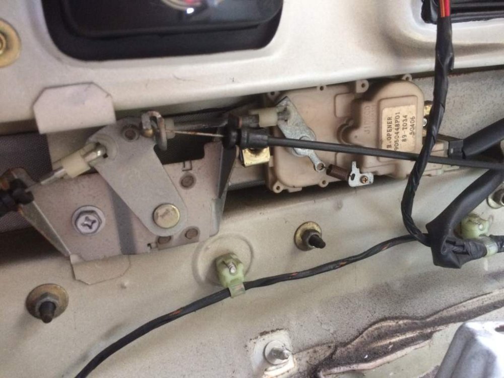

  3. Further inspection of 'my' donor, I looked for the keyless ecu in the footwell and there it was :). Excited by this find, I then take off the door card to find more goodies, tested the closure and the windows popped up and the mirrors closed in :cool3:. I then hurriedly take out some boot panels and sure enough the factory fit boot release acruator is there, works as well, one long press on one of the Toad fob's buttons and it unlocks, this will work better on mine because I have fancy strong gas struts and once unlocked the boot flies up !! This heap of rust just keeps on giving !!

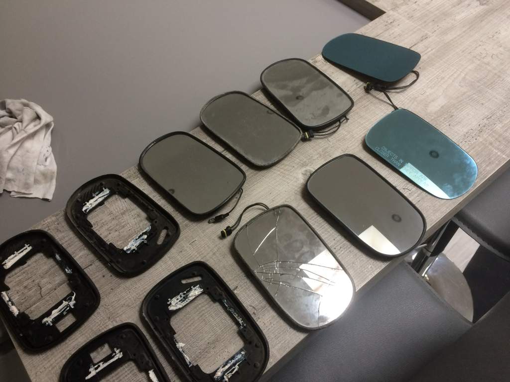

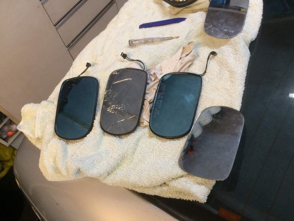

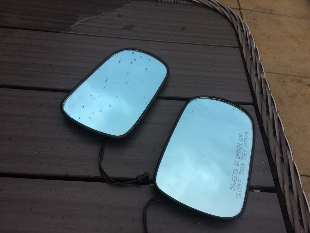

  4. I got myself some blue door mirror glass, you can read about my exploits in the thread below but these are very nice and will compliment my later series glass perfectly. https://www.300zx.co.uk/forums/showthread.php?189862-Blue-Door-Mirror-Glass-From-A-Nissan-Maxima&p=1983516#post1983516

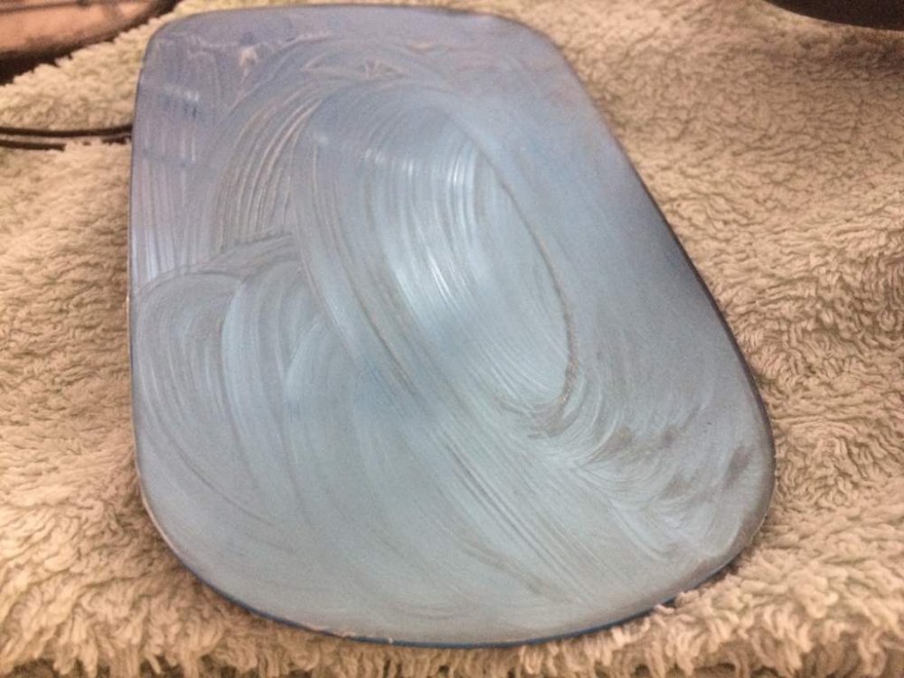

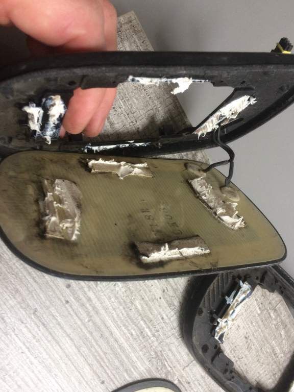

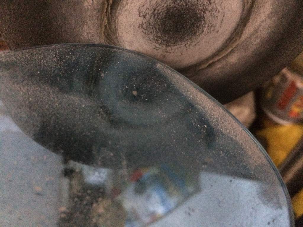

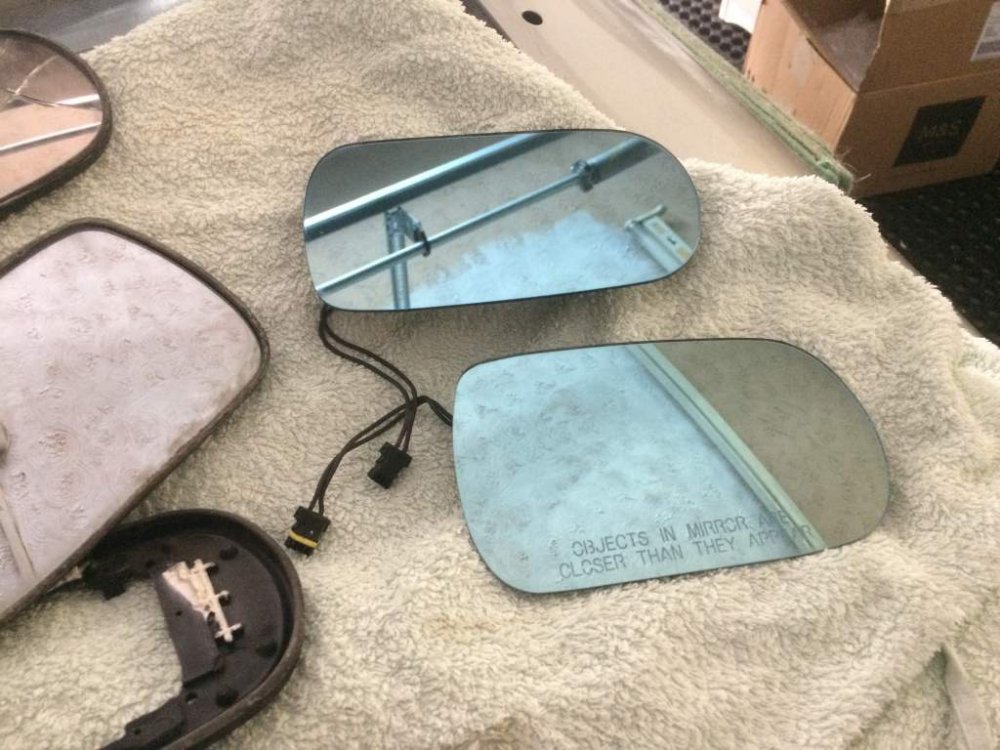

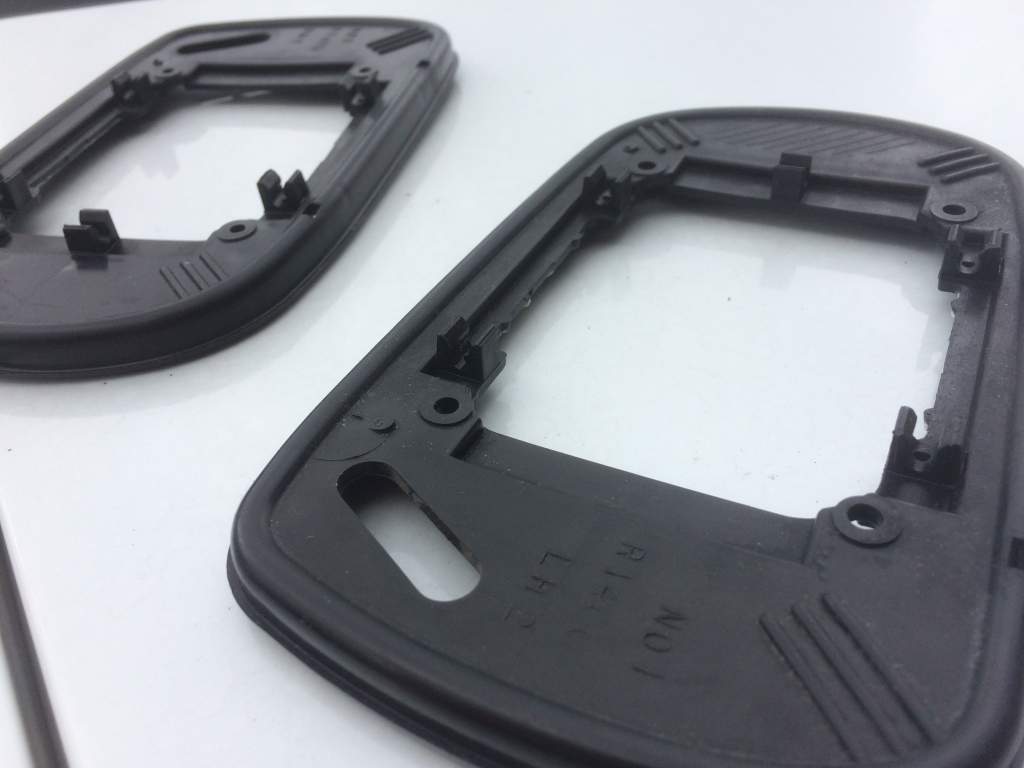

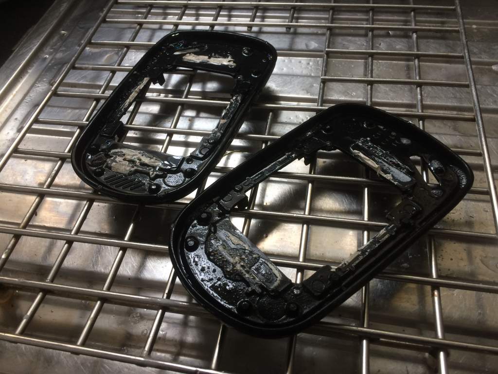

  5. First up, did you know the glass or mirror comes out of the back plate with ease, carefully just push out. So we end up with the door mirror apart and here we have my newly acquired blue tinted ones amongst my spares, sure you can spot which are which !! It became clear a little later in the day but from the pic below notice the left carcass is much thinner, so thin in fact it was weak, there was a tiny bit missing and pretty much crumbling away which led me to doing this 'job'. So with the glass out you can polish right up to the edges, I used G3 paste. Here they are nice and clean :thumbup:. Of course you need a left and a right, wash them in the sink, I did find that using a brillo around the front edges took all the years of grime off the plastic very easily. Make sure though they have the full compliment of lugs, these are the heated type with the slot, non heated ones do not have a slot, they have a square cut out. I put the r/h glass into the frame without an issue, the l/h one gave me problems and wouldn't go in, it was 3mm too long, this I cannot understand and takes me back to earlier in this thread where I said the walls of the carcass were thin, which did enable the mirror to slip in easy I grant you, it's either they came like this straight from the Maxima or the seller of these to me has 'doctored' them somehow. I pondered for a while what to do but in the end I got out my drill, clamped it to the bench and with a drill attachment I ground them down with 150 course grade paper which I had initially bought years ago for door window polishing, back and forth I was offering back into the frame, took me about 30 mins. Finally, it went in and so another colour comparison pic So not a straight forward job for me but I got there, something I didn't expect doing but I am incredibly pleased with these :yes:.
