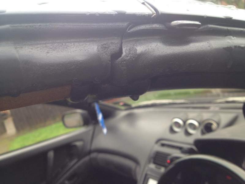

  18. My koi pond My water inlets. Front Water inlets, rear. yes the front one isnt seated correctly, but believe it or not, as it is like that, is how it lets in the least amount of water. The rear as you can see, is leaking right at the join of the targa seal and rear end of the door seal, so not sure how to even get that to seal up any more, its like that on both drivers and passenger side.

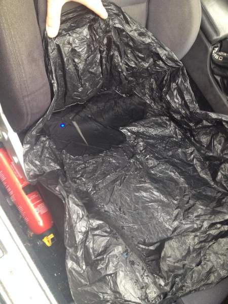

  19. the bin bag actually collects the water very well, the issue comes when driving, its a constant drip and if you break, then it just covers the right hand pod as the water then seems to just pour in. its like the targa rubber is water logged. i think i actually have a small pond at the moment as it rained last night, ill grab a photo and show you how ive got it set up to collect the water, one sec.
  20. I have tried absolutely everything and still my roof leaks, its that bad that ive had to use plastic bin bags on the seats to catch the water, and if you get a heavy down pour, you need to empty the bag of water the next day or it will drain into the car, its shocking just how much water that bag catches, id dread to think how much water is sloshing around in the carpet that i haven't managed to get via the bag route, or how bad it would actually be at the moment if i do not use the bags. ive found 3 locations where it leaks. The rear seal as the targa seal meets the door seal at the rear of the door, and the front join between the targa and the A Piller, and a new one is the bolts on the targa glass its self, where the release mech is bolted to the glass, this is now leaking on the passenger side. I have tried jeffTT's fix of sticking the rubber back down, but it seems that the metal is just too slippery for the silicon sealant to even grip on to, when it does grip, the edges still lift, i moved the seal via the holding screws at the edges in a bit to put more pressure onto the seals when they touch each other, hoping the added pressure would help seal, but still leaks, i then tried taking the seals off, giving them a wash in the sink (they were dirty as hell, well the water was after), put them back on, sealed them again using sealant and they still leaked, but even worse this time. i even took the door card off and adjusted the window so it pulls in tighter as the window comes up to full. Nothing so far has sorted the issue out, its like the rubber is water soaked, if i squeeze it between my fingers, its like ringing out a cloth, it just leaks water. i think my seals have positively had it and are no longer water resistant any more. Its actually driving me mental.

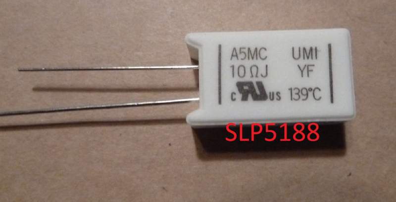

  22. Tried them already, seems its a pain in the ass component, found one on amazon, bit better priced. *EDIT* yay, no shipping to the UK though. doh! Other wise, considering the costs involved, it would just be easier to buy a working power board from ebay at £35 lol

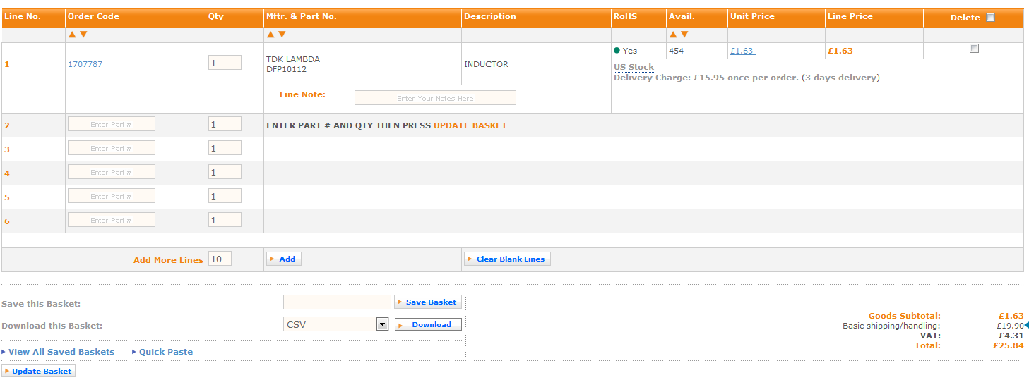

  23. Yeah tried them, check this out Can someone please explain to me why it costs £19 to post?
