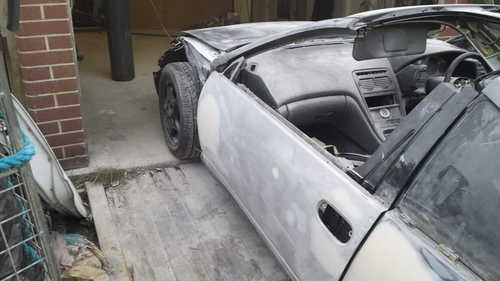

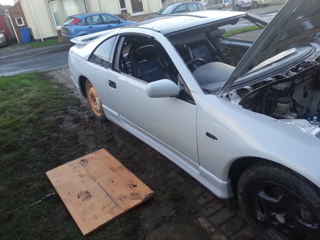

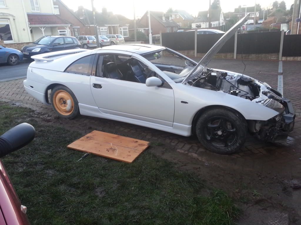

This is how it looked when I 1st got it

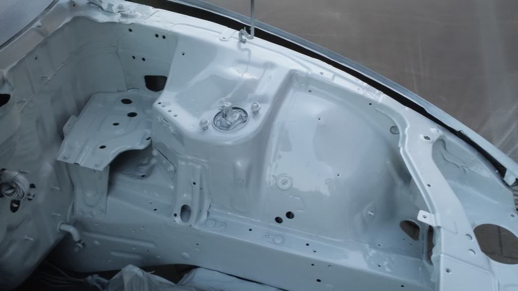

The engine bay

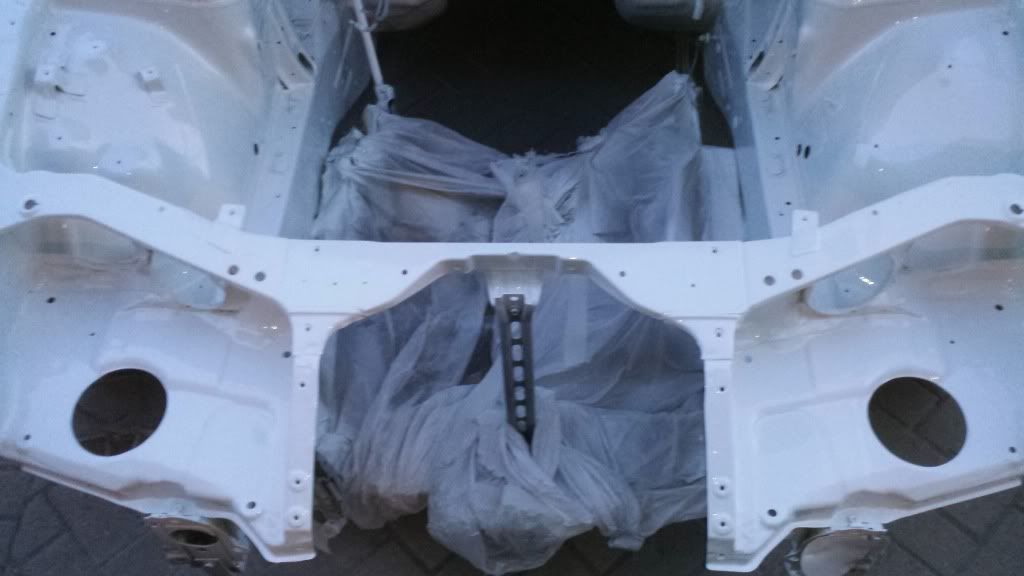

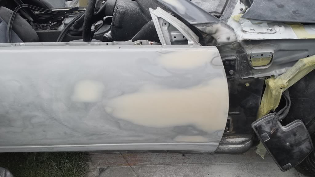

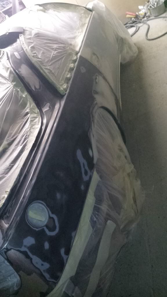

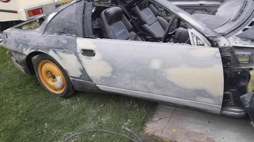

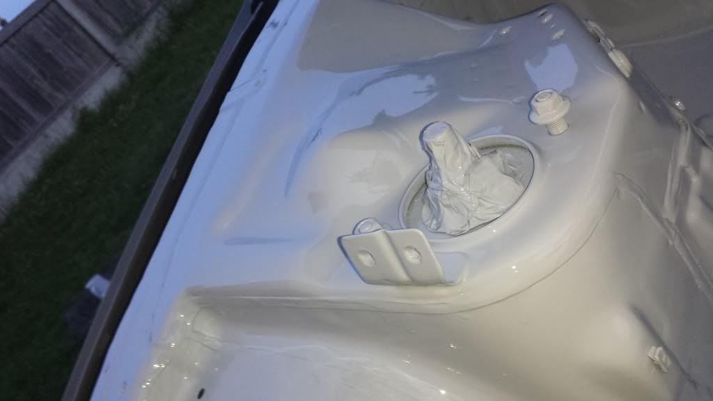

I took it back to metal etch primed then seam sealer then 2k primer
Then some 2k white

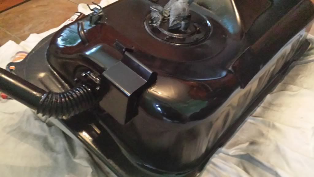

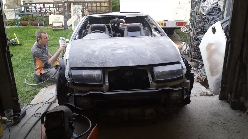

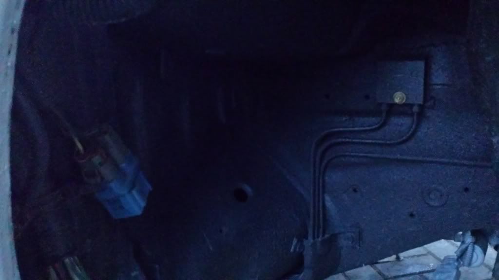

The underneath was stripped of all running gear the tank etc and stone chipped,

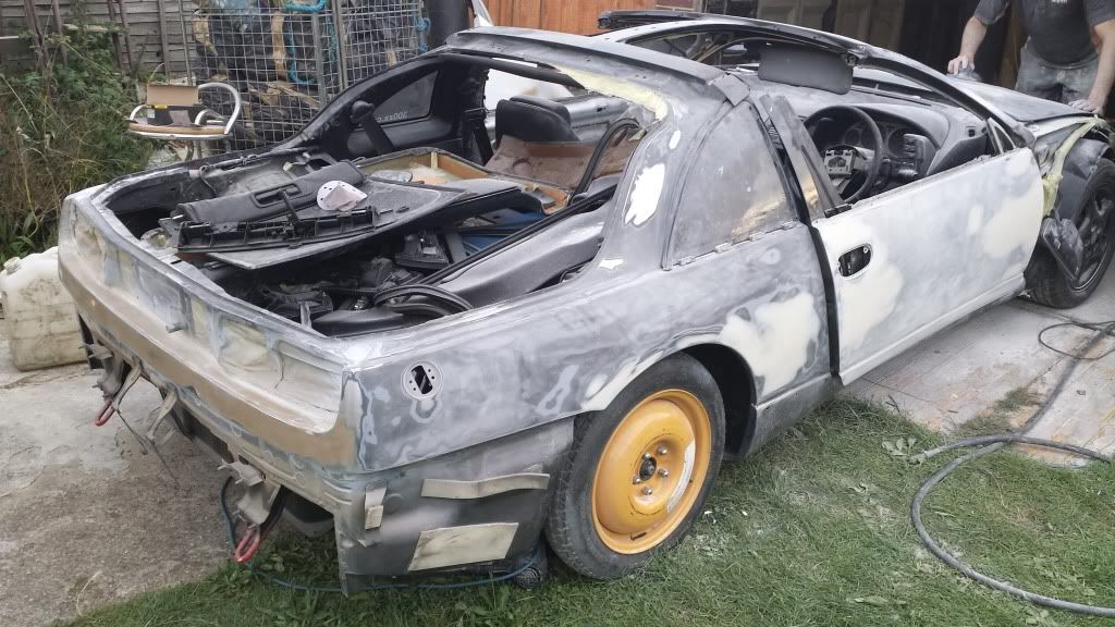

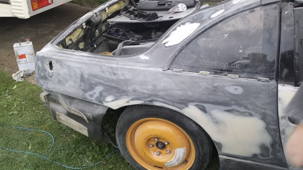

Then I moved on to the outside

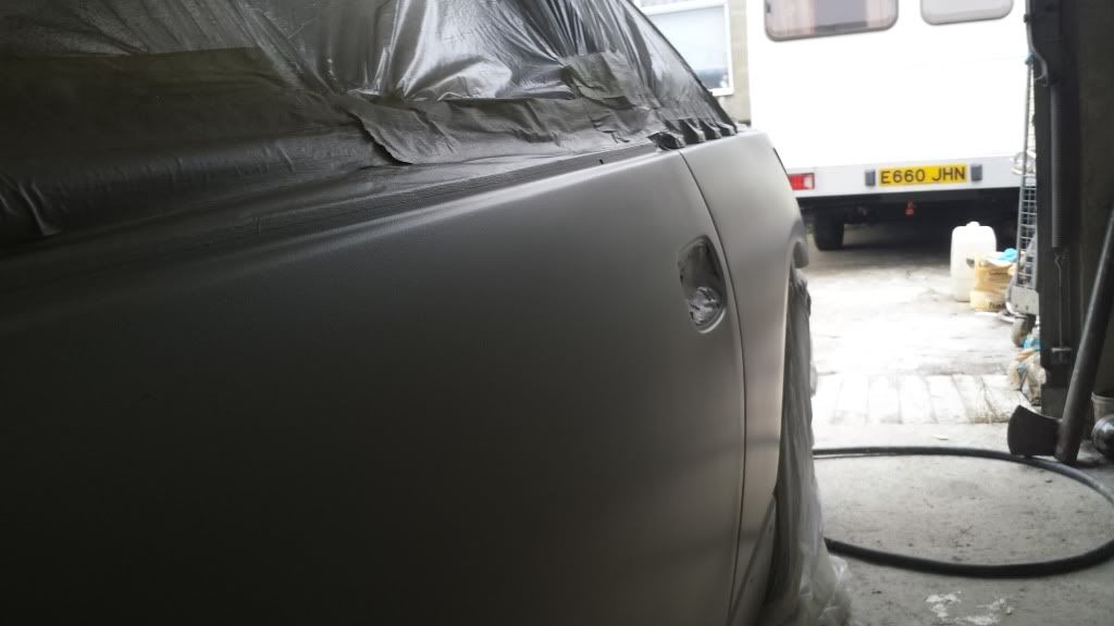

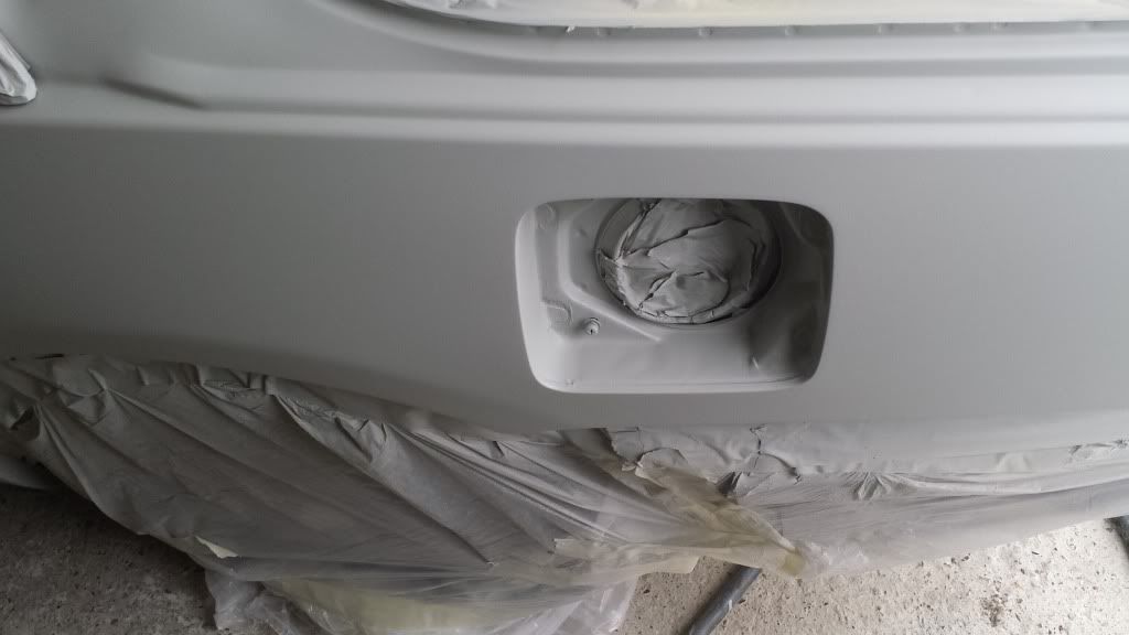

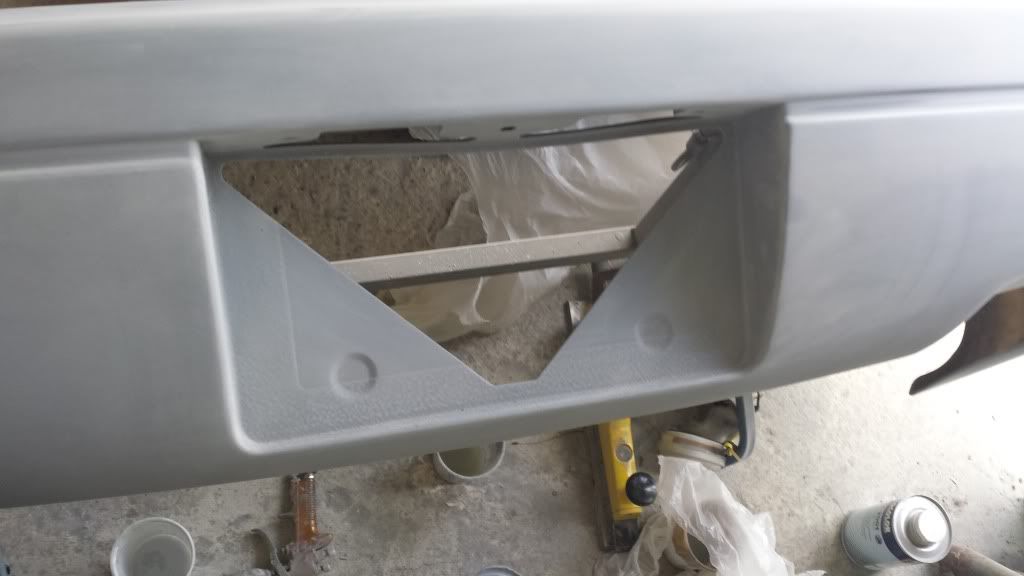

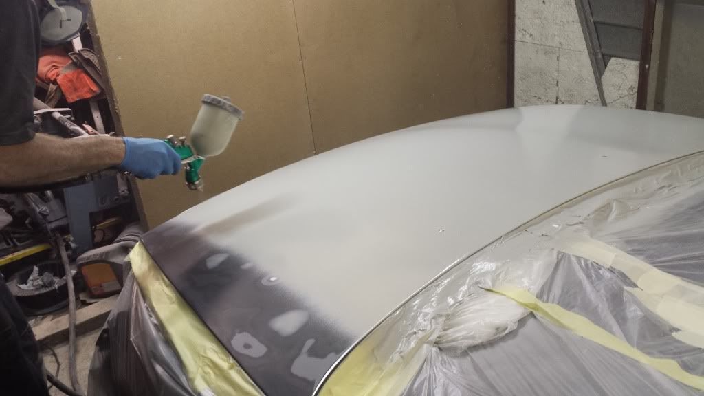

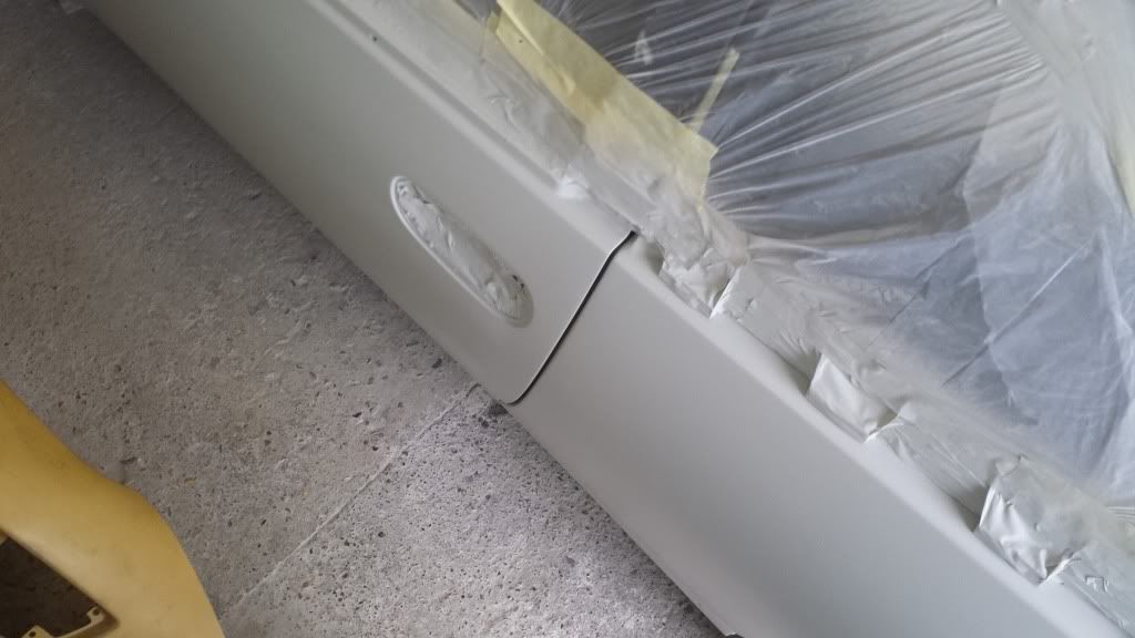

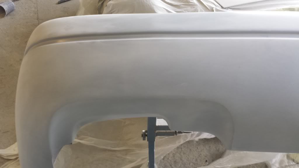

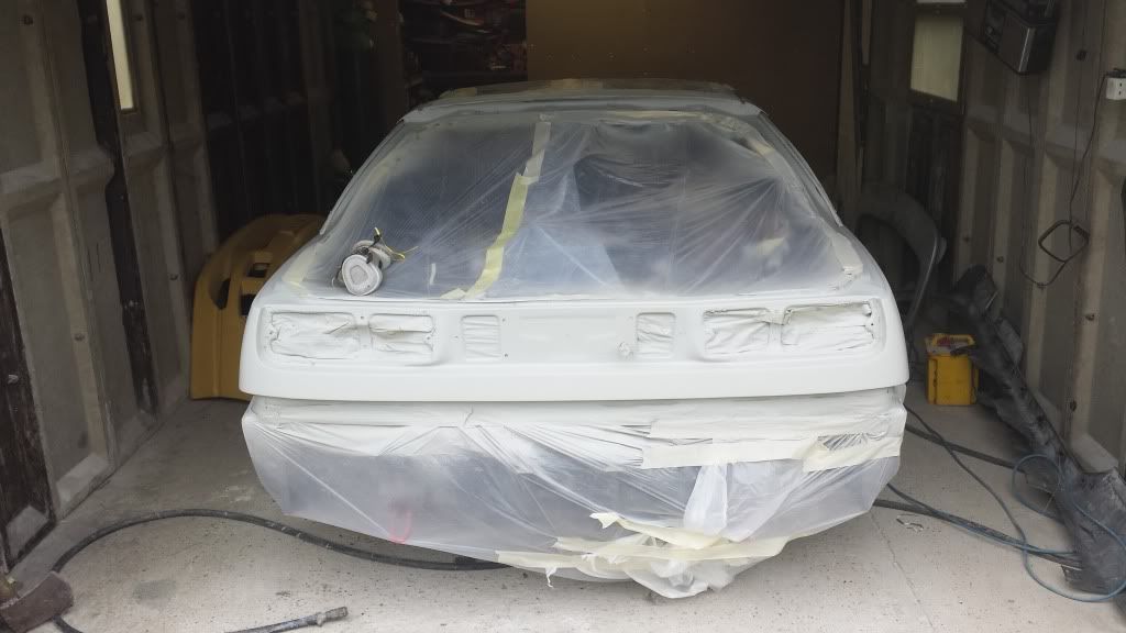

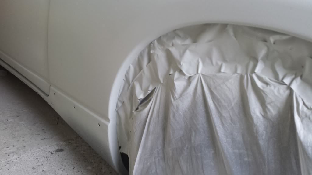

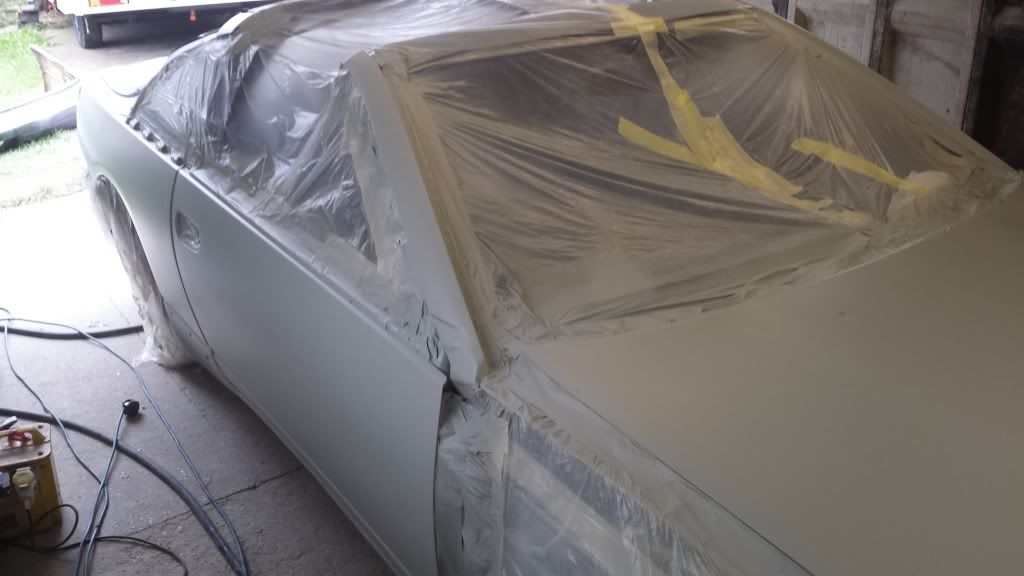

Then we used 2k primer on the car

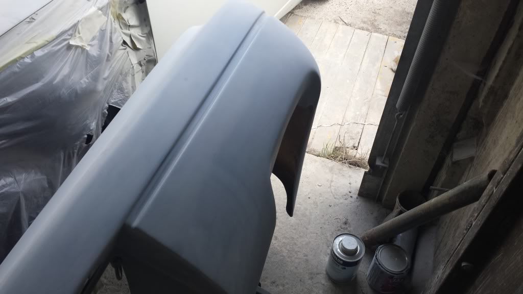

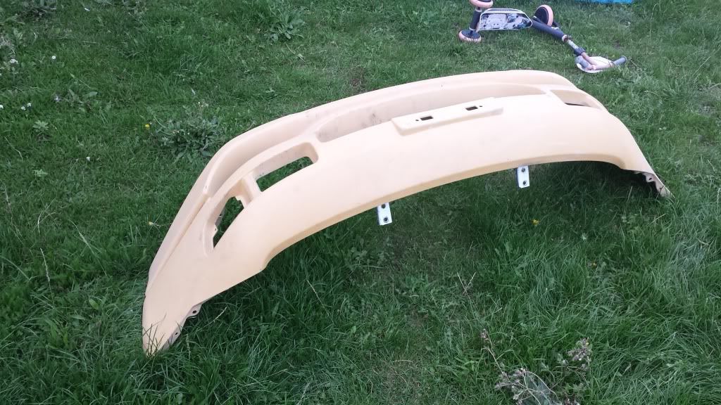

No stone chip on bumper

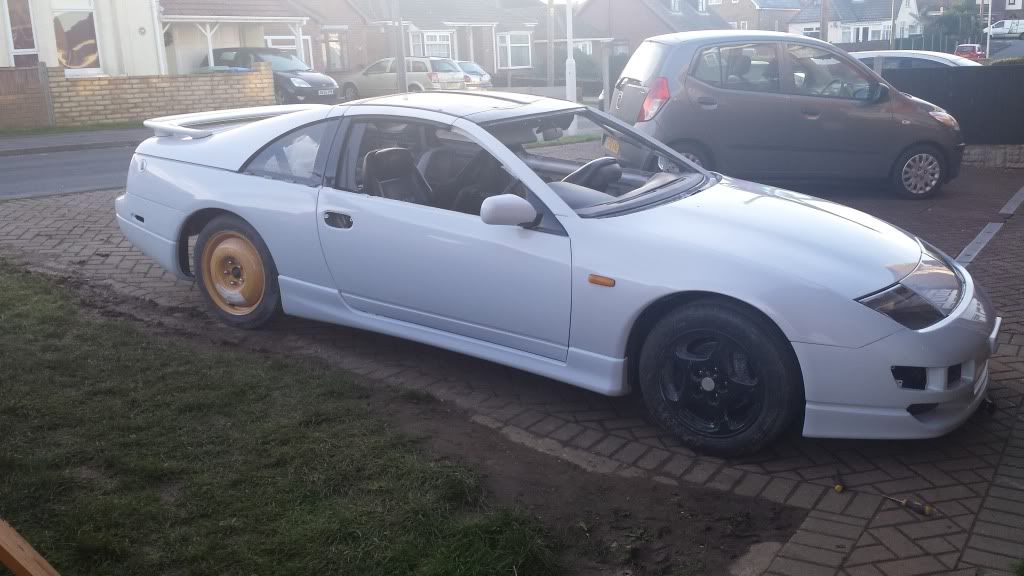

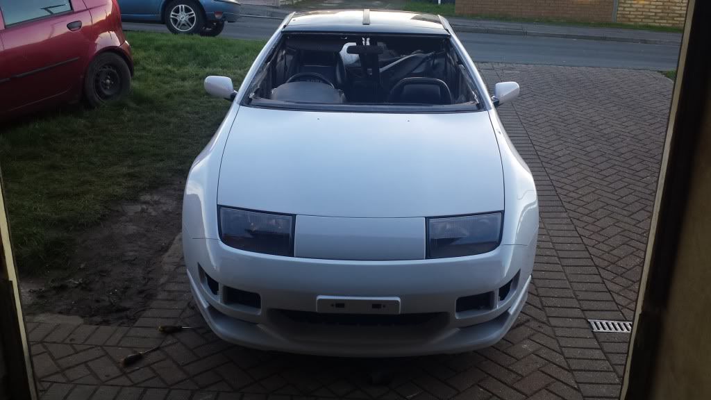

Car was resprayed in suzuka grey pearl
Version r skirts and 99spec bumper

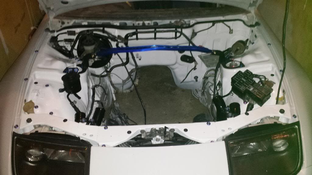

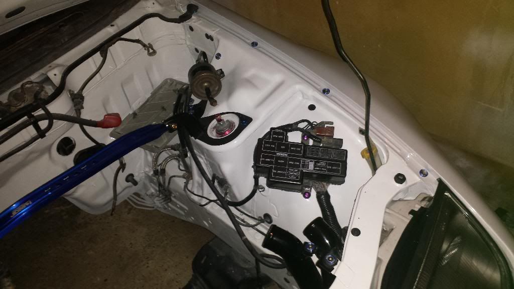

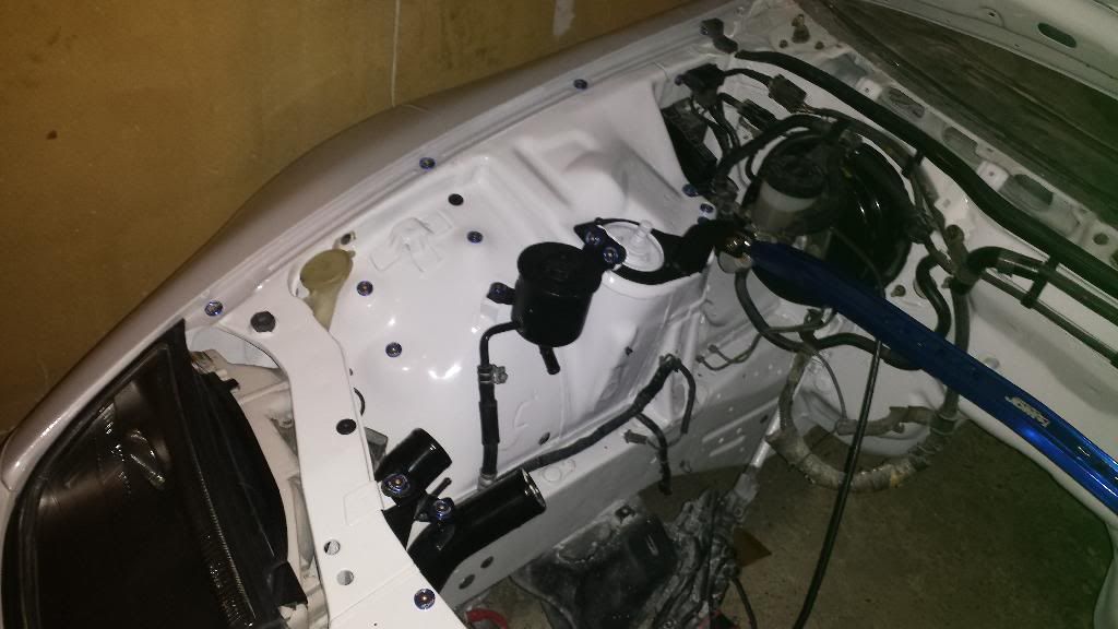

Just finished putting all looms, bolts and bits in the engine bay,

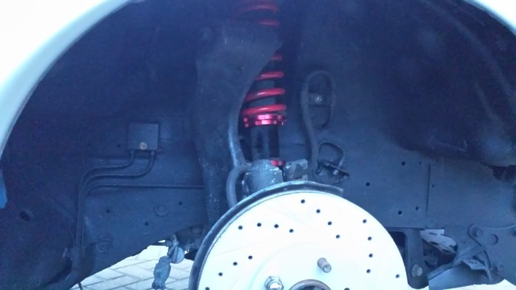

Got overspray on coilover tops cause im powder coating them blue to match the rest of engine bay...
just gotta clean the sanding dust from the subframe and clean all the looms up from dust but starting to look like a car again.
Just needs engine

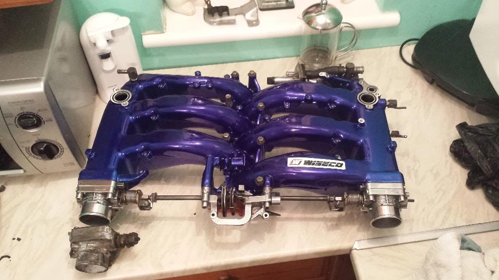

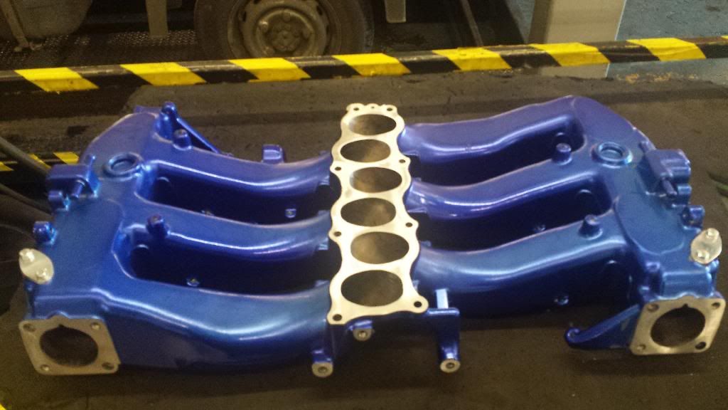

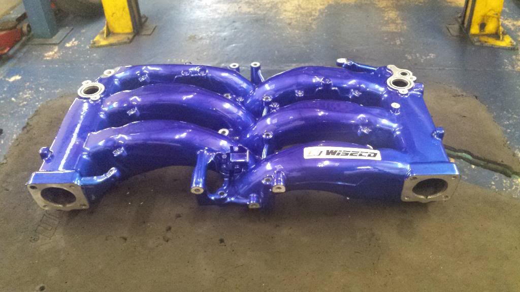

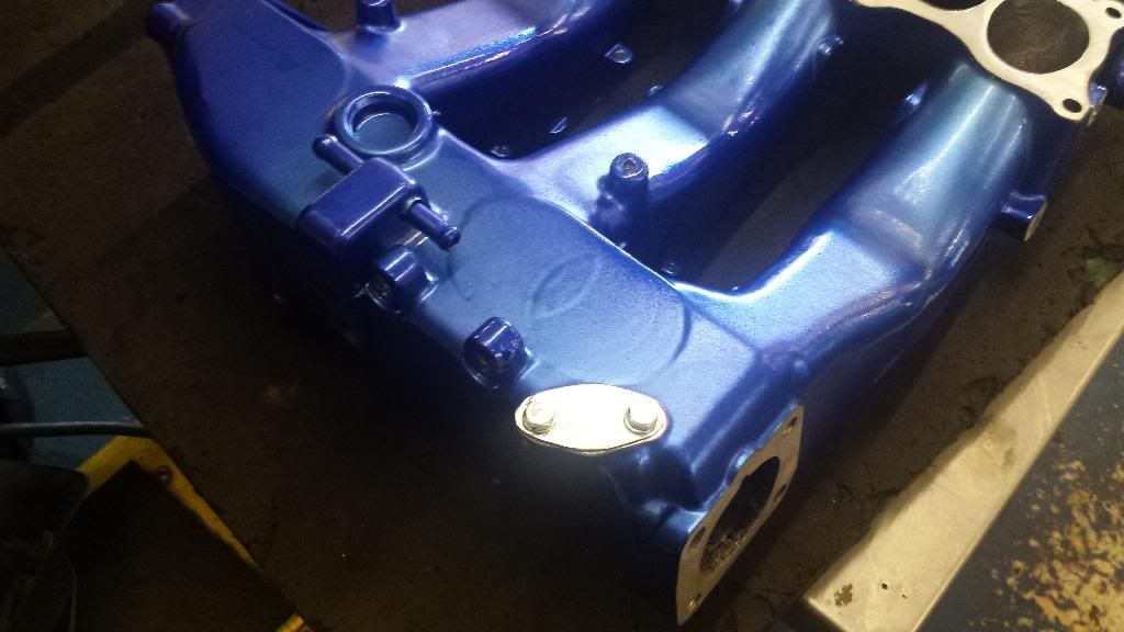

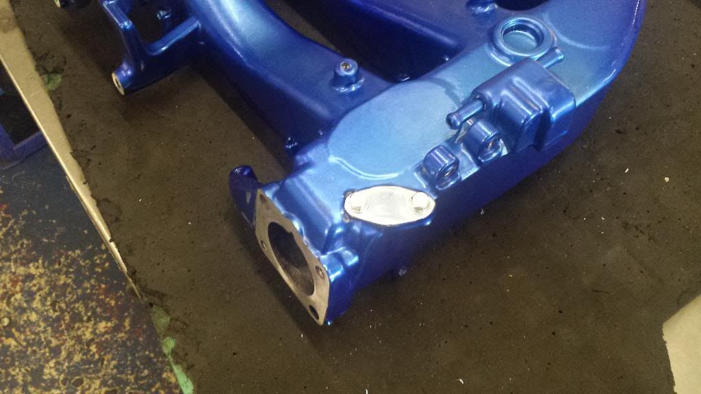

my plenum it should look good with blue hoses and all the blue bolts
so now just need new windscreen and glass all fitted, the rebuilt engine fitted and my new wheels need tyres.

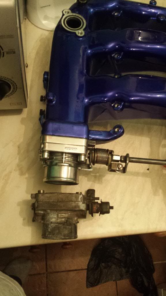

I started to build my plenum today at work,
The throttle bodies were filthy so I tried to polish them, was a mission to do...
But it seems to have made a big difference, I put another throttle body next to it which is about has dirty...
And I stripped them down was shocked how many springs and plastic bits were in there lol...
