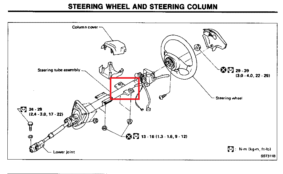

  4. Cant really do a search for this as its throwing up completely the wrong results every time i search, so time for an explanation, (seems that this year is the year for problems to arise on my zed) Hard to explain this so ill try my best, the steering wheel its self shifts left to right, only by around 1/4 an inch, ive narrowed it down to 2 metal bushes, either side of the main shaft, directly behind the interior panel under the steering wheel, seems as though my steering wheel is no longer sitting in them correctly, ive undone the bolts to try and see if i can adjust the fitments, but if the steering wheel is sitting where it can not move, i cant get the bushes to line up with studs to fit the bolts and tighten down on. the service manual mentions nothing of these bushes Problem area, highlighted in red, the bushes are allowing the wheel to shift left and right.
