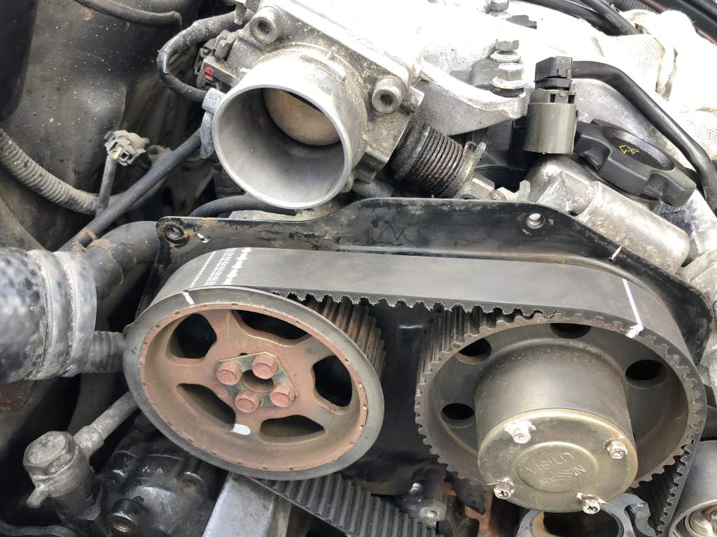

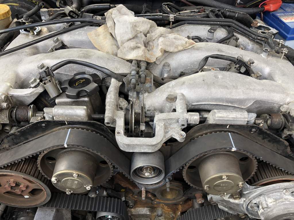

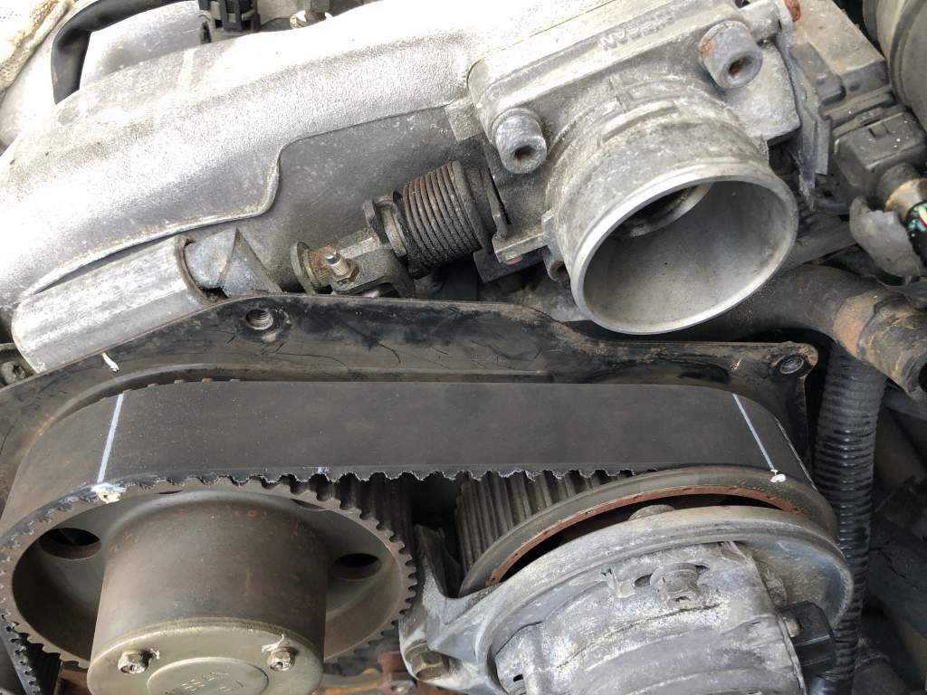

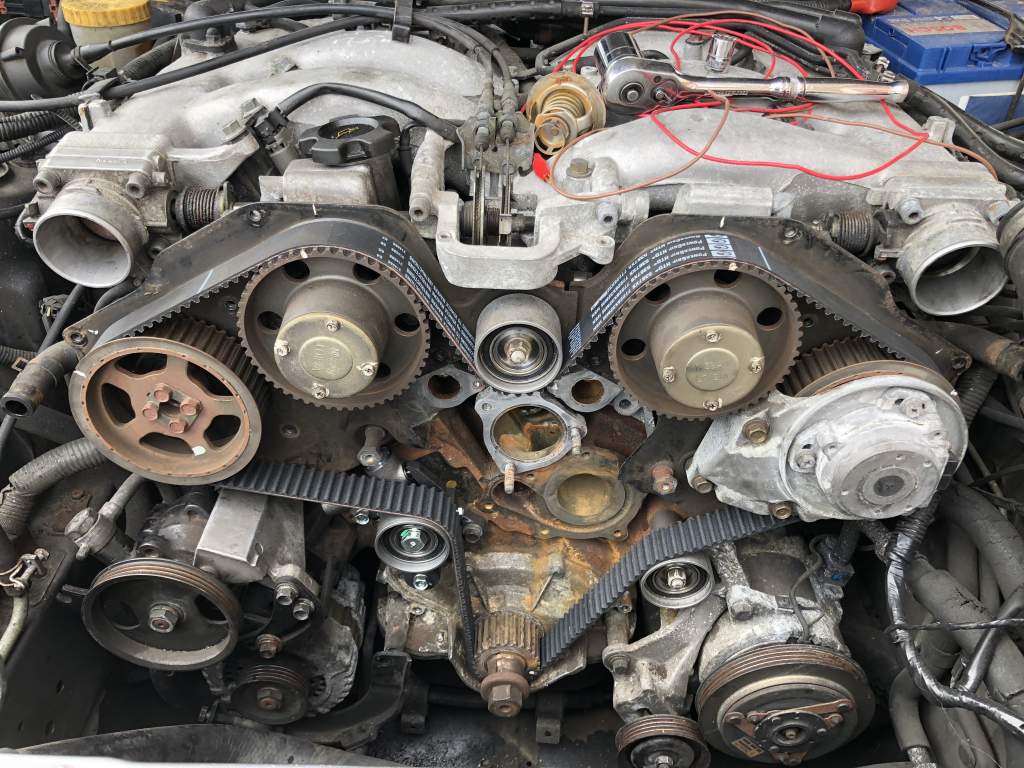

  14. Well the belt marks line up with sprocket marks and don’t move so that must be correct. Right?
  15. Hi guys Thanks for yr advice thought it was as spot on as it cud be. But have removed it and lined up the belt marks with sprocket marks and also have tensioner set up with a good gap. Hope u agree that is all ok Turned by hand numerous revolutions and no feeling of interference or fowling so unless it is wrong again then I think it’s done:yes:
  16. Well thanks guys. Looks like it comes off and I do it again. Let’s hope it all goes back as in the link. Can’t see any reason why it won’t it all looks ok now tbh and cranks over by hand with no noise or interference but I will re do using the marks on the belt just to be absolutely correct Thanks again
  17. Haven’t got an FSM so not sure wat the tooth count or tension setup should be. Literally had tensioner on loose put a bar behind it and levered it out till right and did up the bolts. Whoops sounds like it should be a bit more scientific than that

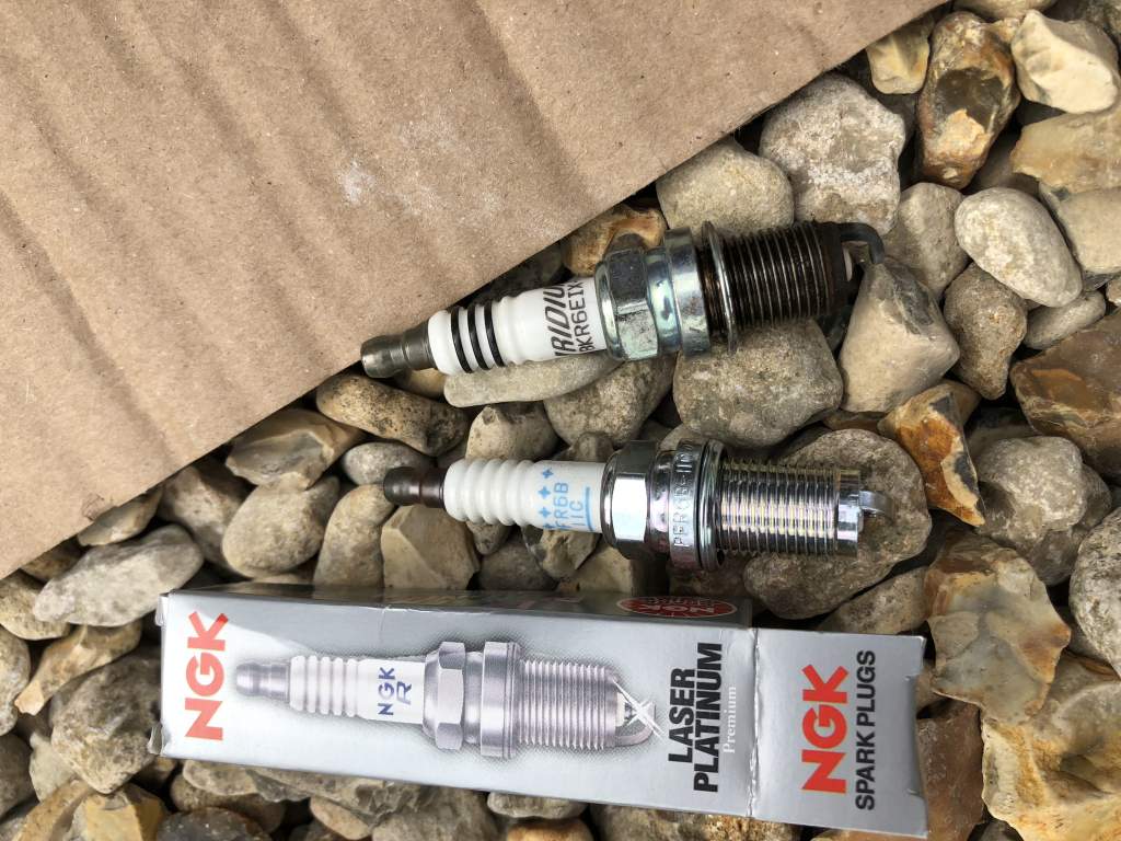

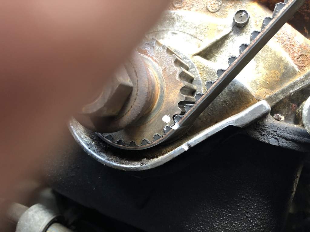

  18. Yeah I see that but it’s hard to line those up when u start from the crank sprocket. Had numerous times till all marks lined up seem to change when I did a couple of revolutions. All ok now:lol: Are those spark plugs ok ?
  19. Hi decided to eventually get round to my cam belt Replaced idlers tensioner and belt Still have couplers thermostat and by pass pipes to replace and water pump. Was a bit of a pain when after cranking 2 3 revolutions found cam and exhaust cam was a tooth out then this was a struggle to get sorted as kept jumping on crank sprocket. Done in the end. Have a new set of spark plugs to put in new ones are ngk laser platinum old ones ngk iridium any noticeable difference or preference?
