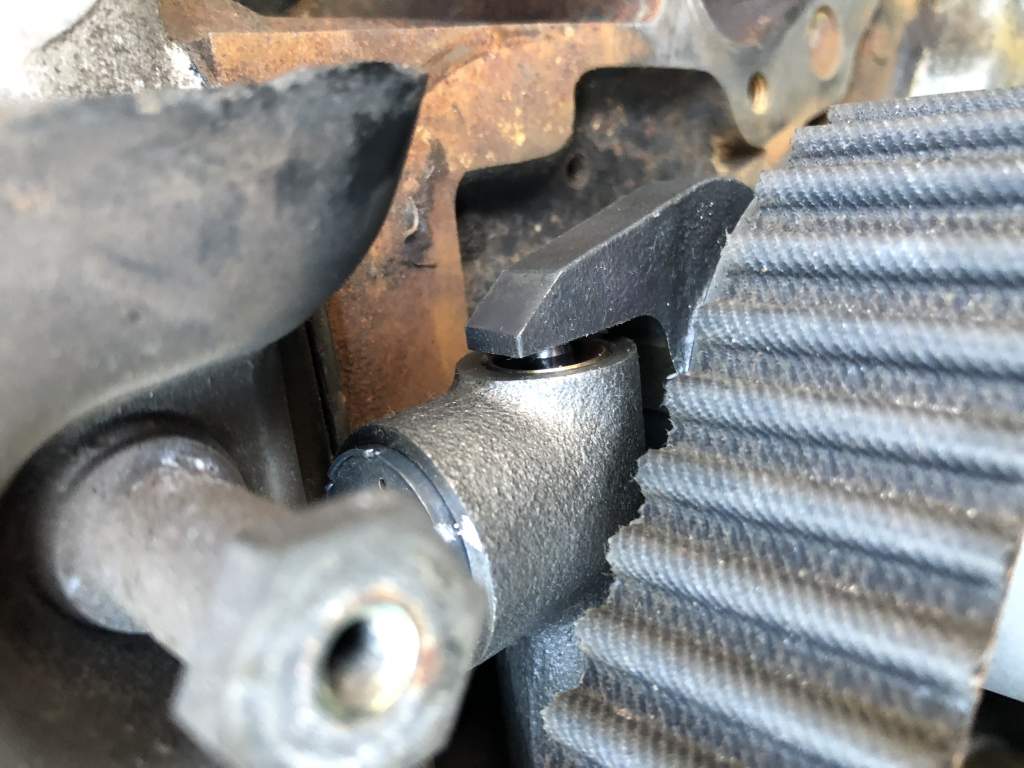

Hi decided to eventually get round to my cam belt
Replaced idlers tensioner and belt
Still have couplers thermostat and by pass pipes to replace and water pump.
Was a bit of a pain when after cranking 2 3 revolutions found cam and exhaust cam was a tooth out then this was a struggle to get sorted as kept jumping on crank sprocket.
Done in the end.

Are those spark plugs ok ?
Odd it shouldn’t be. You set the engine to 0TDC then the belt has arrows to donate faceing. The lines line up with each sprocket mark. Personally I thought that’s what makes it so straightforward. It’s done now though isn’t it. Have you done the tooth count as per the FSM and set the tension?
The PRFK6 11C are correct.
Haven’t got an FSM so not sure wat the tooth count or tension setup should be.
Literally had tensioner on loose put a bar behind it and levered it out till right and did up the bolts.
Whoops sounds like it should be a bit more scientific than that
**STOP ** you have not done the cambelt correctly.
Jeff
[ATTACH=CONFIG]114064[/ATTACH]
Read this >>
https://www.300zx.co.uk/forums/showthread.php?135139-Align-timing-belt&highlight=cambelt
Yup - what Jeff said.....
…..Which is why I would only trust Jimmer to do mine nowadays...!!!
I have watched Jeff do this - on my own Zed - and whilst he made it look simple, that was down to years of experience. Anything is easy if you know how; but it's just as easy to mess up - which could prove disastrous!!
Well thanks guys.
Looks like it comes off and I do it again.
Let’s hope it all goes back as in the link. Can’t see any reason why it won’t it all looks ok now tbh and cranks over by hand with no noise or interference but I will re do using the marks on the belt just to be absolutely correct
Thanks again
The engine cranking is not indicative of it been correct, with the belt how you have it.. at best the engine timing ( cam`s to crank ) would be compromised and be under powered / troublesome, at worse that adjuster will be too tight and loose the belt!
Get it off and do it right, you should not need to fight it on if done correctly, you need to put the 10 mm adjuster bolt back in and close it up, leave the bolts holding the adjuster on to the block loose, when the belt is fitted on,use the adjuster pulley to hold the belt on as you just nip it up, now press the adjuster against the belt gently to take some slack out.
Now nip up the bolts to the block tightly, and finally the pulley bolt.
Check the belt timing marks against the pulley marks ( not the back plate) take special attention to the crank and belt markings, now take 5 mins and take photo`s.
Go back and check everything, and now you can remove the 10 mm bolt from the adjuster completely, now check all marks one more time and if all good rotate the engine at the crank.
Be aware the belt timing marks and the pulley marks will NOT line up again unless you turn the engine backwards which you don`t want to do.
I cannot emphasise the importance of getting this right, especially as if slightly wrong the engine will still run, but it will have issues you will be chasing around for ever.
Jeff
