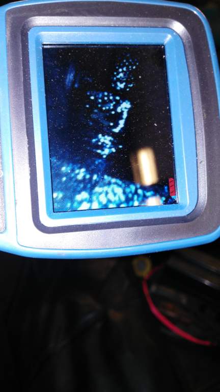

The first tricky job Jim had to sort out was the oil leak. The oil leak was from the passenger side turbo and looked lightly to be the oil feed as the top of the turbo was wet and the rear engine seal was also leaking.
The top picture is an image from a borescope.The union is visible and very wet with oil.The rocker cover gasket was dry so Jim knew it was not coming down from any higher
So after many MANY hours removing the gear box and turbo Jim was finally able to fix all oil leaks (near side turbo oil feed and engine rear mail seal).

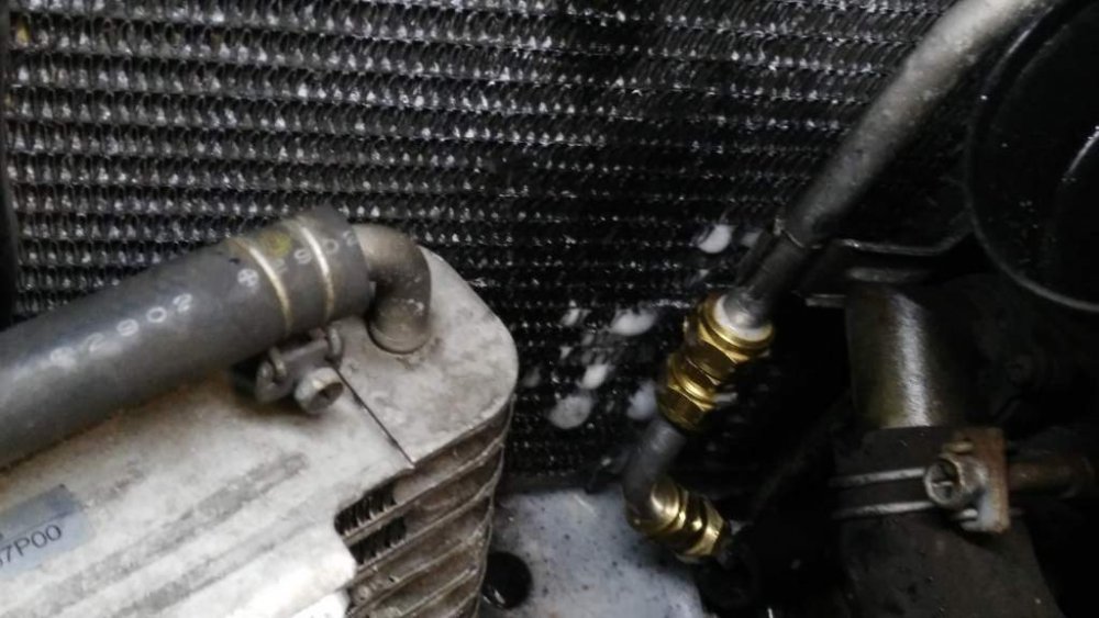

The most frustrating job Jim had to deal with was fixing the air conditioning.
Mark had said that the air conditioning conderser had suffered a nick and was leaking. A used condenser was supplied with the car when I brought it.
Jim had advised that the condenser can be a pain to replace and that I should consider fixing the old condenser. Not convinced that I wanted things "patched up" on my car I asked Jim to replace the old unit with the used unit, Jim dutifully oblige.
After pulling everything out and replacing the broken conderser Jim arranged for the air con system to be regased. You've guessed it, the used unit was like a "colander". Unfortunately a new condenser wasn't available so Jim had to order one through CZP.
The nice new shiney unit arrived and Jim set about fitting it, called the AC guy back to charge it up and... Nope, still not holding pressure.
Jim then went to look for other issues. He had to take out the air con dash unit and it appeared that somebody had been in there before.The tape had all been peeled off from the evaporator valve and wasn't original. He checked for any ingress of material from the dryer cannister and swap the whole unit.
Let's call the AC guy up again... Bingo, it's fixed! 3deg coming out the vents, I thought Jim was hiding Olaf in the back seats when he showed me how cold the car got! ?
Edited by Chris300

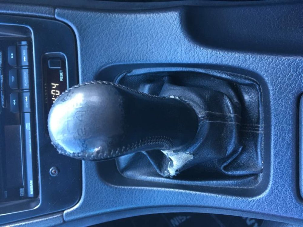

Firstly I fitted my wonderful handbrake and gearstick gators from Si at Hide ‘N’ Seat. My gearstick gator was in really poor shape. The handbreak wasn’t too bad but thought it best they both match. The quality of the leather is so nice, the stitching faultless and all the holes were in the right place to make fitting a piece of cake. The only problem now is that the nob and handle really look like they need replacing but I’ll try and hold tight until I get a full interior booked in.

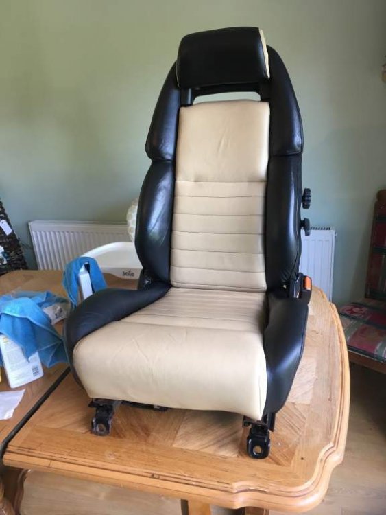

So this is a bit of a sideways step while I ponder, plan and save for a new interior from Hide’n’Seat in a few years.
I brought a full interior from Martin. The interior is filthy, it looked like it had been sitting in a barn for 10 years, but the leather and bolsters were in good shape and with a good clean should be more presentable that my current interior.
There are a few compromises I’ve had to make, it was my plan to move the leather to my fully loaded frames however the drivers seat has a manual lumbar support lever which will leave an unsightly hole when moved across so it’s going to have to stay on the current frames. Also the drivers door card has a hole by the window switches where a start button was fitted. I’m hoping to take the old Alcantara of my existing door card and fit the new Alcantara to it if I can’t find a spare door card soon.
Anyway here’s a few before and after pictures of the front seat.

So all the interior cleaned up really well. It’s taken a good 8 hours and a lot of micro fibre cloths but I’m really please with the results. Here’s a few pictures of the Alcantara before and after a scrub.
And here are a few pictures of the interior change.
I am going to move the leather to my original seats but that will be a winter project.
