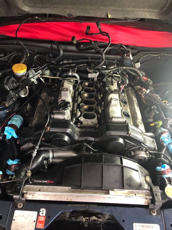

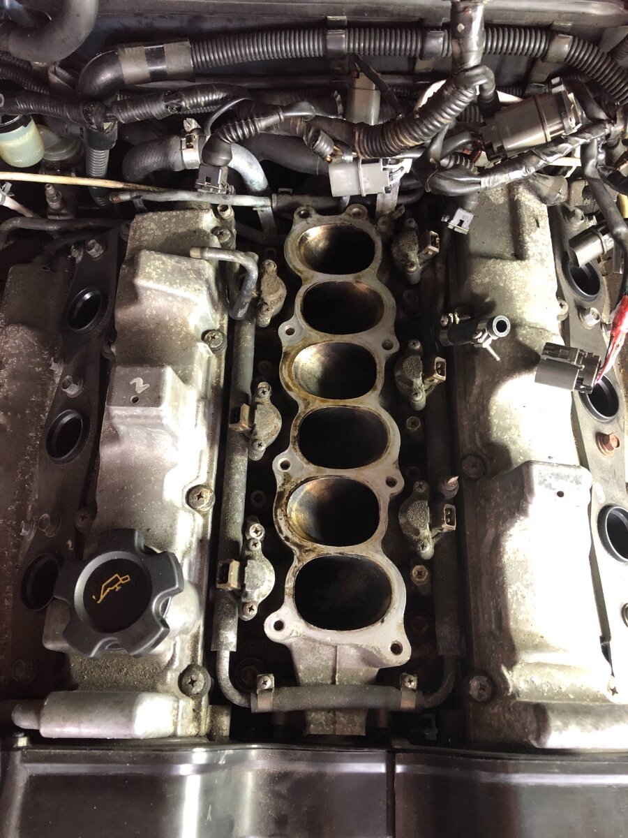

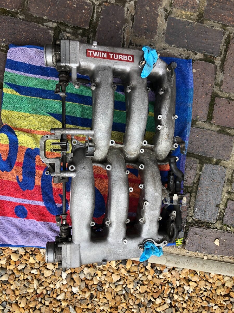

Finally managed to get the plenum off and what a faff it was too, although I’m in now doubt taking it off will have been a piece of cake compared to putting it back on. Really pleased with myself though and can’t wait to get the whole area cleaned up and put back together.

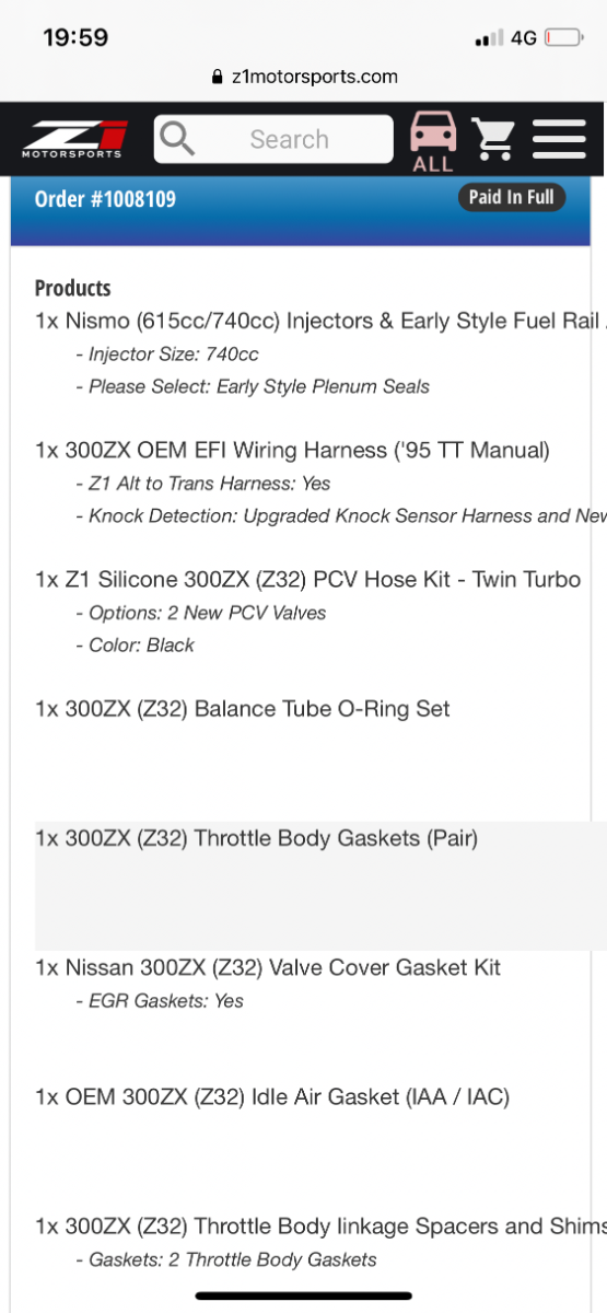

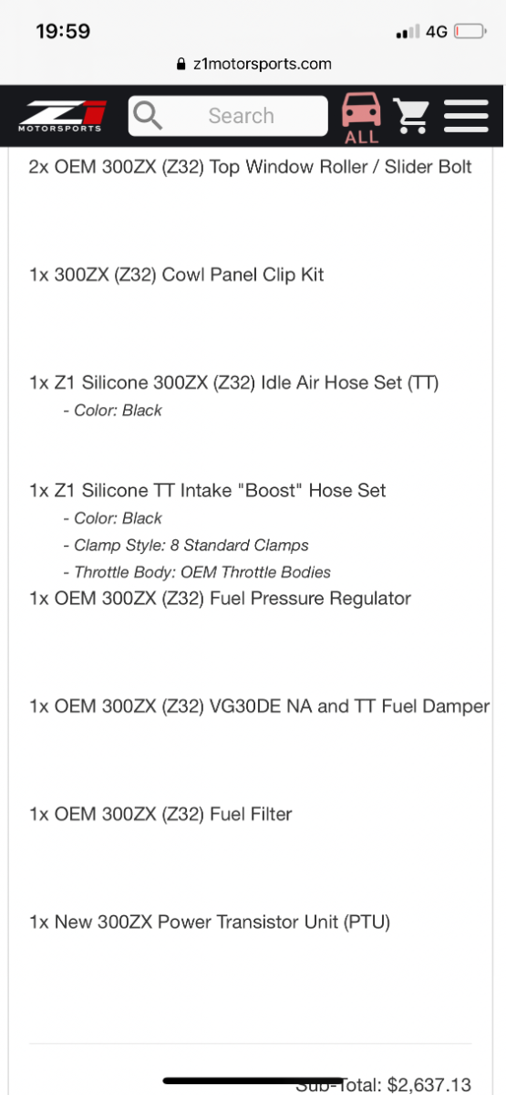

Well finally work seems to be picking up and with this I’d thought I’d take advantage of Z1 Motorsports Black Friday discount code and get this car back to its best again.
I was hoping that some of you (Andrew are you still here?) might take a look at my order and just confirm that I’ve got all that I need to get going again.
Thanks guys. Hope you’re all well as it’s been a while since I was last online.
906A6BDC-FBB2-450F-A036-E303FDB62B1E.thumb.png.e74c78527bebf395def4a5ee61b388b0.png799ACE53-16EF-48E2-B6EA-85AA62A0E9CE.thumb.png.49d69fbf353ff7d1843fa39e3acbb0aa.png

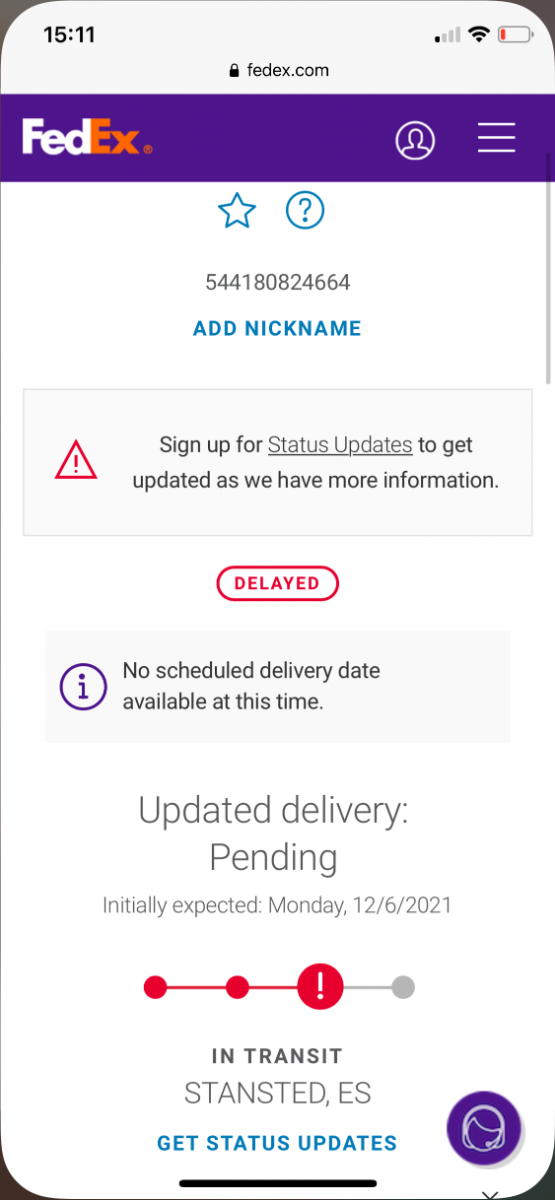

Does anyone understand why a shipment might be delayed at stansted? It should have arrived on Monday but seems to be stuck and I can get anything useful out of the FedEx people.54603C8F-7231-41D5-A870-27EF41786049.thumb.png.d71fe0edea67714e7795948f152f642b.png
Picked by customs maybe for inspection. And they'll have a huge back log this time of year.
I've just ordered stuff from Z1 Chris and am experiencing a delay like you with Fedex. Two things have caused a delay for
me.
1/ Z1 did not complete the manifest correctly - missing the HS (tariff codes) codes and adequate descriptions for the items.
This generated an electronic form from Fedex customs via email to complete (which didn't work!). I emailed Fedex customs
with the info they wanted after getting through to customer services.
2/ Fedex used to pass packages through customs and then invoice you to pay afterwards. The agent I spoke to said that for
"high value shipments" they want the duty and tax payments upfront before releasing the shipment. Another delay as they
didn't let me know. I'm waiting for the call from Fedex customs to pay.
https://www.gov.uk/trade-tariff or https://apps.parcelforce.com/tariffcode

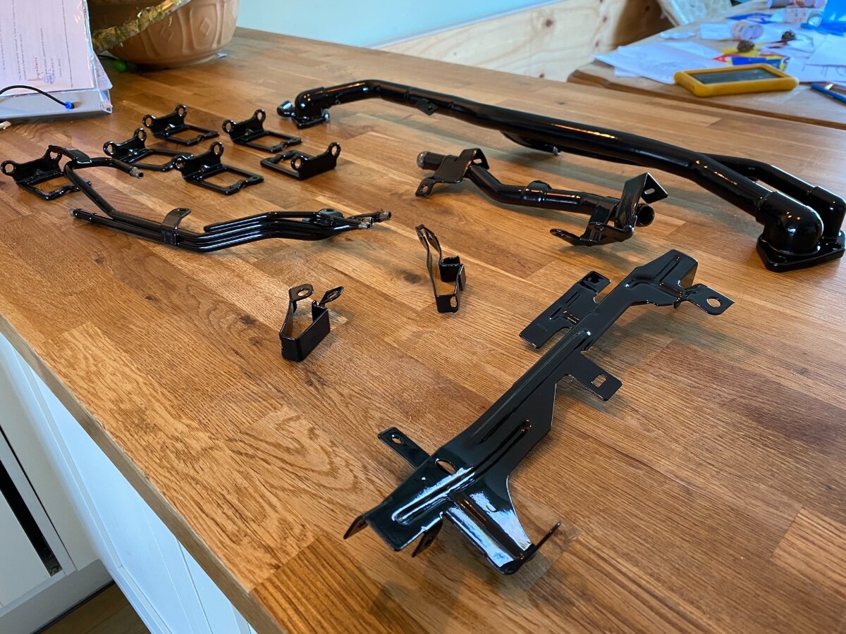

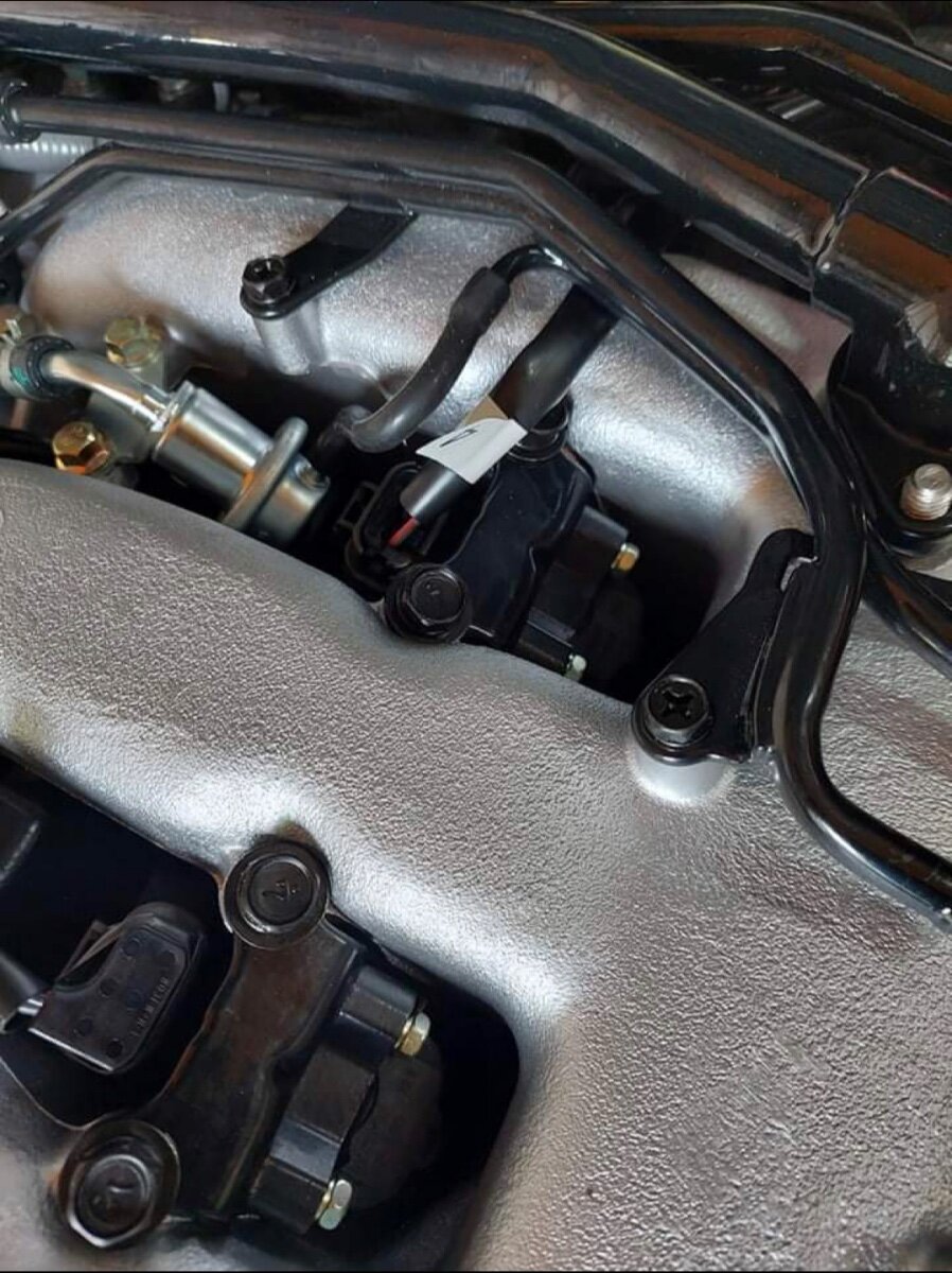

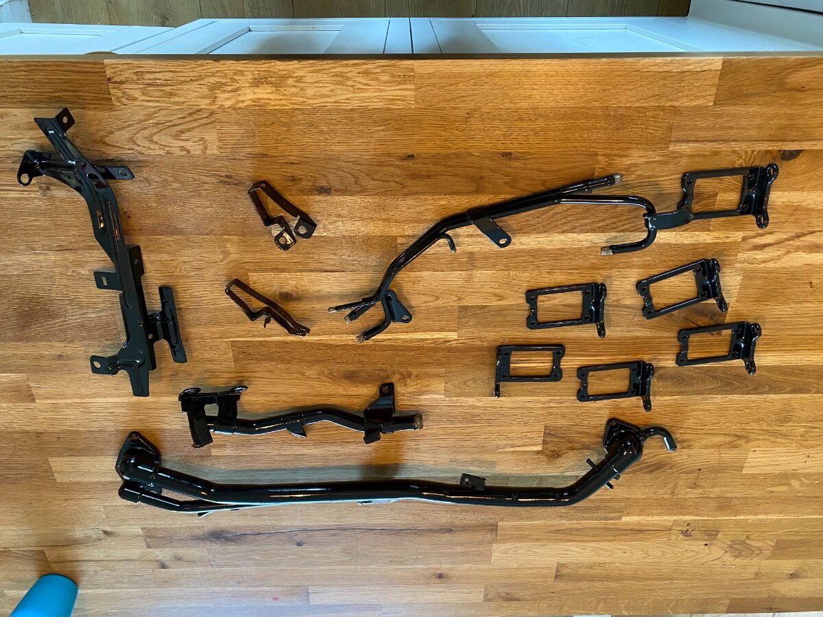

In preparation for this glorious day I’ve been getting a number of parts powder coated and nuts and bolts replated. Here’s a few pictures of a couple of newly painted parts. Hopefully get the cam covers and bolts back soon.
More yummy bits to go on soon. Just the came covers to go and it’s over to Jim at PowerZed.
Only bit I’m gutted about was I couldn’t get a fuel rail sorted in time but the plenum will be coming off in the winter for some throttle body attention so may just do it then.

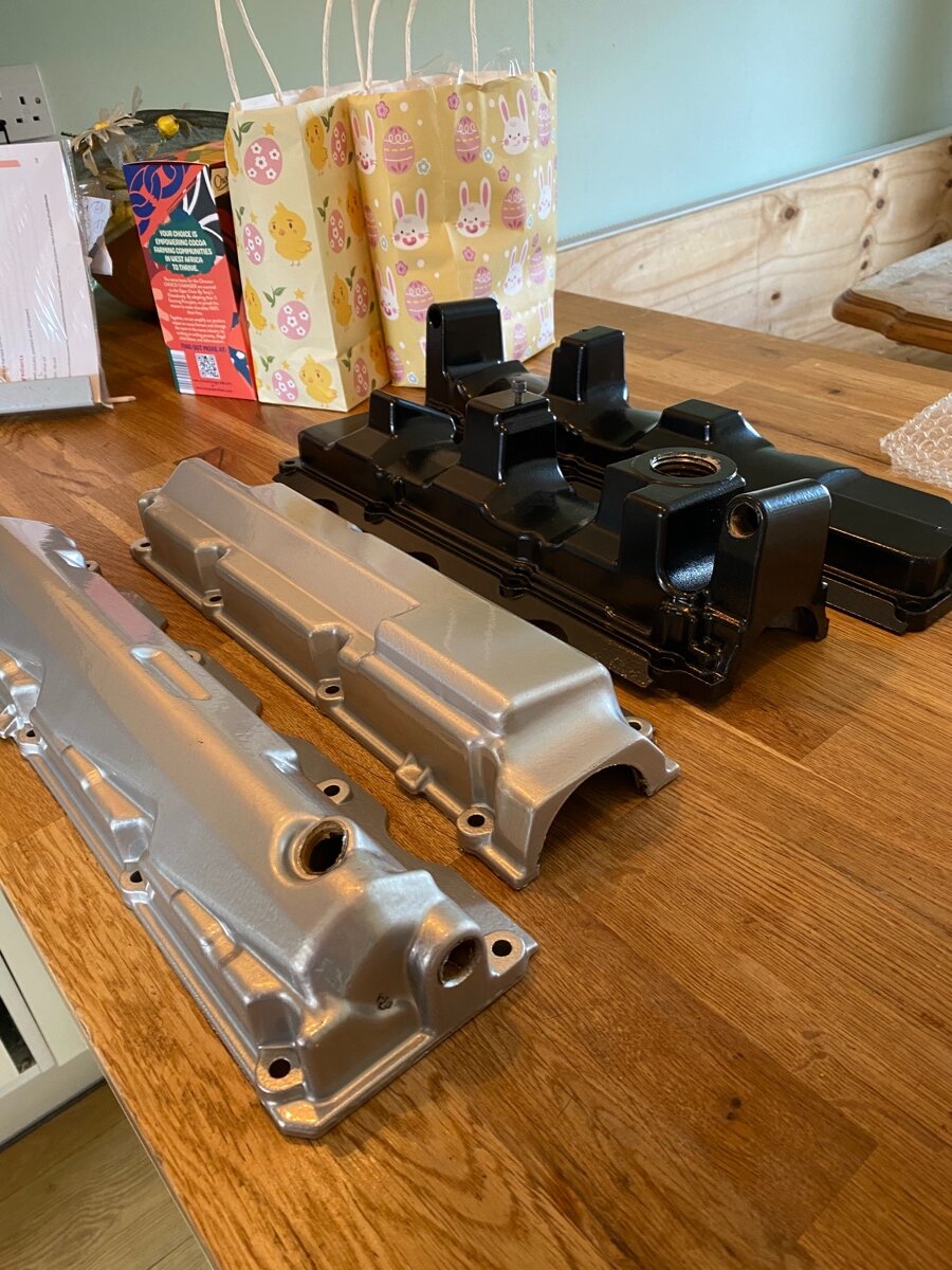

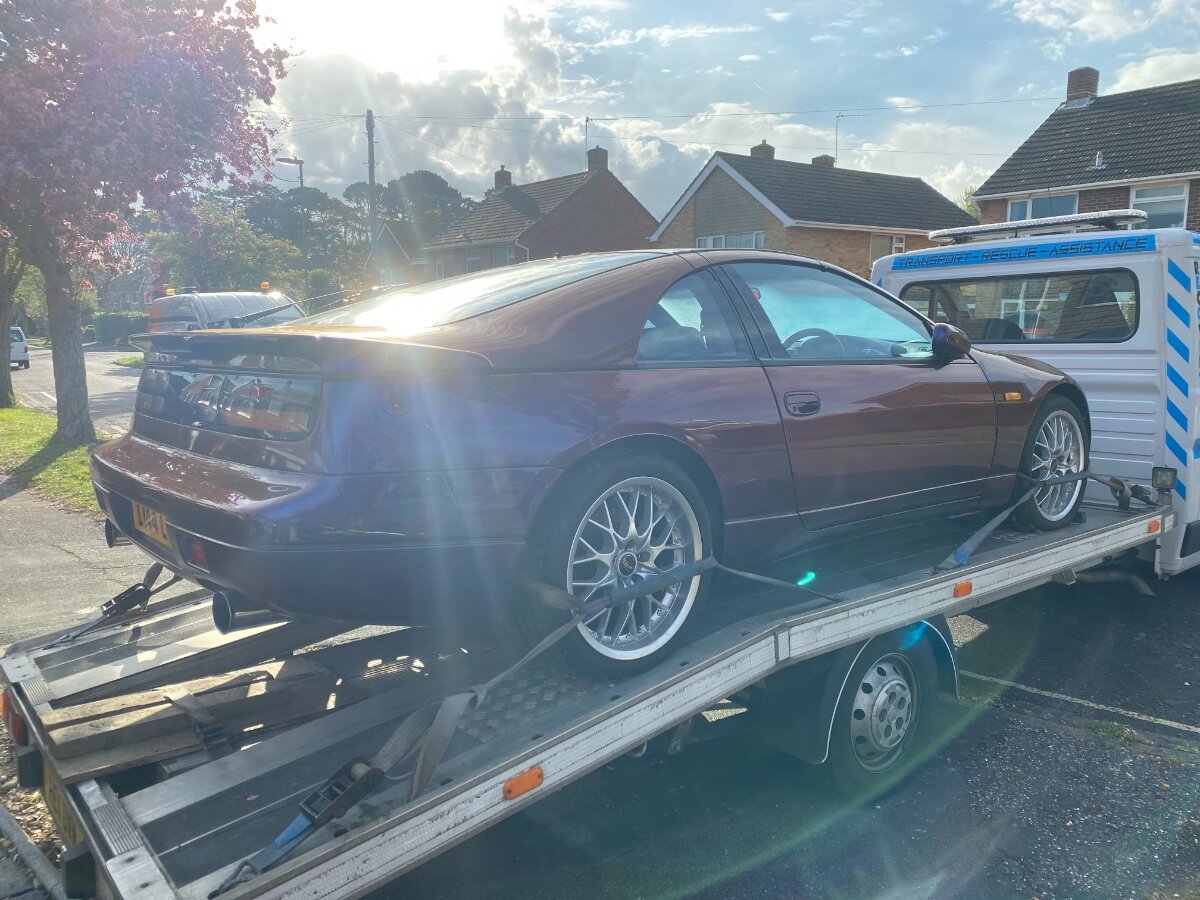

Managed to get a spare set of cam covers powder coated just in time. Then 10 minutes later she was getting loaded up and shipped to Jim.
I can’t wait to get her back!
