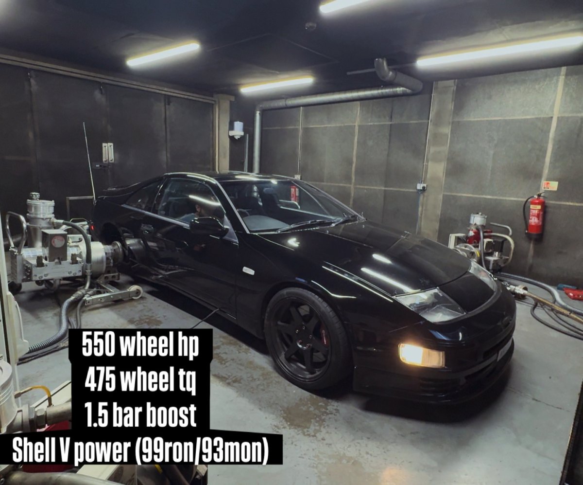

  2. What a journey it’s been. Yesterday, 4 years and 362 days since the terminal engine failure of my EPR “built” VG30DETT, my Z was back on the dyno. I’m happy to report the engine that I specced, prepped and assembled survived and took everything that was thrown at it, with oil pressure being reported as “fantastic”. For a “hobbyist” I should be proud. But I didn’t get the dump of dopamine I was expecting at the conclusion of the day, that rush of “I did it”. Instead I got the cold sweat of dread when Romain of RaceCal Ltd came off the dyno to debrief me. Fundamentally, everything is fine and the Z has a solid tune, but not without issue…. and I think it’s that very BUT that has taken the sheen off was a good day. Firstly, the engine has a fuelling imbalance between banks that shifts dependant on load. I have a vague recollection that I’ve had this problem before and never got to the bottom of it. That in combination with an issue with one of the hub dyno’s having a peculiar loading issue, brought about the conclusion of the day in the interests of safety. And I’m completely content with that decision! A few other minor issues including a small oil leak that needs to be found as well as the curse of the ATi damper PS belt issue, meaning a 85 mile drive home with no PS. I think the final factor in my overall post dyno emotions are that I thought i had everything in place to get the optimum output for this setup….. and I don’t. I need to invest time in making proper intercooler ducting to get that IAT recovery and efficiency to be able to make back to back runs. I need to add a second fuel pump to give me more head room to allow the potential maximise the 2860 turbos. I need to find the cause of this imbalance to remove any risk of misfuelling so that tune can be absolutely bang on to really optimise this setup. So, the journey isn’t over yet….. more work, more learning, more money 😂😂😂. Just a quick one to say thanks. Thanks to Romain of RaceCal Ltd for his time, for his ability to recognise my level of understanding and communicate to me where I can solve issues and make improvements. I look forward to working with you again! #vg30dett #z32 #300zx (And depending on your chosen calculation, that’s 640 hp and 550 lbs ft at the flywheel, roughly)

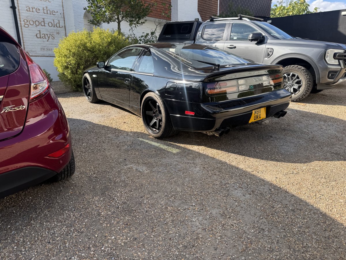

  4. Had a great couple of days with the Z. Gave her its first wash in years to get rid of all the dust that had gathered on her. Then took her on its maiden voyage over to East Sussex/Kent borders for a close friends wedding. Was a nice 200 mile round trip to . Apart from fuel economy (which has yet to be tuned), it performed faultlessly! Deffo need to further exhaust work to kill horrendous drone between 2-3k rpm, but I can’t express how nice it was cruising through the southern English countryside on a sunny day with the roof off. It just reminded me how much I love this car

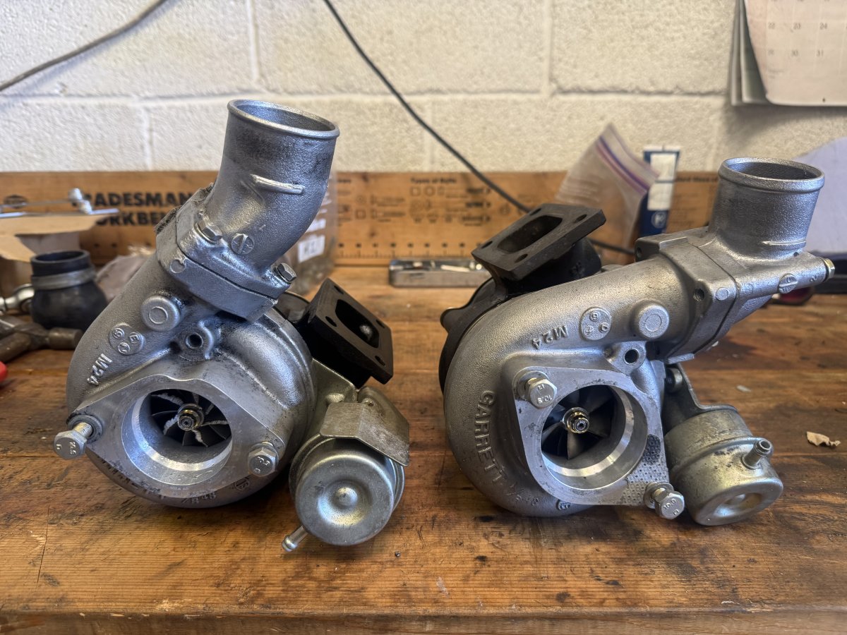

  10. Ok, so a bit of a photo dump. plenty of progress recently, and I think the engine is pretty much ready to go back into the bay.
  11. Reduced to £550

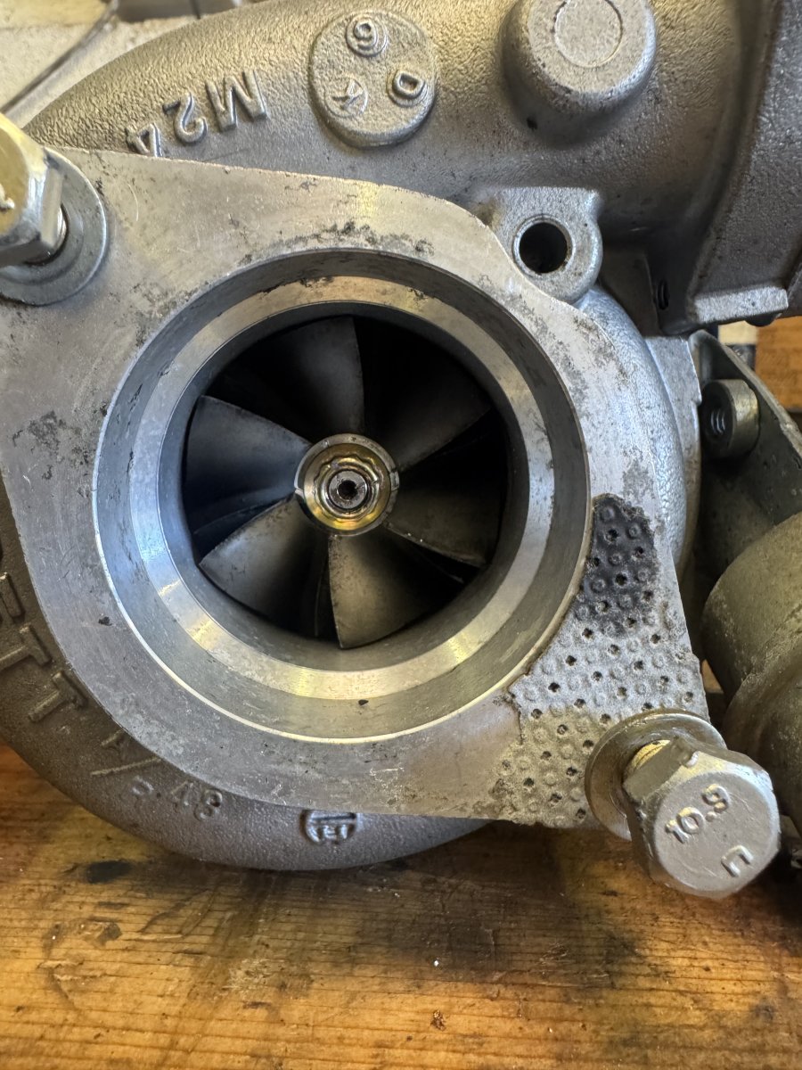

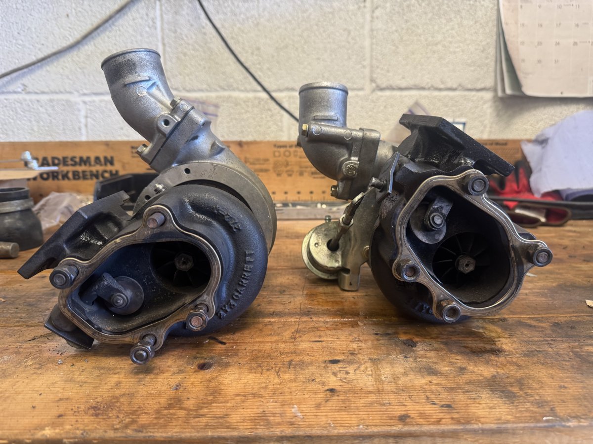

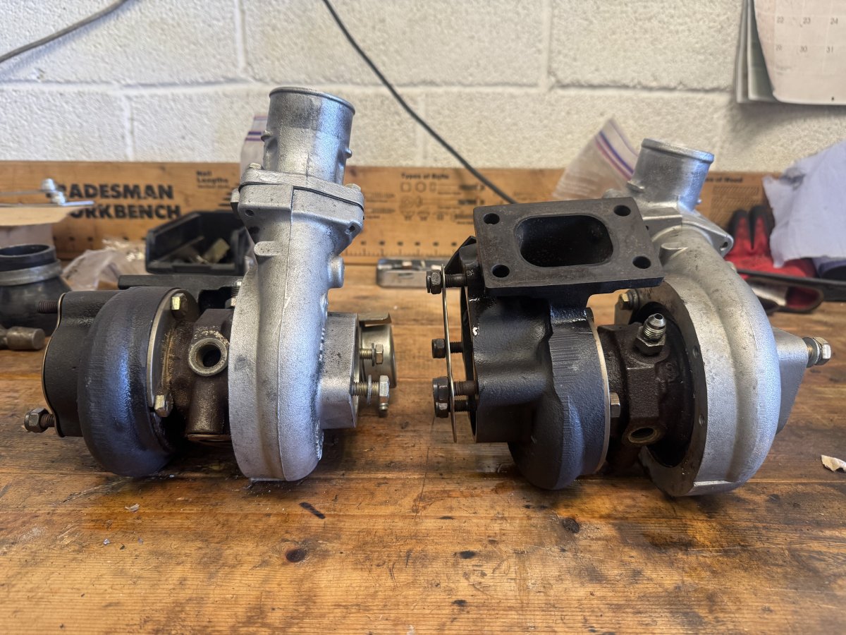

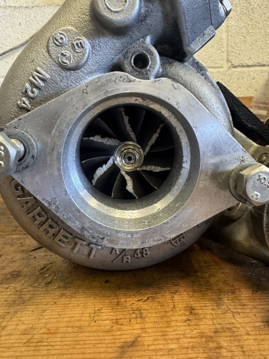

  12. Used pair of Z1 motorsport GT525 0.54 A/R turbo chargers (4 bolt downpipes) for Z32 generation Nissan 300zx. These turbos made 519 WHEEL horsepower at 22psi in their current condition on my Z. Ceramic coated turbine housings, with ported wastegates. No broken studs One compressor wheel has been damaged by a rogue washer, however new CHRA’s are available from Z1 motorsport for $600. The turbo with no damage has acceptable radial play and zero axial play. Replacing the damaged would result in 2 perfect health turbos for the fraction of the cost of new. Will work with OEM turbo oil feed and coolant lines Neither turbo smoked when running. 11psi wastegates Packing and postage not included £650 ono
