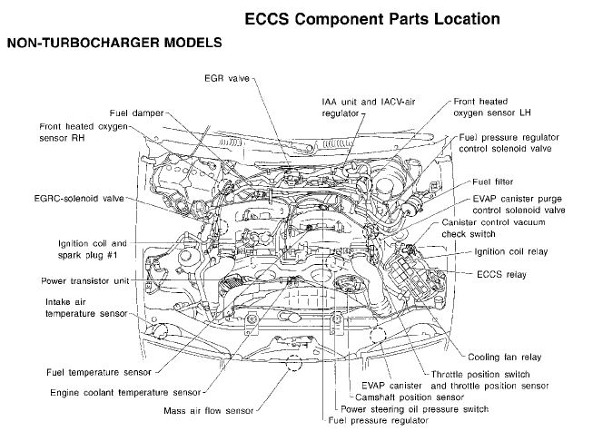

  9. update 5: at idle, lambda is 1.4 (v lean) and fuel pressure 35psi. Then, as nickz32 mentions, took the hose off and it went to about 43. Then used a pump to add a bit of overpressure and got it to 45psi with a lambda of 1.089. Fuel filter changed May 18. No vac leaks that he can see / hear. Voltage not yet checked. The diagnostic thing is a Launch X431. This has tested the IACV valve through 0% - 20% - 80% and then back to 0%. Coolant temp 89C MAF voltage at 1,900 1.4V, at wide open 3.5V When the revs stumble at idle, lambda goes high (lean), O2 sensors react, ECU widens injector pulse from 2.5ms to 3ms, revs recover, after a few secs goes lean and stumbles and round we go. One of the tests says Bank 1 is lean, another says LH bank has better emissions (i.e. better mixture) than RH bank. Is Bank 1 the RH bank? I'm told the usual thing it that Bank 1 is the one with cylinder 1 which, since Cyl 1 is on the RH (facing forward) would mean Bank 1 is RH bank. One of the O2 sensors switches at half the rate of the other. I've asked which is which and at what speed. Simon is going to go through all the data he's found over the past few days and I'll post the key points later. I'll go up there at the weekend and see if I can get my ConZult working and compare notes. So any pointers as to specific tests or readings or thing to look for will be gratefully received. I'll try to take some vids as well. Thanks for your help, guys - being on an island, it's not easy to drop by one of "our" known specialists so all this is very helpful. Ta :thumbup:
  10. Thanks nickz32 - he said he did it with his kit but I'll ask the q when we speak later and I pass on your tips. There was a leak on the fuel damper > balance pipe tube but fixed that. @ Joely P thanks, will try to do that when I go up there.
  11. update 4: The "stumble every 20s" happens higher up the rev range as well not just at idle, noticed this when warming up for tests. TPS / hard switch set and checked. MAF reads up to 3.5 at rpm. IACV valve operates OK when checked directly. O2 sensors switch rich/lean about every 3s (believe it should be every 2?). The only thing that seems to cure is when he sets higher fuel pressure with his scan tool. He's going to stick the scope directly on various things and also measure voltages directly - MAF, O2, injectors. Any suggestions? He thinks - as JeffTT does, it's ECU compensating for something, the revs recover, then the ECU returns to base and the problem recurs. Then round we go again.. Thanks.
  12. update 3: what's this unknown tube? Looking around for damaged vacuum hose, Simon found this tube under the RH inlet manifold which exits at rear of manifold. Appears to be redundant. Is it? PS thanks nickz32, will pass that on and ask.
  13. update 2. Further digging around shows: there's no EGR control valve there's no AIV control valve solenoid the TPS seems to be good the IACV/AAC is at 56% so that's too high. Simon reckons this is trying to compensate for a vacuum leak somewhere and wants to take the manifold off to inspect and test the IACV/AAC to see it can operate through full range. Before that will check / clean throttle bodies. Any other pointers? BTW I noticed in the 1996 manual (US market) that doesn't show AIV solenoid but does show the EGR. Does anyone know if the 99 NA should / shouldn't have these? Thanks
  14. Update. Tech bloke says his diagnostic thing doesn't show any issues higher up the rev range so, as mentioned here, IACV is next on the list to check. I've asked him to recheck TPS/hard idle as well. What he saw on Sat is that, at idle, the mixture goes lean (more on bank 1), the revs drop, the ECU increases pulse width to compensate, the O2 sensors see the mixture going richer, revs rise back to 750 or so, idles smoothly then mixture goes off again and round it goes again. More tests later today. Cheers.

  22. A couple of questions prompted by a couple of AndrewG's posts https://www.300zx.co.uk/forums/showthread.php?190273-A-great-way-to-spend-a-Sunday-morning&p=1988126&viewfull=1#post1988126 and his link to http://gtr-registry.com/en-nissan-300zx-z32.php 1. FAST gives the production date of my Z as 9904. Is there a way to get it even more precise - to week or day? It seems it's got a birthday coming up so want to give it the card at the right time :D 2. It's a shame the GTR Registry link doesn't cover JDM production. Is there any reference to when Series 6 production started (and how many were made, when)? I guess I could manually step back through VINs but that would be a tad tiresome. The factory announcement was made 7 Oct 1998 but refers to "release" so I don't know if that means they'd already made some or were starting to make them. https://newsroom.nissan-global.com/releases/release-622e2183c9ca29da3ef1a7b00701c437-fairlady-z-undergoes-minor-model-change?query=300zx Assuming the Oct 98 date is production start and production was even throughout the year, that means they made a grand total of 828 Series 6.
