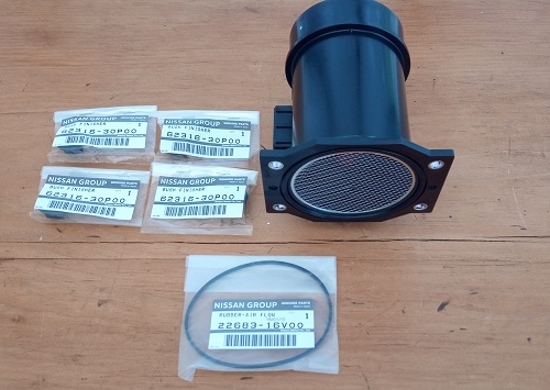

  11. Today I changed the MAF and, short answer, she now starts and idles and the stumble has gone. It might be this whole thing was a MAF on the way out. Many things learnt thanks to the help on this thread. 2 things stand out for me on MAF: the test isn’t unplug the MAF sensor while the engine’s running. The test is stop the engine, unplug the MAF and see if it will start / idle. If I’d done that days ago, could have spotted dodgy MAF earlier! the voltage on the new MAF seems in the same range (more stable) as on the dodgy one at idle before it failed completely. So it looks like voltage isn’t the only diagnostic for a MAF on the way out. First start up after replacing MAF [video=youtube_share;0PbLyQUg5aE] After 20 min test drive [video=youtube_share;T29CXcxmPr0] I still need to do a full ConZult and check against JeffTT’s figures to be on the safe side. But you can see the AAC is a lot better than it was. Thanks to Joely P for pointing me in the right direction for airbox stuff. Might even replace my own air filters next time… Had some trouble fitting the O-ring before I noticed the new MAF already came with one fitted d'oh. Old and new MAFs. Someone’s clearly been a bit heavy with levering the hose off – and I wonder if debris from that might have damaged the MAF. New Bosch 13091 O2 sensors to be fitted next week. Also proper NGK PFR6B-11 Given this is the first time I’ve ever taken a spanner to my Z for anything mechanical, I’m somewhat relieved the only casualty is a 10mm socket somewhere down on the engine tray where I can’t see it. Thanks to you all for your help and advice – wouldn’t have had the courage otherwise.

  20. Looks like the MAF is now u/s as of yesterday. Thanks to Joely P, I summoned the courage to approach the Z with a socket. (I am now short of a 10mm socket and extension as I dropped it into the engine bay – which is why I should never be allowed anywhere near an engine bay). Apologies to Jimmer and DJ Party Favor as I misunderstood their suggestions on MAF test. I’ve done that now and it will start and idle with the MAF unplugged. It will start but then die with the MAF connected. MAF connected: start then die. MAF unconnected, idles: The error codes also point to this. I cleared them and restarted to check and Code 12 Mass Air Flow Sensor reappeared. I’ve waved WD40 at the connector and plugged / unplugged a few times to clean. No change. I take it the arrowed brown bit on the harness doesn’t disconnect from the arrowed black bit? That’ll be a dead MAF, I take it (unless a harness issue somewhere). I wonder if that was the cause all along: MAF sensor on the way out, causes idle issues, then fails completely. I guess the only way to test that is replace the MAF sensor and look again. Start with MAF connected: [video=youtube_share;LvLa42LUiS4] Start without MAF connected: [video=youtube_share;-bxaXdlhr7k] Other things I noticed were cable ties instead of fixing the hose clamp, some missing bolts and worn grommets on the nose panel – also cracked scuttle where the RAC replaced the battery. Humph. Just more things on the list which every Z owner knows only too well! Thanks to everyone who's helped - if I get there in the end, it will only be thanks to you.
  21. Yep, Captain Stock, that's me :) Thanks for that guide. So the MAF is bolted to the airbox cover- follow that guide until the airbox cover removal, then unbolt the MAF from the cover - is that right? I just checked and have now got Code 12 Air Flow Sensor which I've never had before. Oh well...
  22. Is there a how to replace MAF guide anywhere? I've tried search here, Twinturbo.net and the Aus forum but haven't found one. Yesterday, she ran worse than ever (OK the day before apart from the idle) and wouldn't go over 40. MAF voltage appeared to be 0.010V so it or the connector on the way out, I guess. Being useless at tech, I daren't try anything without a guide! Thanks.
