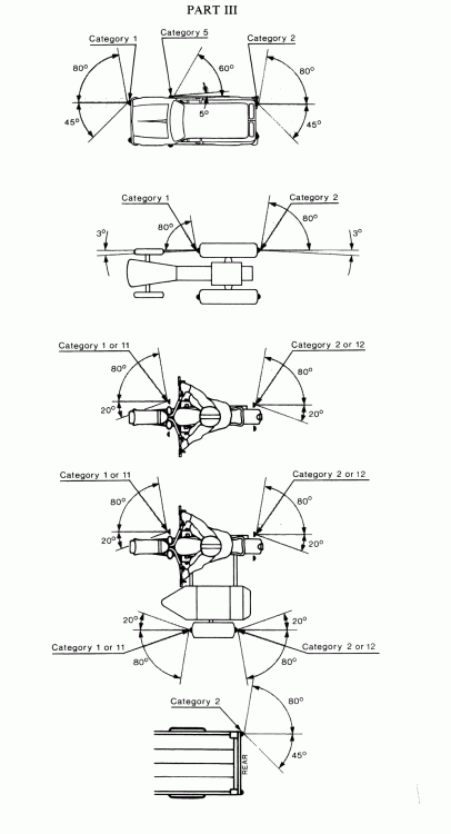

  14. Side repeaters must be seen within a certain angle so flush might be difficult: http://www.legislation.gov.uk/uksi/1989/1796/schedule/7/made 3. Angles of visibility– (a) A motor vehicle first used on or after 1st April 1986 and a trailer manufactured on or after 1st October 1985– (i) Horizontal (see diagrams in Part III of this Schedule)– (A) A front or rear indicator fitted to a motor vehicle, other than a solo motor bicycle or a motor bicycle combination, having a maximum speed exceeding 25 mph and every rear indicator fitted to a trailer: .80° outwards and 45° inwards (B) A front or rear indicator fitted to a solo motor bicycle or a motor bicycle combination: .80° outwards and 20° inwards © A front or rear indicator fitted to a motor vehicle, other than a solo motor bicycle or a motor bicycle combination, having a maximum speed not exceeding 25 mph: .80° outwards and 3° inwards (D) A side repeater indicator fitted to a motor vehicle or a trailer: .Between rearward angles of 5° outboard and 60° outboard or, in the case of a motor vehicle having a maximum speed not exceeding 25 mph where it is impracticable to comply with the 5° angle, this may be replaced by 10°. (there are vertical requirements also.)
