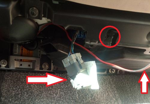

  20. Noticed a bit of gaffer tape in the passenger footwell, had a look under the trim to find (along with more gaffer (now removed) securing the replacement speaker wire): Relay gaffer taped to back of trim. What is it and where should it be secured? The arrowed air vent wobbled. In part because the screw (circled) wasn't tight. Tightened it. But the other end of the vent is still wobbly. I compared with the one in driver footwell which is nice and solid. I can't feel anywhere another screw or fixing should be. My next guess is to take the thing out entirely and have a closer look - what should I be looking for? Is that the only screw securing it or is there/should there be something else? Ta.
