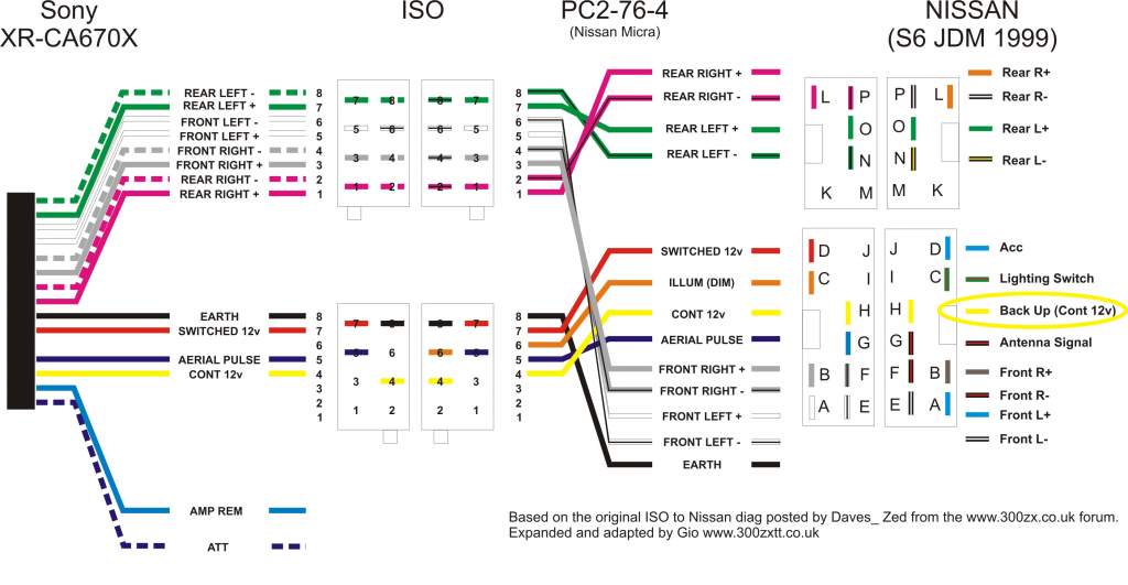

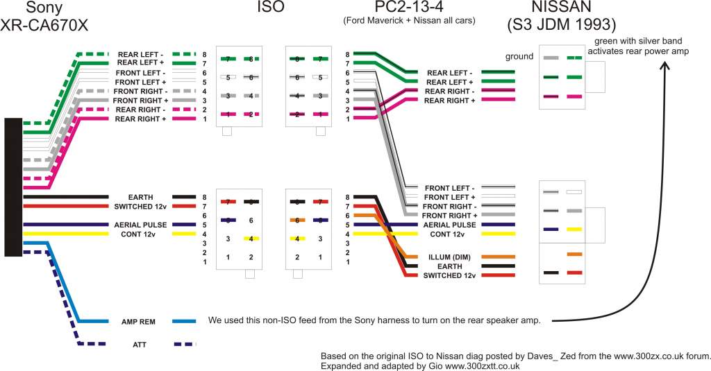

https://www.300zxtt.co.uk/techaudio.html I'll fix the pics later so here they are for now:
Series 3 JDM 93
Series 6 JDM 99

You can say that again! Attempting to bypass the power amp in the boot and the colours shown for speaker wiring in the manual are a work of fiction. No resemblance at all to what’s in my 96 car, and the only amp it shows is a Bose, mine’s a Clarion (but clearly factory fit). Will have to pull out the multimeter for this, unless there’s a diagram with the 96 audio wiring out there somewhere?
Try this one. It is for the UK/Euro spec non bose system which had a Clarion amp in the boot like yours.
EL-93.pdf
AndrewG you, sir, are a hero! Matches 100% with the fuzzy pictures I took under the dash and trim panels on Sunday, even though mine is a JDM. Thanks!
