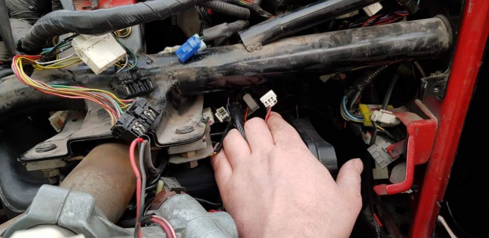

  1. Thanks Lee. Is it the little white sensors that go into the plastic air ducking? There's a couple of them in place already and plugged in (because I thought it was them at first too). As for where the wiring sits next the the steering column, could you send me a photo of how it Looks? It probably just in the wrong spot.
  2. Morning mate. This is my black car. The car was a series 2 and loom was moved over. So the cruise etc is in the steering wheel. Looks like the normal connections as far as I remember... unless I'm being daft which is entirely plausible

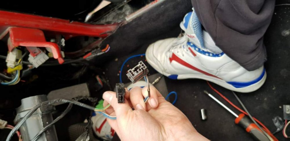

  3. Anyone know what these are for? The black ones seem to be in with the heating ducts wires, or nearby anyway, but can't see anywhere they'd plug into. The white one, is the right one I have hold of. Finally, there's a clutch switch. But there's no connector on my loom. I'm guessing this was due to it being a manual conversion in years gone by and that I don't need to care?

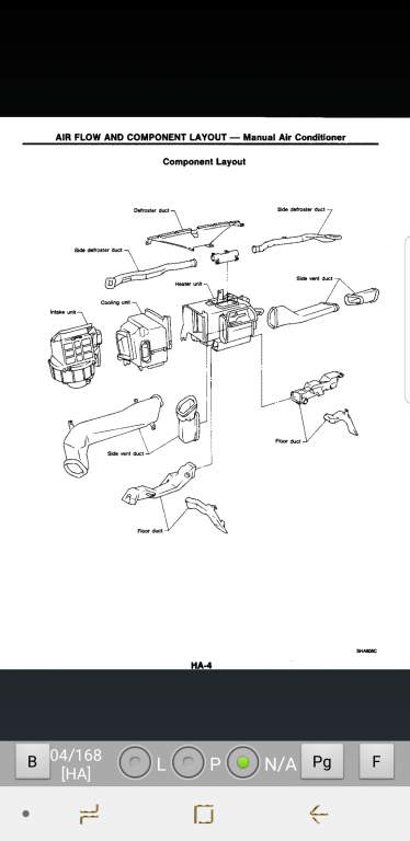

  5. Apart from the below photo, I'm wondering if anyone has a photo of all the heating pipework that sits behind the dash. And if possible, a list of the codes on them so I can see if I have it all
