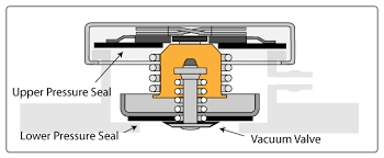

Andrew, can I ask a question on this... given that the radiator cap is sprung closed and the pressure moves it up to allow the water to pass into the overflow bottle, how does it then go back into the radiator when things cool down? I've never understood how this could possibly happen. So I'm genuinely curious about it.
This little video explains the recovery system:

Yes, the system is pressurised and if working (no other leaks) behaves as in the video above.

Thanks mate. So where's the vaccuum vent valve the opens to refil the radiator

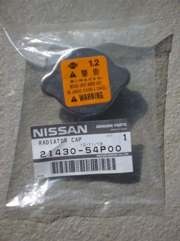

Like Andrew says, I don't have to regularly top up my coolant either - even with an aftermarket radiator; in my case, a Mishimoto. Just as you both say the secret is in the radiator cap - which arguably is the weakest link in the system - and is often overlooked! Even OEM Nissan ones have, on occasion, been faulty from point of supply. I know - I bought a brand new one from Nissan a few years back and suffered from coolant loss... Replacing it with another cured the problem!!

Is someone able to supply me with a good link I could buy a new Rad Cap from? Sounds a bit of a no brainer to change this as a starting point to me.
