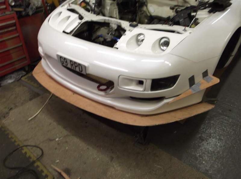

  12. Splitter.... Mk2. Less extreme. We think this is the one to go to ally with now. That should be fun:blink:
  13. As always Im listening to those who have relevant experience. The honest answer is... I dont know. Bob and me have no previous experience in this area. We have looked at other Time Attack cars and done some further internet research. I "think" it needs to be thin to split the air smoothly. Its not a spoiler. We are going to do this first one in the ally sheet we already have. Then we need to see if it feels good in testing. If so Bob has a contact for re doing one in Kevlar. If not then it will be back to the drawing board early next year. As said already Bob is picking the car up next weekend so I haven't a lot of time left to tidy up and finish off the work in hand.

  18. Well here is another item in development that wont be to many peoples taste/liking!!:huh: So this is the first prototype....:biggrin: Shape/size etc NOT final yet. The final item will be in ally NOT plywood:innocent: I wont use gaffa tape to fit the finished item!:no: Its not pedestrian safe/friendly but the car doesnt get driven on the road nowadays so its fine. Fitting some edging temporary will get it thru an MOT... or just unbolt it.It will all be easily removable single handed for mainteance/emergency pit access. Will it work??? Well 90% of the Time Attack cars have similar items fitted and I have spent a lot of time in the paddock photographing them for reference. Its a splitter. It divides the air so that on top goes thru to the rad. The pressure on top is greater than the pressure of the air flowing under. The flat smooth plate goes all the way back to the engine crossmember So just one pic. And remember Im just lurking waiting to time attack anyone who says they dont like it:glare::glare::glare: pic................................... Im only kidding ... feel free to comment..........................:yes:.

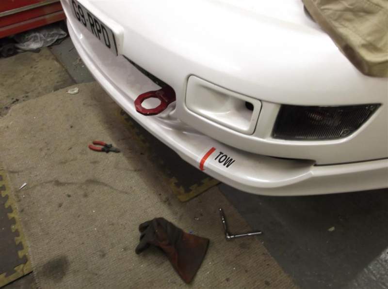

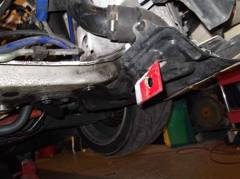

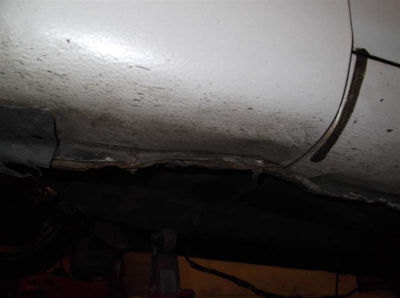

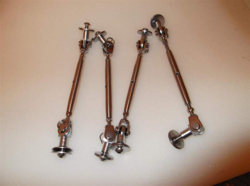

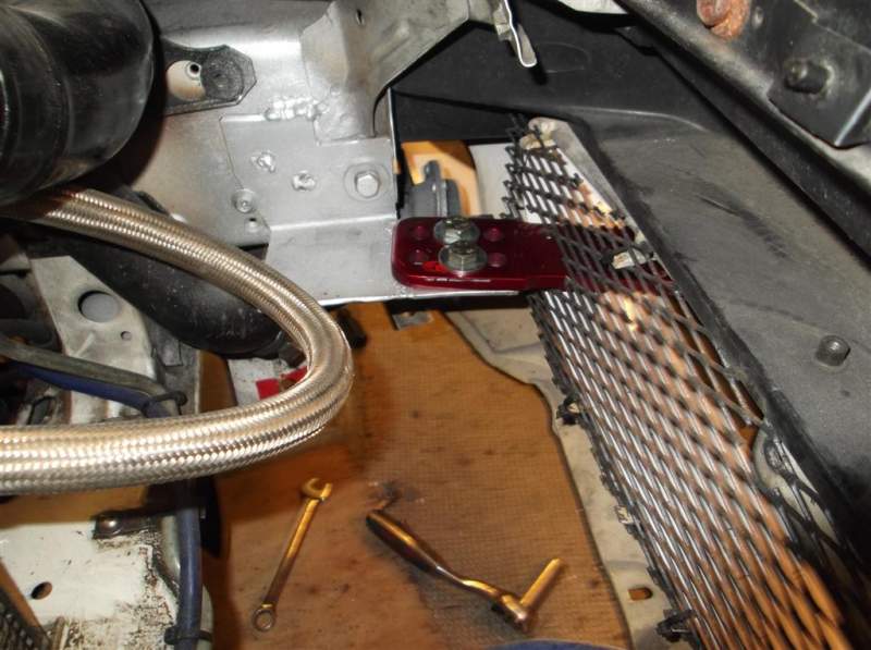

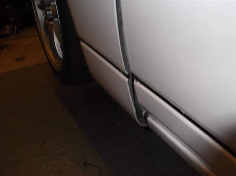

  20. Well I will start tonights post on a high note................. The adjustable rods for the splitter arrived promptly. They are very nice indeed and should/will do the job.:clap: Things then go downhill As Bob lives so far from me many jobs get done "elsewhere" Now thats fine IF done properly. Here is one that wasnt.. The front tow eye.:huh: Located UNDER the car. UNSEEN and with a tiny eye hole. Just not good enough IMO.:no: So I now have the proper towing eye and Im locating it where any emergency trackside tow truck can see it and get to it quickly. more importantly when they pull on it the rope wont rip off the bumper.:glare: It really makes me mad. Its just as easy to do it right as wrong. What is even more annoying is that Bob will have paid good money for a poor job and now I have an extra job to put it right. And also.................................................... When Bob brought me the car a few weeks ago I noticed the previously immaculate fitted wings were.,. a little out of shape.:blink: Jacking the car up today reveals the full (horror) story....Car has been jacked up by trolley jack UNDER THE FRONT WINGS.:hammer: The wing edges and sill edge behind are mullered. MORE work now for me to put it back to its former glory. Im not happy...... at all:taz: Now where is that bottle of Rioja I bought earlier. I need a drink:sweatdrop:
