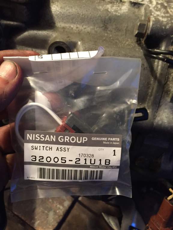

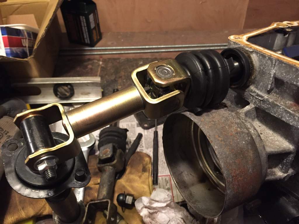

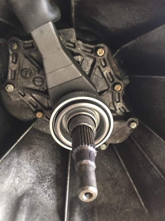

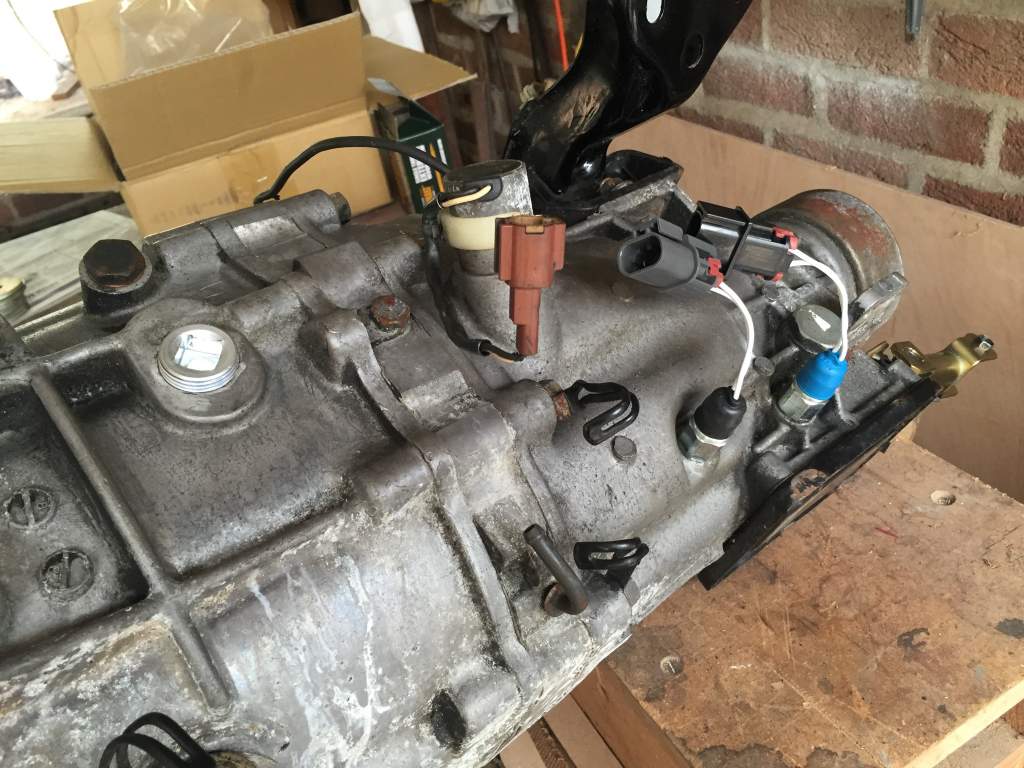

  1. I then ran into a problem as I had not ordered a set of new studs and the old ones would not come out without breaking. Nissan use high temp studs (inconel I think) and using standard grade fasteners is a sure way of having to take the engine back out again to replace blown gaskets. In the mean time I got on with a gearbox external overhaul. New switches Later spec 350z clutch arm and pivot ball along with a new clutch release bearing and carrier. I also fabricated a new gear leaver support that directly mounts to the box (similar to the bde item). I didn't get any photos of this though. I also added some phosphor bronze sifter bearings, however I was a little surprised to see that the pivot on the bolt which is very bad practice. I managed to bore them out on the lathe to use the original sleeve. I also rebuilt the shifter pivot ball with a czp kit and adjusted the pivot point to give a slightly reduced travel while still retaining the stock shifter. New selector arm Also managed to update my recircs with some bde goose honk killers

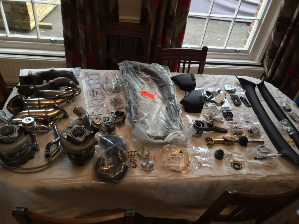

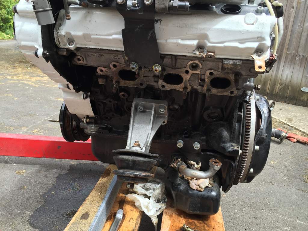

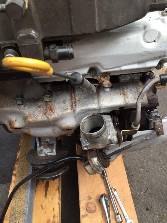

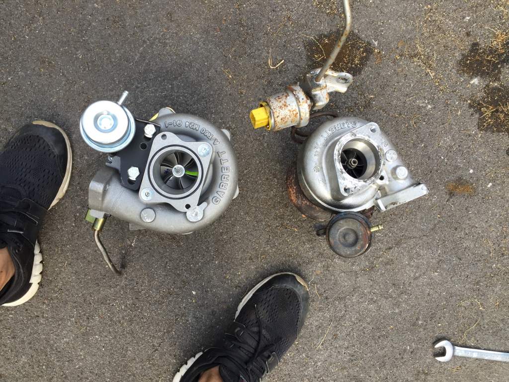

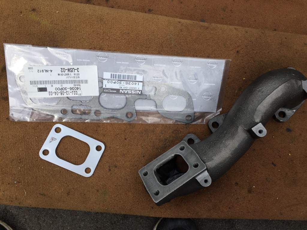

  2. First up, this is the collection of new parts I have been building up over the last few months The biggest job was to sort out what I suspected to be a smokey turbo, soon confirmed with the downpipe removed. First things first, pull the engine, which I didn't find too bad with all the simplifications I have done. Turbos stripped off New manifolds ready to go on And a comparison between the stock auto turbo and a brand new gt2560 (czp gt600)

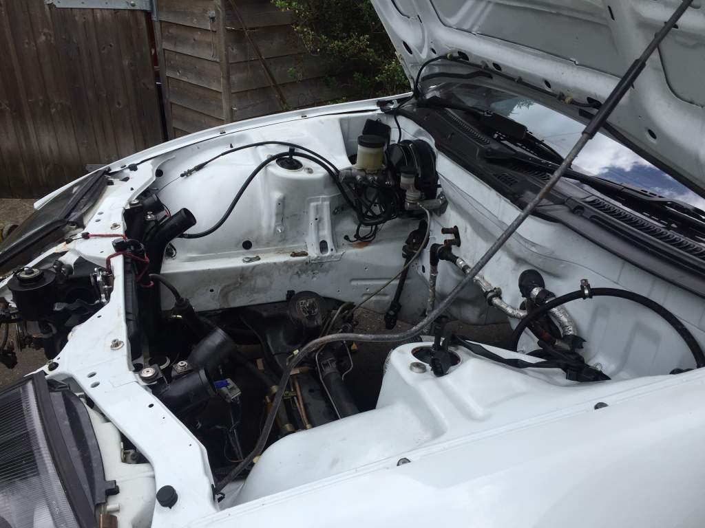

  3. As some of you may know I've been back at home for a few weeks to get some work done on the 300. I thought I would share some pics and info on my progress
