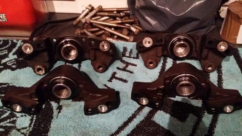

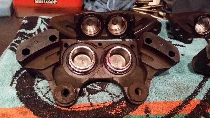

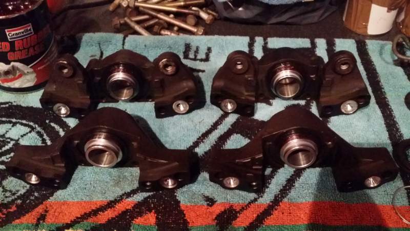

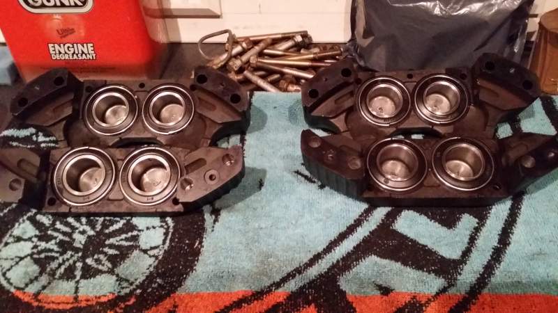

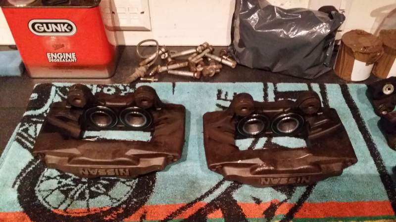

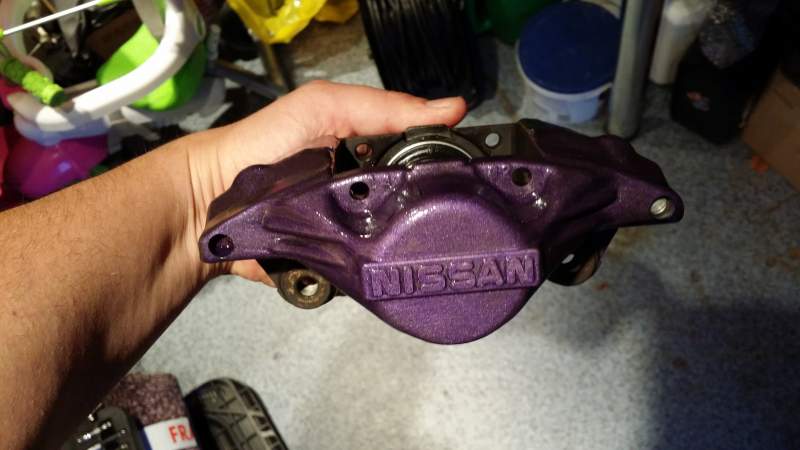

when i rebuild mine every one told me not to split them, cant remember the reason for this.
you are 100% right Dan...splitting these calipers is asking for trouble and theres no need anyway for a seal rebuild.Ive never ever known these split calipers to leak from the mating surfaces of the 2 halfs and the internal seal never fails too. Nice feeling having new piston seals as the brakes do actually work much much better for it:yes:
Nice job, going to be doing something like this myself... But I won't be splitting the calipers!!!:biggrin:

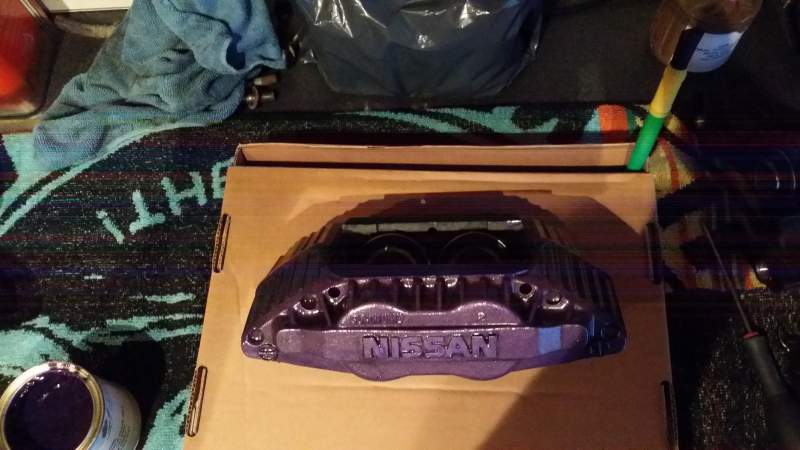

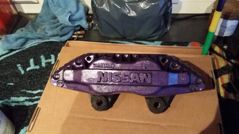

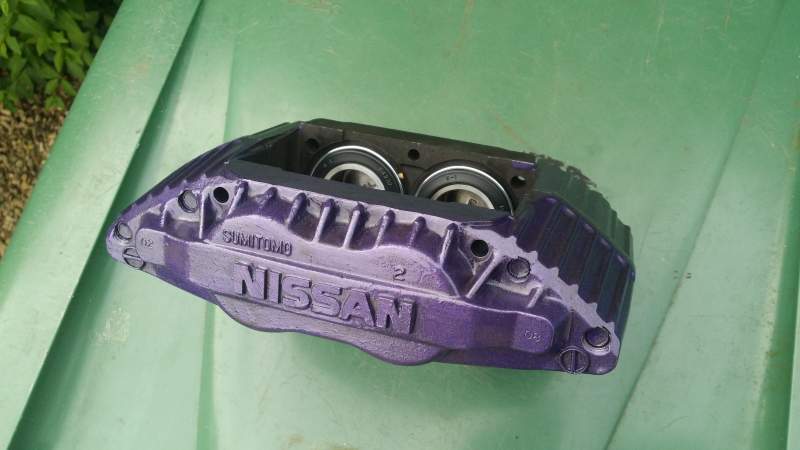

Back to the callipers and first coat of paint on the front its on.
The paint is fairly thin so i'm guessing a few coats then a top clear coat.
You only need enough of the color coat to get an even colour.
Use multiple layers of clear coat on top to give you sufficient protection.
If you could get them done in 2K clear rather than regular single pack rattle can lacquer then it will last longer
Instead of brushing them in a sideways motion, you could always 'stipple' them with the brush. You won't get brush strokes then.
TBH, getting the powdercoated isn't expensive if you wanted to go that route.
