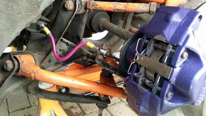

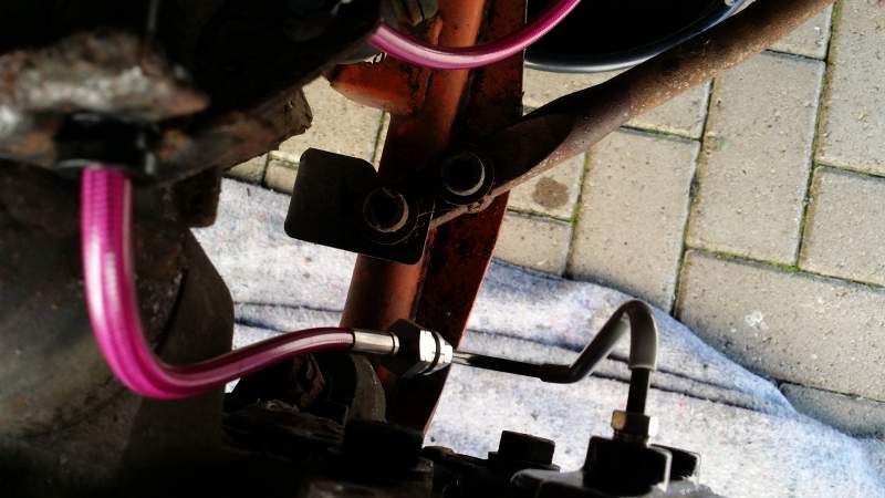

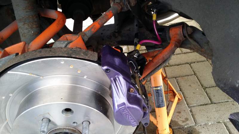

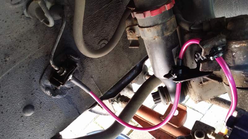

So with the help of a friend all my callipers and brake pipes have now been fitted if what a bit incorrectly on the rears.
I lost one of the brackets for the front right and ended up fitting everything without them as shown :
The good news is the wife found the bracket 10 minutes before packing up for the night so I plan to
have another bash at fitting them and bleeding the brakes again.
After fitting everything and following a guide on the order of bleed the pedal still feels very soft.
My zed has abs but I cant find any bleed nipples on it so how do I get the remaining air out if all
the brake lines to the wheels seem to have solid clear fluid in them ?
Also had issues with the small C clamps in that they are too large for my hoses so I've had to use
tie wraps to secure them at the top.
You've got the rear calipers on upside down mate. I did the same myself. Makes them a **** to bleed.

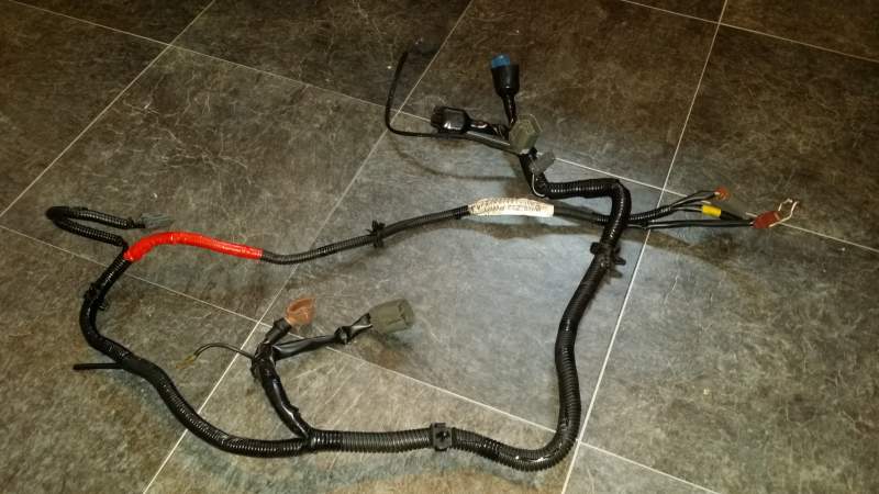

Going in reverse gear now with my build and after the issues with my speedo and reverse lights I decided
to strip down the starter cable and inspect the loom again going to the gearbox.
Below is what I thought my issue was but after doing various tested i'm sure the loom is working.

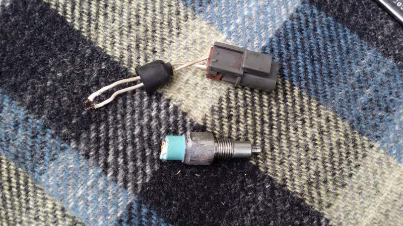

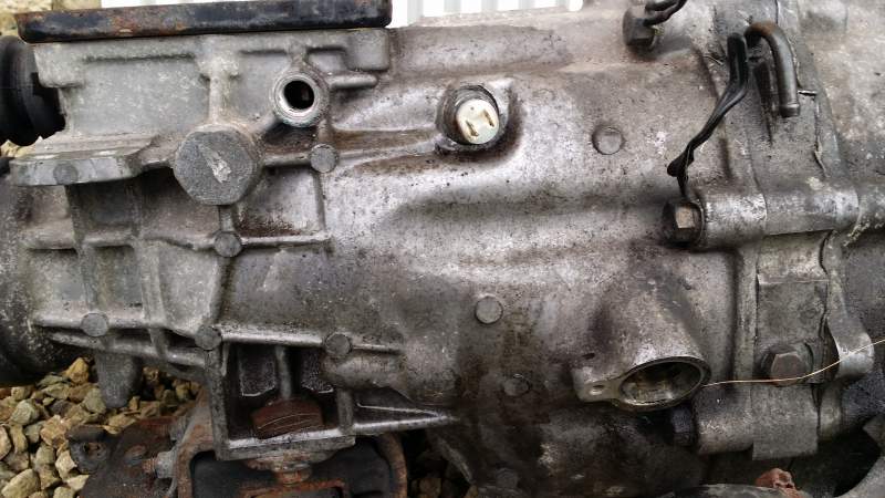

Next I move onto the sensors, namely the speed, neutral and reverse switch.

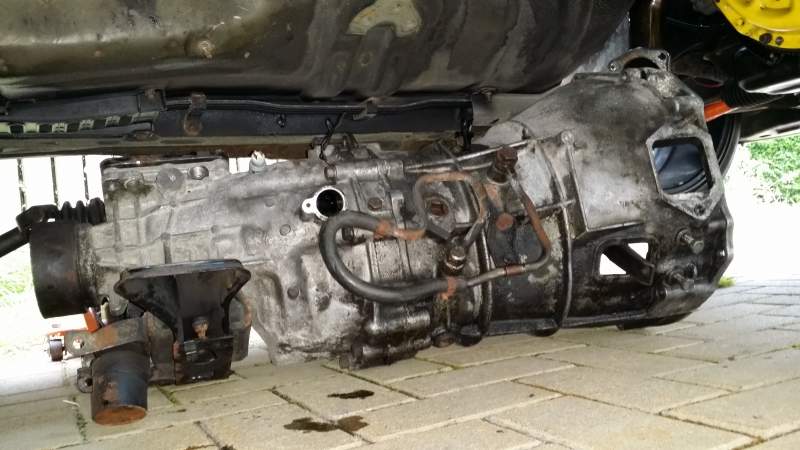

These are a complete bugger to get into and after getting a good light under the zed I realised that
the neutral switch and reverse light switch look fairly buggered.
Only fix was to get them out so I stripped everything off and dropped the box out the zed :)
To be honest this is the first time that I've removed the gearbox on my drive and by myself so it was interesting doing it.
This is the remains of part of the neutral switch and reverse switch.
Both ends were damaged and looks like they had been tugged at but not sure when.

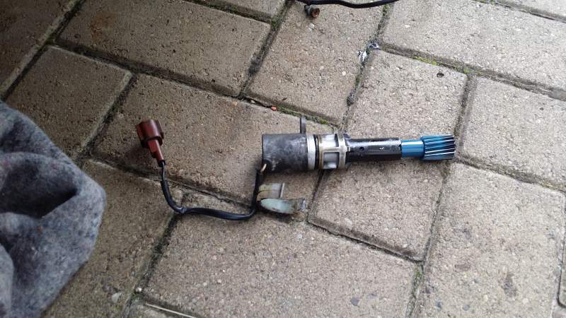

The other one is more than securely grafted to the gear box and i'm going to have to find some other way
of getting it off as the socket and spanners just spin on it now.
