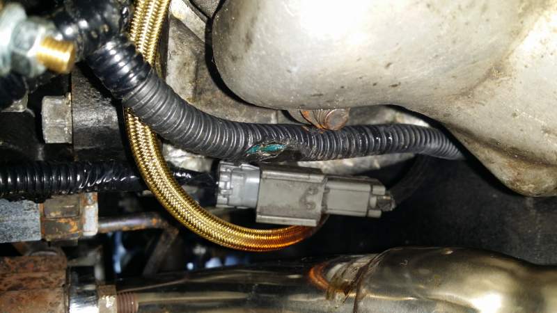

So today while changing the engine oil I also noticed this :
Not so good, the loom to the gearbox rubbed off the exhaust and melted the outer cover.
This may explain my reverse light issues but after connecting the cables in the engine bay
they still didn't come on.
Is there a fuse for the reverse lights ?
