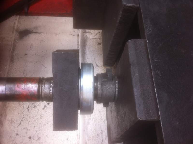

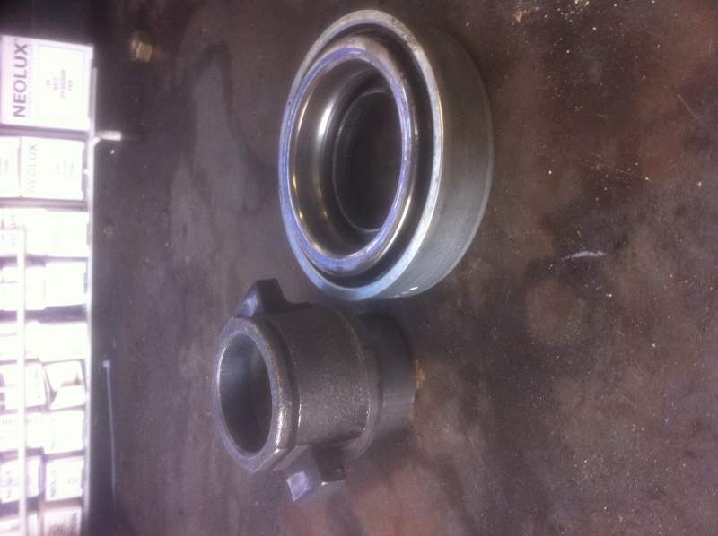

  7. Swapped clutch thrust bearing tonight, gearbox being swapped on Saturday, got all the nice new shiny parts now. Using a press and a socket here to press bearing carrier out of the thrust bearing Here is the bearing carrier and bearing separated Here I'm pressing the new thrust bearing onto the carrier, it's ok to press on bearing face as it is a thrust bearing and that's what it is designed to do and it's not a excessively tight fit so not much force required

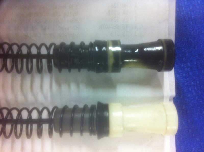

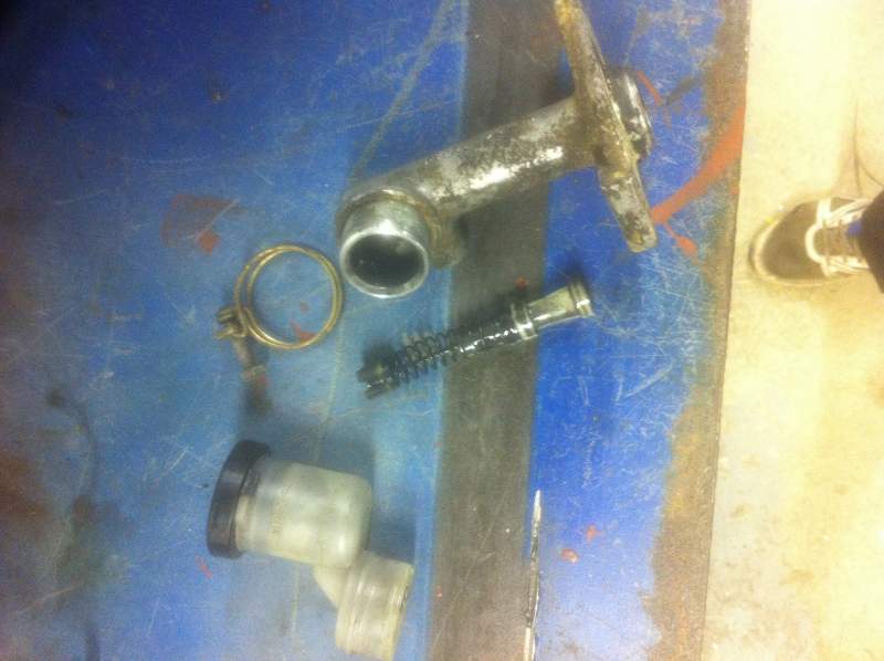

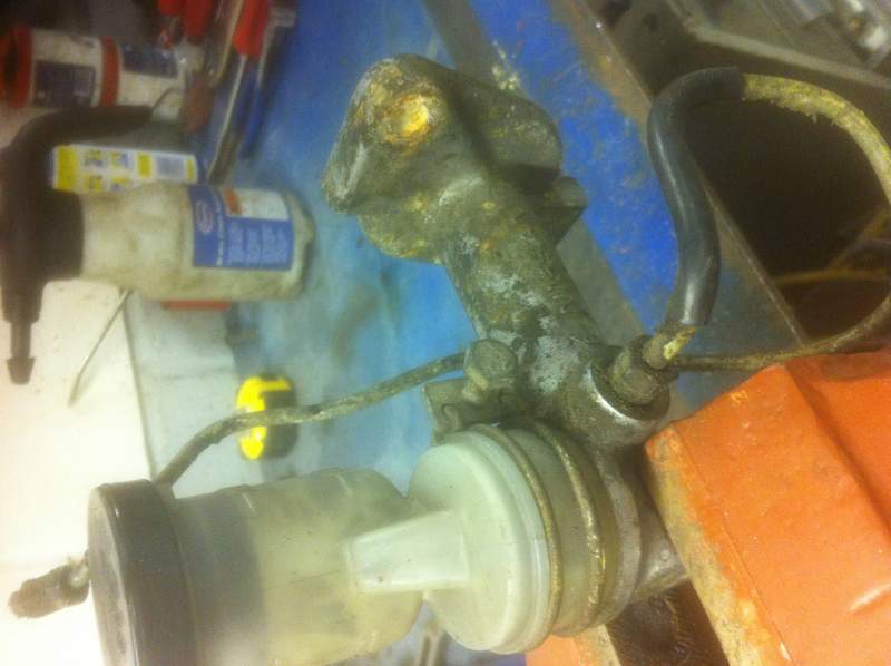

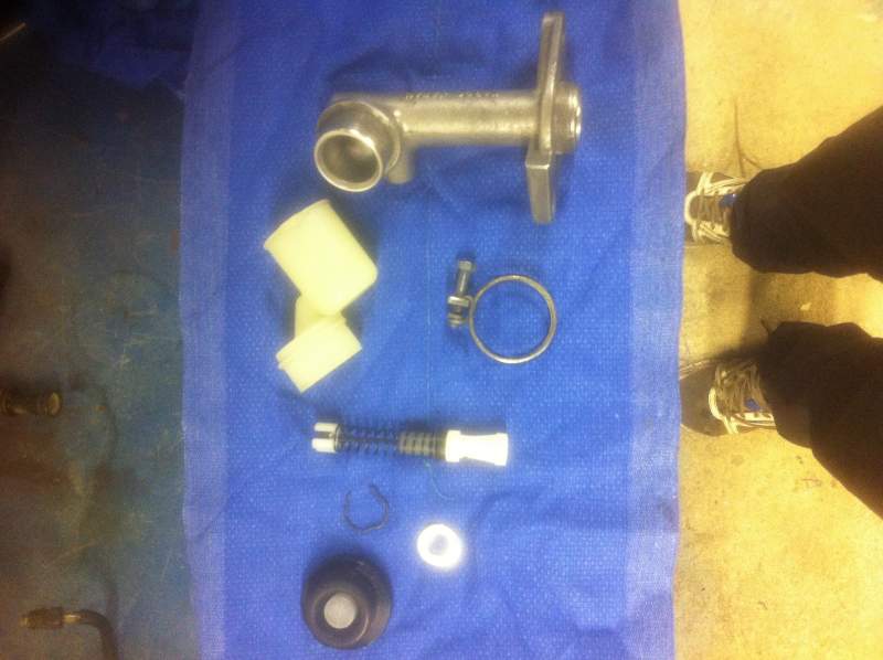

  8. Stripped and rebuilt clutch master cylinder tonight, very easy to do. See the difference in the new seal compared to old one! Should make for a good pedal.
