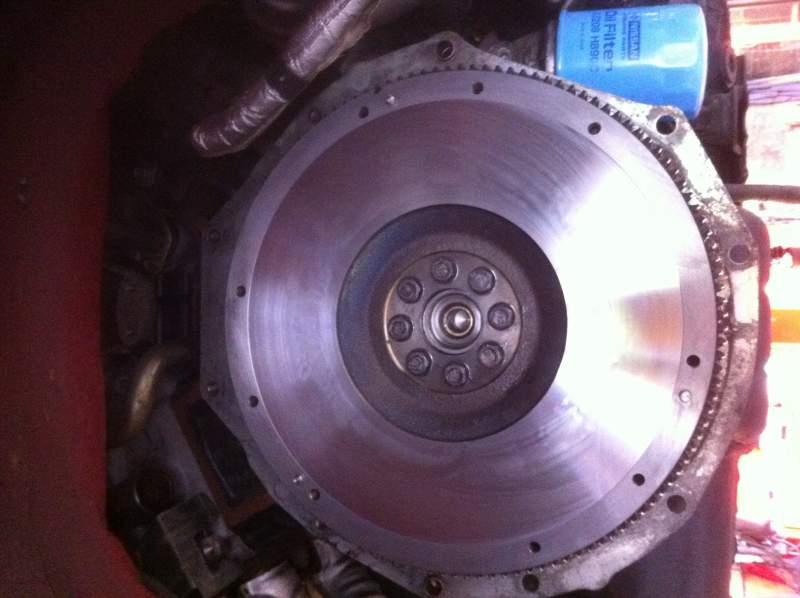

Newly machined stock flywheel, refaced with a ceramic cutter and 3 new clutch dowels fitted

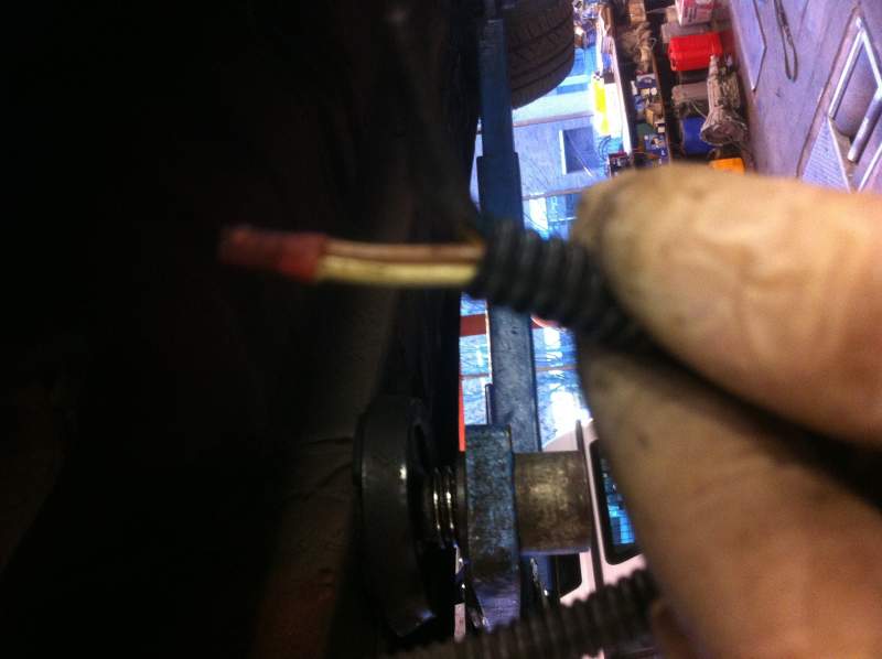

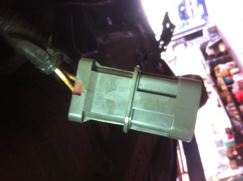

This plug is on the same loom as the speed sensor harness which is left behind when auto tranny is removed, all other wiring comes out with the tranny, by simply cutting off this plug and soldering wires together it removes starter inhibit associated with the auto tranny.
