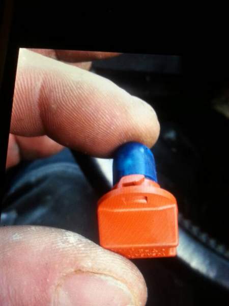

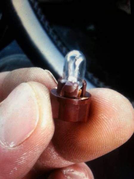

  16. Groover I can see the neo wedges fitting in the pods about 3 or 4 I think but there are bigger bulbs in the pods also. And there are 6 large bulbs in the clocks which dont look anything like the T10s on ebay Sent from my GT-I9300 using Tapatalk
  17. Ok on the pod the heater side id just like to light up that screen part as mine is pretty dim so I need x4 T10's . and the one for the pod which u say is a T5 neo wedge correct? Sent from my GT-I9300 using Tapatalk
  18. Thanks groover i take it ebay is the best option? Sent from my GT-I9300 using Tapatalk
