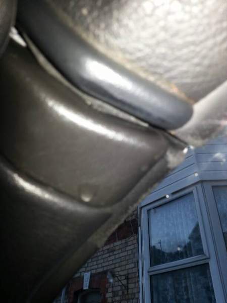

  6. Here this is drivers side see the drips Sent from my GT-I9300 using Tapatalk
  7. Hi, hope you've all had a great christmas, Ive posted this issue before and i just wanna make sure before i buy from MJP im not buying something i dont atually need. My car leaks from the targas although ive checked drainage and all seems fine its coming in from where the targa roof meets the A pillar and dripping on the bolsters nearest to the doors on both sides. i have replaced the actual roof rubbers which go around the top of the targa and down the door pillar but still doesnt make any difference. I was wondering if the actual targa part has a rubber seal? or is it that i need the actual rubber seal that goes round the top of the door? and down the A pillar? im hoping that i just have to replace the seal where it runns along the top of the window which is the targa? lol confusing or what
