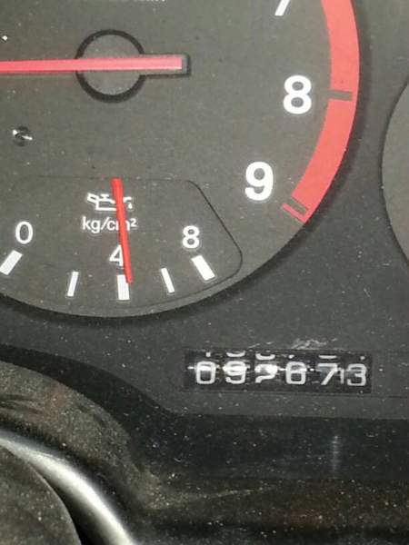

  10. Hi all. Just wanted to say thank you to Jeff TT for sorting the parts for me ;) . And all the rest of you that have helped me with my zed in the past few months. now she's had her cambelt ( pulleys n tentioners) and water pump and oil sender fitted, hopefully now i will be out of trouble for a while and have peace of mind. But i still have this oil pressure problem, even with the new oil sender unit, im still getting a reading of just over 4 when started from cold and then drops down to just above the zero. is there something else i can check? or is that just how its meant to be? oil and filter was changed at the time of the cam belt. looking at the invoice it says 10-40 semi. could it be the oil? Kind regards leeroy ;)

  19. Left it for 3 hours started it up an this is the reading what should it be?, Sent from my GT-I9300 using Tapatalk

  22. Hi may as well get all these things answered as im here , the oil gauge between the speedo and fuel gauge can anyone tell me what that should be reading? Mine always sits just before the 2 (first digit) Sent from my GT-I9300 using Tapatalk
