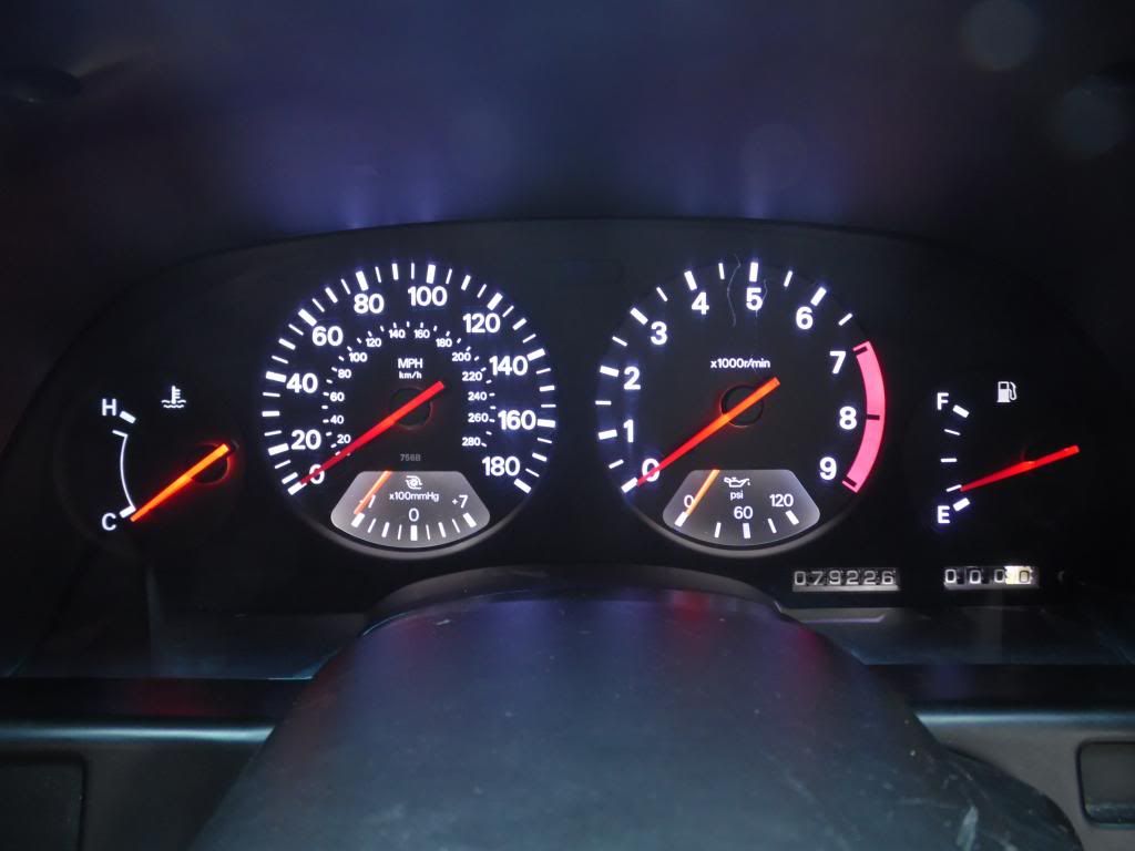

I used LED strips in my dash cluster and the effect looks like this:
That looks really good!
Do you have an eBay link for the ones you used mondo
I think it was these, but it's been a couple of years since I bought them so...
