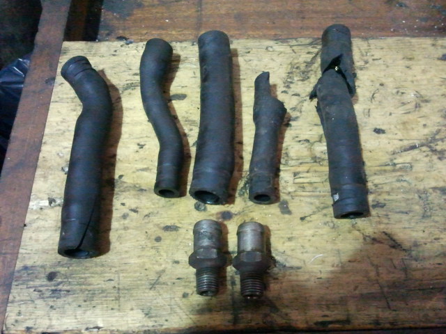

  12. i had a rough running problem at low revs and idle and cured it by pulling the iridium plugs out and putting stock plugs in! (a lot of folks will tell you iridium ones are better, but can only speak from my own experience).It cured it straightaway, as the iridium plugs are around 2.5mm shorter than the standard zed plug.I was advised to change the iridium ones on the advice of a number of people including Jeff and Jamie at Zedworld. i have also noticed a big improvement at idle since replacing the pcv valves and all 5 pcv hoses with brand new ones.As daft as it may sound the engine is also quieter to the point where the difference is quite noticeable. Standard on the left, and iridium on right.

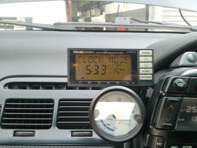

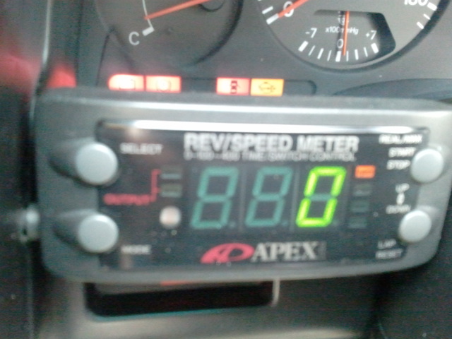

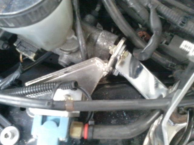

  15. Got round to fitting my brake servo stopper, apexi rev/speed meter, Jecs visualpower meter and brand new pcv valves and all 5 hoses and made a custom bracket for my boost solenoid.Cant believe how much smoother the engine is with the new pcvs and hoses fitted, seems so much smoother on idle etc :)
